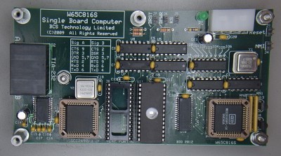

 Post subject: POC V1.1 Update
PostPosted: Tue Apr 16, 2013 8:06 am
Posts: 8505
POC V1.1 continues to sit on my desk, executing WAIs and such and being a good boy. Current uptime is more than 130 days. Sure wish Microsoft Windows was this stable. :lol:
POC V1.1 embodies just about all of the circuitry of POC V1.0, including hardware patches applied to fix the address bus woes mentioned many pages back. I devised an improved address bus qualification circuit and a different method of generating separate /RD and /WD signals from the MPU's RWB output, /RD and /WD being required by the I/O silicon. There are also circuits to expose more I/O addresses for SCSI operation (three of them).
Attached are some pictures of what the unit currently looks like:
The above is POC V1.1 minus the SCSI host adapter. Its physical layout is almost identical to V1.0, except for the use of an SOIC package for the MAX-238 transceiver (left end of unit) and repositioning of the NMI and RESET inputs to the right end of the board. The TO-92 packages to the immediate right of the 65C816 are Dallas (Maxim) 1813 reset generators. One is attached to /RESET and the other to /NMI, the latter available so when I commit a bone-headed coding goof and make the MPU start chasing its tail I can recover control (most of the time). The DS-1813 is perfect as a slow push button debouncer. I can use almost anything to short out the NMI jumper block—usually a paper clip—and not get multiple NMIs. Ditto for the RESET block.
The above picture is POC V1.1 with the DMA-capable SCSI host adapter installed. When I figured out how to use the 'C94's DMA channel, I had to rework the host adapter circuit so DMA status could appear on the data bus when the 65C816 read that part of the I/O block. The chip at the bottom of the host adapter PCB is a 74ABT541 bus driver whose sole purpose is to bring D7 high when the MPU queries the 'C94 and the latter says it is ready for a DMA transaction (the "ready" status is easily tested with a BIT instruction). I used the 74ABT541 because I happened to have one in the "slightly used" parts bin. This is clearly a gross waste of silicon, but the circuit works quite well—a transfer of 64 blocks (32 KB) from disk occurs at the rate of about 500KB per second. Even single block transfers are very fast: the activity LED on the disk barely flashes during the transfer, it's that quick.
The above picture is a side-view of the unit, which shows how the host adapter makes its connections to the mainboard. You can also see a patch on the underside of the mainboard, which I'll explain below. This is an example of taking the MPU's buses off-board, which increases loading and thus restricts the maximum Ø2 clock rate to 10 MHz (there are no bus drivers). With the host adapter unplugged and the Dallas watchdog moved to the "expansion port" socket on the mainboard, the unit is rock-solid at 12.5 MHz and mostly-operable at 15 MHz.
The above picture is of the patch I made to enable SCSI quasi-DMA operation. Less than a week after I had reworked POC V1.0 into V1.1, I experienced a "eureka" moment and figured out how to use the 'C94's DMA channel by making the MPU pretend to be a DMA controller. There were two steps involving hardware to get this to work: a redesign of the host adapter so a DMA status output from the 'C94 (DMAREQ, which goes high when the device is ready for a DMA transaction) could be checked by the MPU, and extending another I/O output from the 74AC138 decoder to the host adapter to control the bus driver that provides that signal to the data bus. Unfortunately, I had already had PCBs made, had populated the first one and had determined that everything was working as it should. So even after building V1.1, I *still* had to apply blue wire to rig up the DMA polling circuit. :shock:
The next step is to figure out how to hook up my newly-acquired SeCons µVGA console device and switch over from a dumb terminal (a WYSE 60, which is nearly 20 years old) to a standard PS/2 keyboard and video monitor (I have an older Viewsonic 17 inch model that is gathering dust in the computer graveyard). The hardware hookup is not particularly difficult, as the µVGA module is small and uses TTL-level TIA-232 for communication at speeds up to 1.25 Mbps (really!). Data going to the screen is written to the module's RxD input and data coming from the keyboard is read off the module's TxD output. There are also handshaking lines, which are probably going to be required to achieve error-free performance at high transfer rates.
As part of this experiment, I will be using a 26C92 DUART in place of the 2692A, as the former can support a maximum speed of 230.4 Kbps (the 2692A maxes out at 115.2 Kbps). Also, the 26C92 has a deeper set of FIFOs, so interrupt servicing won't be as critical as it might otherwise seem. Now, running the interface at 230.4 Kbps may be somewhat ambitious, as CBAT at that speed means that the '816 will theoretically get hammered with about 46,000 IRQs per second. However, I can't type quite that fast, so the input side won't be suffering much. Some cycle counting suggests that assuming a full transmit buffer, the unit could reach at least 18,000-20,000 bytes per second on the output side. I'm guessing that the µVGA module can't sustain that transfer rate and will invoke flow control to avoid a buffer overrun. The 26C92 does flow control in hardware, and as experience in driving the much slower WYSE 60 has shown, is very trustworthy. I'm not really expecting much trouble with getting the hardware interface to the µVGA module (famous last words).

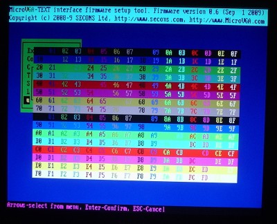

 Post subject: Re: POC Computer
PostPosted: Wed Apr 24, 2013 4:58 am
Posts: 8505
clockpulse wrote:
All-in-all, the MicroVGA seems to be a flexible display unit that ought to work. We'll soon know.
It does look good, it will be interesting to hear how it works out.
I've been notified that the MicroVGA has shipped, so I hope to see it soon...
I finally had some time to try out this thing. Attached are some pictures I took of the display and the module itself.
File comment: SECONS µVGA Module
File comment: SECONS µVGA Module Setup Screen
File comment: SECONS µVGA Module Code Page 437 Character Set
File comment: SECONS µVGA Module Color Set
As you can see, it does generate a display, at least with an older (c. 2006) Viewsonic 17 inch video monitor. It would not sync the display with the Viewsonic 22 inch 16x9 LED monitor on our test bench, a monitor that is only about a year old—the display kept flickering. I didn't bother to try it with the 24 inch Viewsonic monitor on my desk, figuring it would have the same problem.
The display is reasonably sharp on the 17 inch monitor, which reports that the vertical sync frequency is 60.07 Hz and the resolution is 800x600. The keyboard functions okay, with the exception that I can't turn on NUMLOCK. There is no mention of any software command that can turn on NUMLOCK, so I don't know at this time if the numeric keypad will emit numerals.
If you carefully examine the first picture, you will note that the mini-DIN keyboard jack is too close to the DB-15 VGA jack, causing the keyboard and monitor plugs to interfere with each other. Didn't these guys check for this when they laid out the PCB? I sent them some E-mail asking them to contact me about this interference matter, as well as the other items I mentioned.
Next step will be to adapt it to POC V1.
PostPosted: Wed Apr 24, 2013 5:30 pm
Posts: 87
Location: San Diego
Images look good. Maybe something is going on with the horizontal sync.
