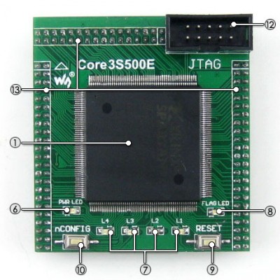

I also would like to point you to ths $27.99 XC3S250E board:
and its larger XC3S500E brother $32.99:
Both are on EBay and directly available from Waveshare (a little hard to deal with...)

Suppose if someone got one of those boards with a JTAG connector, do we have any good suggestions for a cheap programming cable ? The original Xilinx USB JTAG adapter is quite expensive. My first programming I did with a parallel port cable that was really cheap, but nowadays parallel printer ports are rare.
PostPosted: Thu Dec 06, 2012 8:36 am
Posts: 899
Arlet - search EBay for 'xilinx usb' - there are many under $50 cables there.
