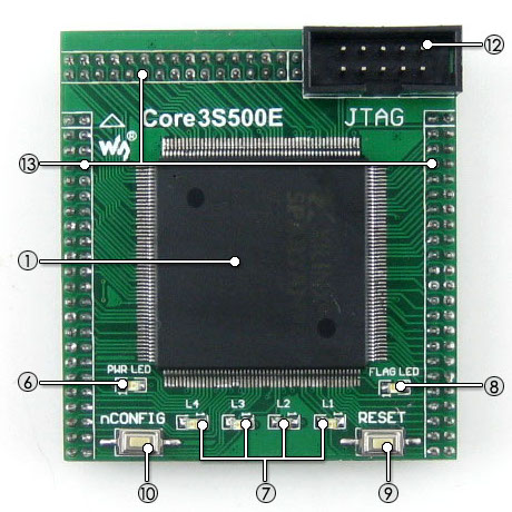

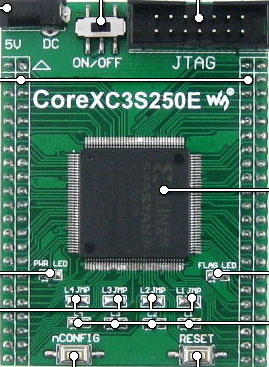

I also would like to point you to ths $27.99 XC3S250E board:
and its larger XC3S500E brother $32.99:
Both are on EBay and directly available from Waveshare (a little hard to deal with...)

Suppose if someone got one of those boards with a JTAG connector, do we have any good suggestions for a cheap programming cable ? The original Xilinx USB JTAG adapter is quite expensive. My first programming I did with a parallel port cable that was really cheap, but nowadays parallel printer ports are rare.
PostPosted: Thu Dec 06, 2012 8:36 am
Posts: 904
Arlet - search EBay for 'xilinx usb' - there are many under $50 cables there.
PostPosted: Thu Dec 06, 2012 8:41 am
How big is the file, and what type? Can the cable and programmer be made easily enough? I program microcontrollers with my workbench computer and it is not dependent on the PC's ports or OS etc..
