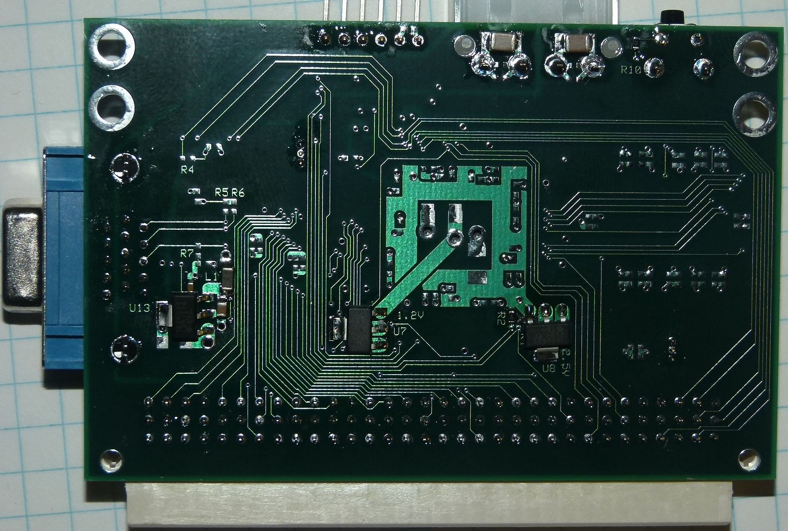

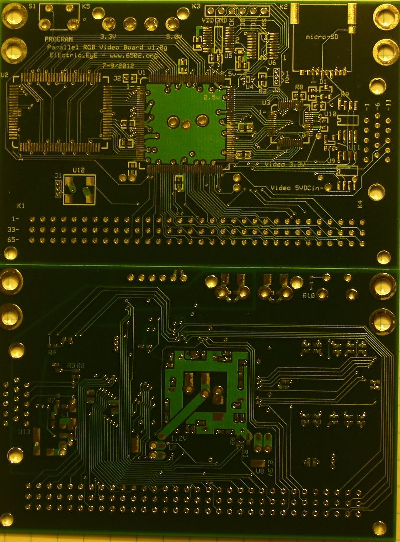

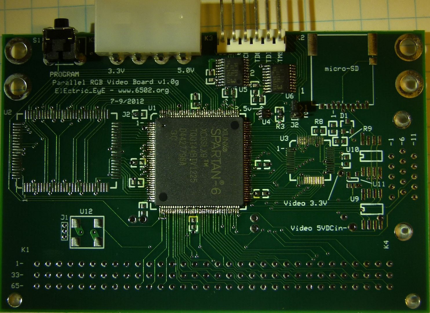

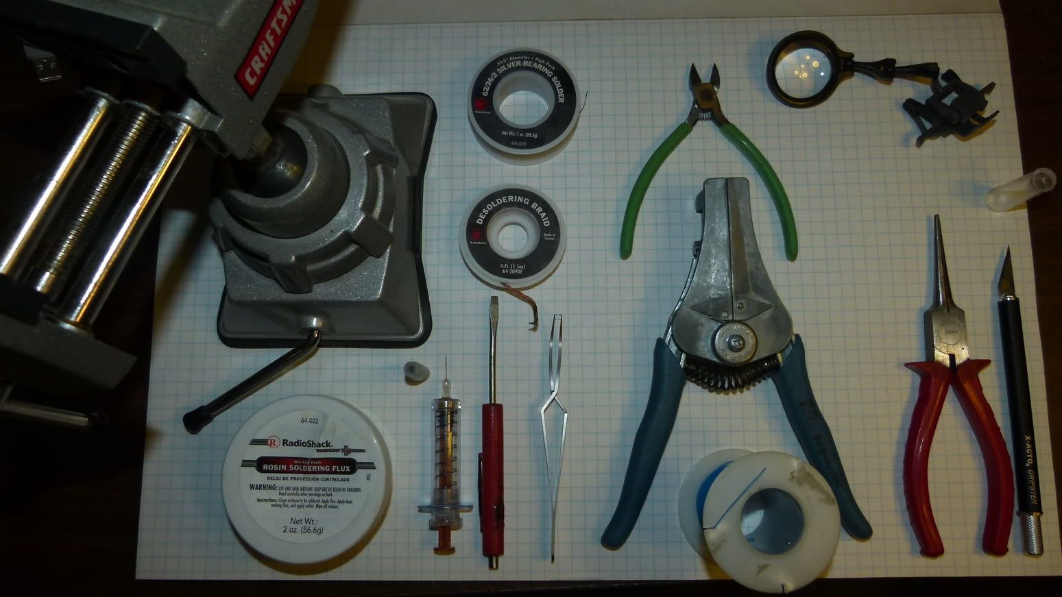

Tools I use: Multi-Axis Vice (for holding board in place), .015" silver bearing solder, fine tip wire cutter(for corrections), clip on magnifier, desoldering braid(suggested by others, but not used here), wirewrap insulation strip tool (for corrections), fine tip long needle nose pliers (for placing corrections), X-Acto knife (for corrections), flux, needle containing flux, flat tip screwdriver (IC final placement & holdown), tweezers (for general small part placement),
Bare boards. Start time is 9am. I will solder in the Spartan 6, power connector, JTAG connector and associated resistors, FPGA Proms, the MUX for FPGA program stream w/pull-up resistor and jumper, and finally 1.2V/2.5V VRegulators for FPGA.
EDIT (9/19/2012): 1st pic updated. Description updated.

PostPosted: Tue Sep 18, 2012 2:57 pm
Took a little more than 1hr... U4 and the 0603 SMT resistors were the most challenging, the pads must be made larger for U4 in v1.0h. The Spartan 6 was actually the easiest to do. I'm going to go without soldering in the bypass capacitors for as long as possible. Now it's time to rewire a female power adapter for 3.3V & 5V to match the above male connector. Then I power it up and hopefully ISE will see the 2 PROMs and the S6 :!:

ElEctric_EyE wrote:
Tools I use: Vice for holding board in place, .015" solder, clip on magnifier, flux, finest tip soldering pencil, tweezers for general placement, flat tip screwdriver for final placement and hold down, needle containing flux.
Something I don't see in your "arsenal" is solder wick (aka braid). You can use it to clean up the soldering on the Spartan 6 and give it that factory look. I use it to clean up after soldering fine pitch stuff so as to guarantee that no microscopic bridges exist.
PostPosted: Tue Sep 18, 2012 5:02 pm
I use Multicore Crystal 511 solder wire. It has mildly activated flux, and has good wetting capabilities. I like it better than standard rosin flux. I agree with BDD about the braid.
A useful trick is to place the part, apply some flux to the pins, and take a piece of solder braid and fill the tip with solder. Then put the braid on the PCB, and use the iron to push it against the tips of the pins. When done correctly, a small amount of solder will wick from the braid to the pin/pad, and make a nice clean joint. It's really easy and quick.

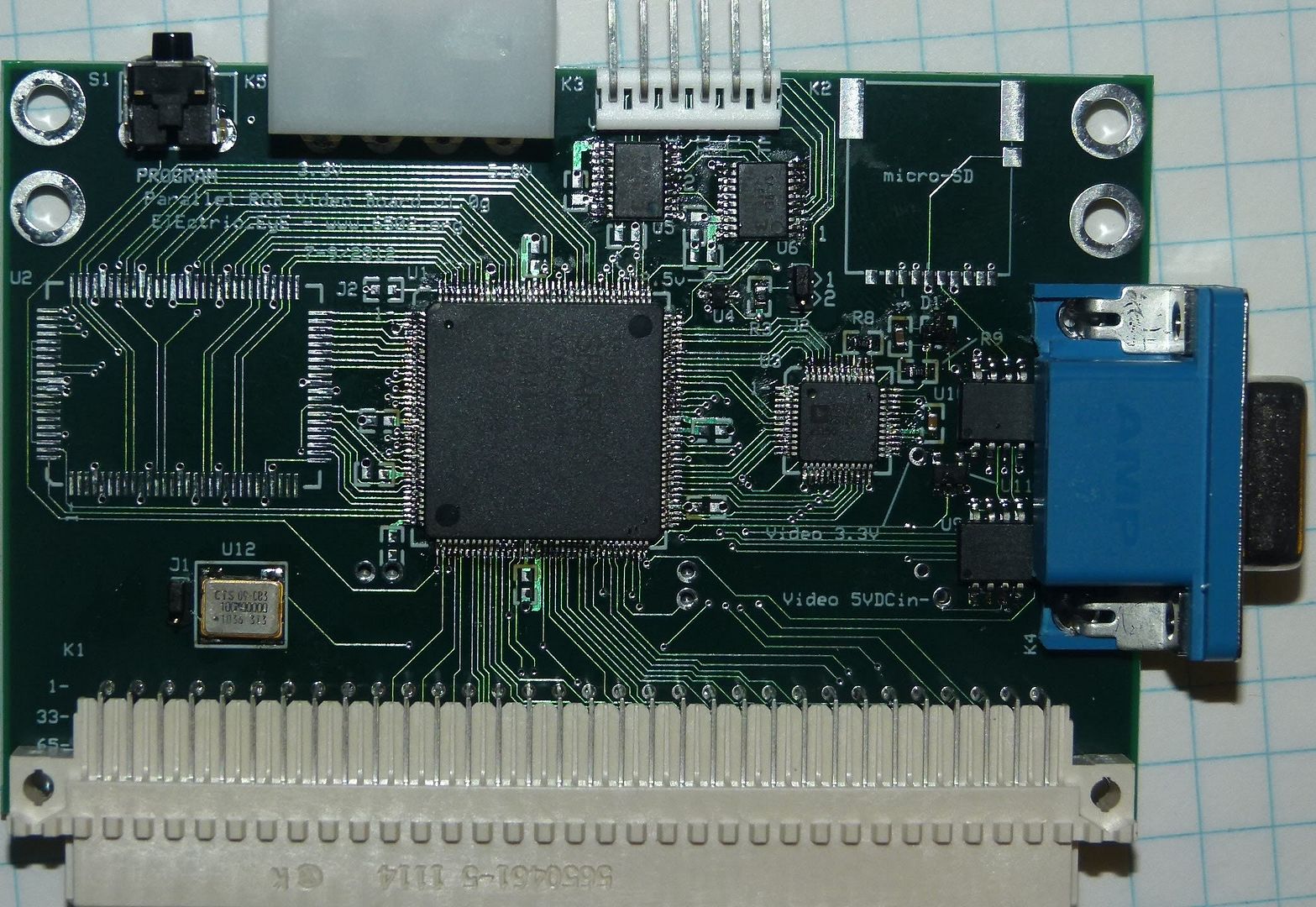

PostPosted: Tue Sep 18, 2012 6:01 pm
Gentlemen, thanks for the tips!
I am done construction for today. As I mentioned before, there was a space conflict in this design involving the serial FLASH ICs and the VGA connector. I had to solder in the FLASHs first and grind some material off the bottom part of the VGA connector, or I wouldn't have been able to mount them after the VGA connector was mounted... Anyway, all seems good so far. It still powers up and no behavior has changed for the worse.
I must give my frayed nerves a rest. I was actually shaking pretty bad during assembly :lol:, but I managed. Breathing is key.
I used the camera flash for these pics. The pictures are abit deceiving as it appears some of the remaining flux is reflective and appears to look like solder.

PostPosted: Wed Sep 19, 2012 12:24 pm
Today I was trying to generate HSYNC and VSYNC signals, but no activity from the FPGA. I saw activity coming from both PROMs when the Program button was pushed, but no activity out of the MUX (U4). Then I realized I have the output (pin4) and select (pin6) lines switched. When I disconnected the jumper which pulls the output (should be select) high or low thru a 4.7K resistor, I still see no activity which sort of bothers me. I can fix this mistake relatively easily, although I think I will purchase an X-Acto knife today before I do this.
PostPosted: Wed Sep 19, 2012 3:58 pm
Got the knife, made the corrections and I see signs of life! The VGA monitor light turns green recognizing the HSYNC and VSYNC signals, and the 25MHz pixelclock is coming out of the FPGA.
Version 1.0h is up to date. I was actually making other modifications to the layout as I was assembling this board. Time for some code on the Implementation thread.
EDIT: I will update the tools pic at the top of this page. I don't wish to intimidate, but also people make mistakes, and there are tools I used to correct mistakes, plus that original pic is pretty bad...
