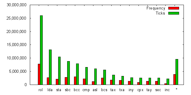

Yep. Here is the profile of the 6502 code:
The 6800 and just about any other 8-bit processor without a hard div or mult would look the same. ROL dominates and many of the top 15 are used for division routines. The 6800 with its dual accumulators helped with optimization. (Notice the lack of BNE? Lots of unrolling :-).
