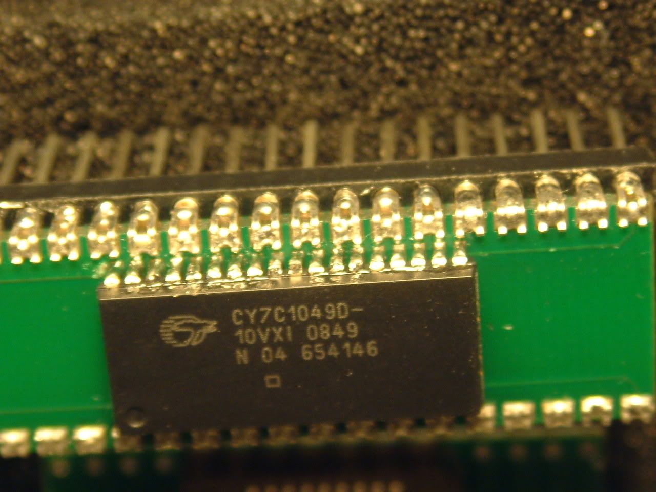

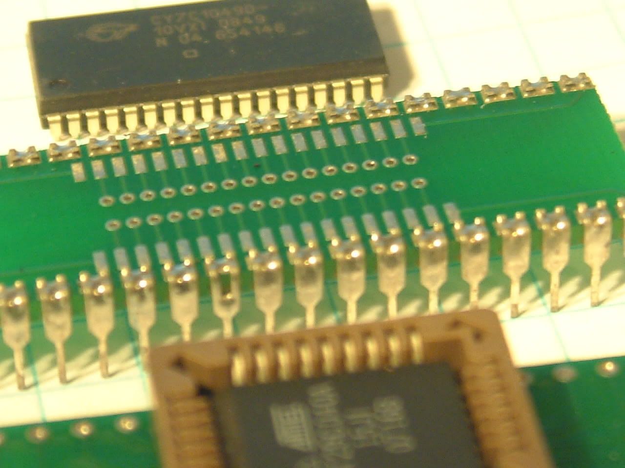

My last post with a pic soldering a 28 pin SOJ to a 300 mil DIP is easy compared to what I need to solder next; a 36 pin SOJ to 36 pin 600 mil DIP...
Here's a pic after my first attempt:
Using the 36-pin SOJ 512Kx8 10ns SRAM above and the flimsy pin adapter in the middle:
I broke a pin off the adapter, so I wound up soldering the adapter to the WW socket (look closely at the first pic)... It's why I call it my first attempt. Next attempt I place the adapter into the WW socket first, then solder the part.

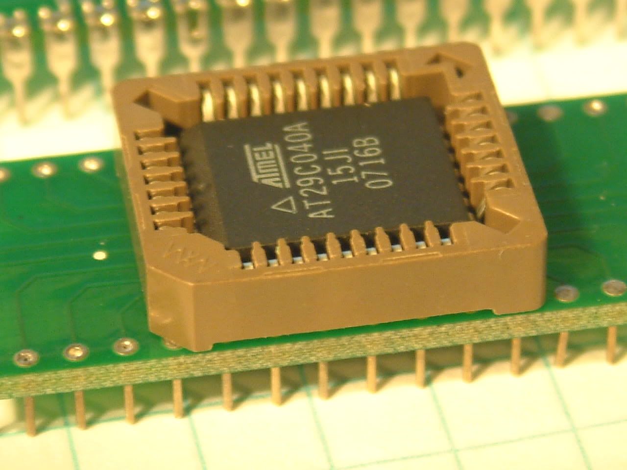

It's not machine tooled like this finely crafted 512Kx8 EEPROM 32-pin PLCC previous socket:
, but there aren't alot of choices out there for 36-pin SOJ to DIP. I used .032 solder which got in the way of the socket pins and the IC, raised my blood pressure quite abit after the first few pins. I would highly recommend thinner rosin core solder. Let gravity and heat do the job, without fear of heat destroying the part as alot of pro's have said here.

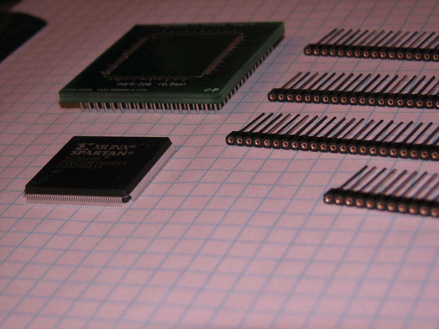

Yesterday I received 2 XC3S400-208PQFP's. .5mm 208 pin PQFP. There is no way to solder this thing! Today I received the 208 pin PQFP to PGA adapter, and in the pic you can see the WW headers, and my intentions...
I did notice the IC is just a bit "springy" when put onto a flat surface. And the pads on the adapter seem to have just the slightest bit of solder. So I guess the idea would be to clamp the IC onto the pads and heat it all up until the solder flows? I do have a mini-torch...
If anyone has experience in this type of intricate work, I'd like to know the details. The socket was $78, the IC was $25. I'm thinking of using a C-clamp and a minitorch without adding solder....

Instead of trying mechanical means, I might skip the clamp, put the board on a pan or thick piece of sheet metal on hot plate and bring it up to a little below the melting point of the solder, and use a heat lamp to finish it up. Do not use a torch! If you need more solder, get a solder paste syringe from Chip Quick (I think Digi-key carries it) and first apply it to the pads before adding the IC and heating it up. With the right amount of solder paste, it should pull into the pads and not leave any solder where it shouldn't be.
Position the chip, then heat up your iron, and apply solder (and flux) liberally. Don't worry about bridging pins. Then, once all the pins are soldered down, take your solder wick and it will suck the excess and bridges away (Without removing the actual bonding solder - solder binds more tightly to tin legs & PCB than solder wick)

Daryl, the youtube video was very informative. I watched it a couple of times, and headed out this morning to get paste flux, and solder wick (braid as radio shack calls it). It was a sinch. Much, much easier than I thought. I didn't have to add solder, there was enough on the adapter. I had to use the wick once when the solder built up on the tip and bridged 2 pins. Took me less than 5 min's total. The hardest part is precisely lining up the pins, on all four sides, to the adapter.
I was intimidated because I had tried a couple weeks ago to solder a 44 pin QFP (no where near the fine pitch of this 208 pin QFP) without using flux, just rosin core solder, and it was bridging pins like mad, and looked sloppy. I was using a solder sucker to unbridge the solder. I went back over it today after adding some flux, and it cleaned it right up...
Owen, you said it, a liberal amount of flux is mandatory for success... I wish I could take better close up pictures.
Garth, I can't believe I was thinking about using a torch, (it was a small mini butane torch though, still...)
