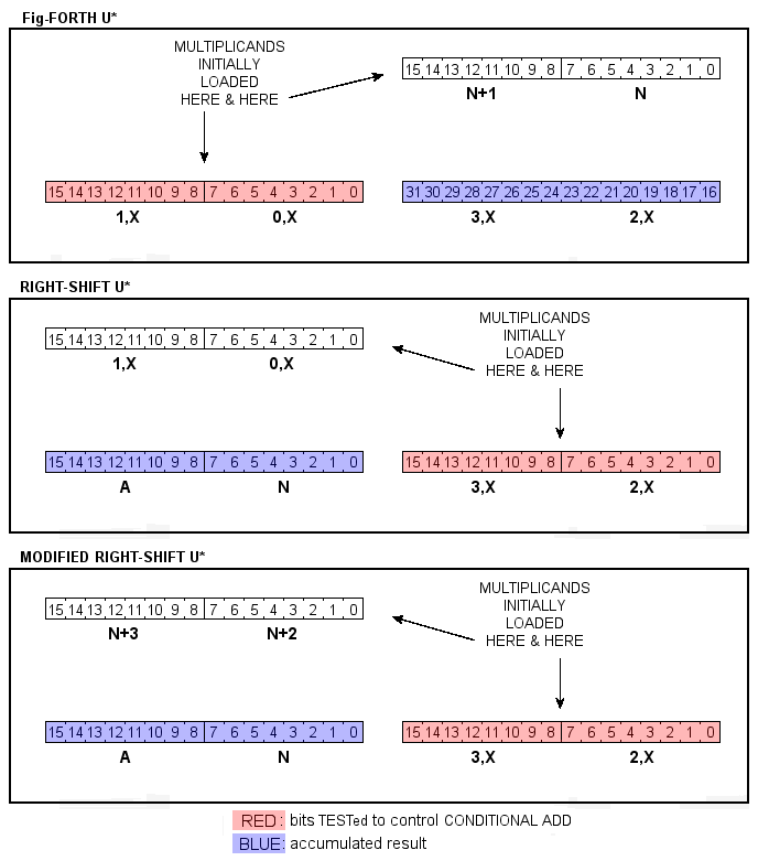

I wanted to follow up on this topic, and opted for a picture rather than 1,000 words. Or would that be 1024 words..?? :D Anyway, for clarity (and as a tutorial in case anyone's not 100% up to speed) here's an animation of the three multiplication routines mentioned earlier in this thread:.
All three routines operate by testing one bit at a time and, if the bit is a 1, performing an addition. The values involved are:
  • 16-bit Multiplicand "a" (the one that remains static)
  • 16-bit Multiplicand "b" (the one that gets shifted and tested)
  • the 32-bit result -- the Product
I have labelled the locations (eg: 0,X; eg: A) where the six bytes of data are held. For example: Garth posted the FIG multiply routine -- and the animation's upper panel is your visual reference when reading that piece of code. Likewise the animation's middle panel illustrates the Right-shifting algorithm dclxvi posted (the basic version), and the bottom panel hopefully clarifies my "Modified Right-shift" approach.
(So, if there are two 16-bit and one 32-bit values involved, why do the diagrams show 6 bytes of storage rather than 8? Folks familiar with this sort of code will recognize an ubiquitous optimization. The 32-bit result begins as a 16-bit result, gradually expanding as the routine executes. At the same time the bit-tested multiplicand shrinks -- it can gradually be discarded -- as the routine executes. The upshot is that a 16-bit portion of these two values can cohabitate in the same storage! This boosts speed. Both values can be shifted at once, and they still maintain their individual functions. BTW if you find all this shifting bewildering, it'll help to think of how the columns need to be skewed when you do multiplication with a pencil and paper. 'Nuff said -- please refer to the code!)

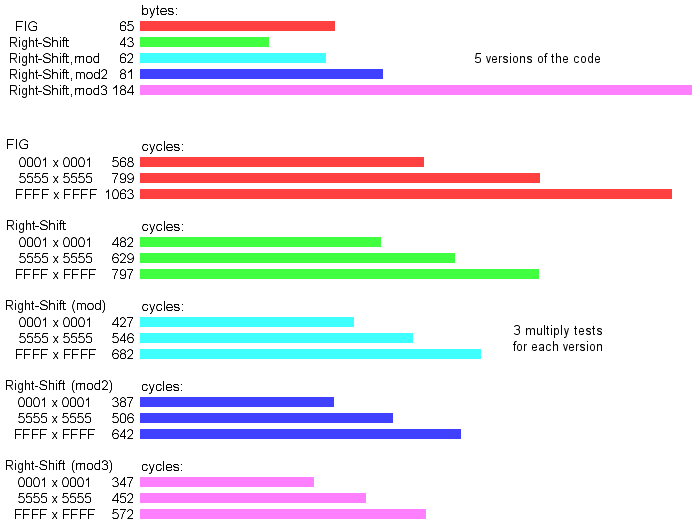

The other day I ran these routines on actual 65xx hardware, bracketed with code snippets to read a 6522 timer and derive the execution times. The graph below presents these figures; also the memory requirements. Not surprisingly, there's a clear tradeoff between memory usage and execution speed. The graph lists five versions of Forth's U* (unsigned multiply):
  • the FIG code Garth posted (bug-fix included)
  • the Right-Shift version dclxvi posted
  • the modified Right-Shift version I posted
  • another modified Right-Shift version (not posted) with the inner loop partially unrolled (2 bits at a time, 4 iterations)
  • another modified Right-Shift version (not posted) with no inner loop (inline code for all 8 bits)
Each code version has its execution time listed for three multiplication tests: 1 times 1, 5555h times 5555h, and FFFFh times FFFFh. Regarding execution time, all versions except FIG respond to the number of ones in multiplicand "b," and multiplicand "a" is irrelevant. The Right-Shift version takes 21~ extra for each additional one, and the modified Right-Shift versions takes 17~ extra (15~ extra for the fully-unrolled version, which uses Y in place of N+1). The FIG version takes 33~ extra for each additional one and (by inspecting the code) seems to also delay nonlinearly according to the value of multiplicand "a"; this is due to the potential carry that may or may not occur, propagating "backwards" into bits that've already been shifted.
Your choice of the "best" routine will vary, of course, depending on how much of a premium you place on speed (versus memory consumption). The basic Right-Shift version is compact and succinct, whereas the fully-unrolled modified Right-Shift is plainly at the point of diminishing returns (burning memory to scrounge every possible cycle, I mean). It's not a criticism; in certain circumstances profligate memory usage is perfectly justifiable. The next step of course would be to adopt a Lookup Table approach: Garth explores this powerful concept here.

When you list memory usage, you're counting the size of the actual routine, not the working set of the problem, correct?

if we take an 8-way branch on three bits [...] For 16-bit routines, we'd normally have an average of 8 additions, and we get that down to 6. Is that going to cover the overhead and make it worthwhile?
Either there's a minor slip-up here or else I misunderstand your drift. Is it Radix 8 you were assuming? Although 6 out of 8 possible bit-patterns result in an operation (ie, an add or subtract), you mustn't suppose all patterns are equally probable. If we test the numbers 0 to FFFFh for pattern matching we see...
  • 557,056 operations result using Radix 4, where 2 out of 4 patterns operate
  • 425,984 operations result using Radix 8, where 6 out of 8 patterns operate
  • 335,872 operations result using Radix 16 where 14 out of 16 patterns operate
  • 278,528 operations result using Radix 32 where 30 out of 32 patterns operate
The explanation mostly has to do with the fact that Radix 32 (for example) shifts the number 4 bits at a time (compared to 3, 2, or 1 bit at a time), but there's more to it than that. BTW the Wikipedia article is flawed in that it scarcely even mentions radix -- you're out of luck unless you spot the external links.
For a while I was playing with a radix 32 scheme, but the cost in (zero-page) ram was gonna be pretty high, and that's much less acceptable than simply burning up a bunch of EPROM space.
