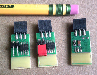

Similarly, it makes sense to standardize on an I²C connector, again to make it easier to share hardware.  What I am proposing here is what Daryl already offers on his SBC-4 board, and he also offers a matching serial EEPROM module, $6 each with a 64Kx8 EERPOM and the socket.  Here's an earlier half-postage-stamp-sized EEPROM modules shown here with only four pins:
(Actually, the pins are on the computer board, and the socket is on the module.)  The 4-position socket on the end has Pin1=data, Pin2=Vcc, Pin3=ground, and Pin4=clock, and Daryl and I agreed that all future I²C plugs and modules should use a 6-pin, with Pin5=IRQ\ for things like a keypad controller, RTC with alarms, etc., and one hole (position #6) blocked and Pin 6 cut off so you cannot plug the I²C device in upside down.  The I²C interface method pretty much excludes the need for a RST\.  My older four-pin ones will plug into the 6-pin header as long as I'm careful to put it on correctly, ie, right-side-up and leaving the IRQ\ pin exposed on the right end.  Note: "IRQ\" does not necessarily mean it connects directly to your 6502/816's IRQ\ pin.  One user asked if it would be ok to connect it to a VIA's CB1 pin.  The answer is "Sure, just put a pull-up resistor on it."  IRQ\ is common nomenclature (is that the right word?) for this kind of thing.
Edit, 7/28/22:  I now have an I2C-6 EEPROM module is on the front page of my site, and there's a link to the data sheet there.  I got hundreds of boards made, although my initial order of 24c256 EEPROMs was only for 25.  I'll get more when needed.
Here is the pinout, looking toward the master, into the edge of its board:

The pins could also be vertical if desired.  Even with the keying, it would be good to mark pin 1 since it's not as clear with vertical pins.  An example marking would be to put a dot or numeral "1" next to pin 1 in the silkscreened legend, or mark it with a marker.
I²C allows multi-master setups but I expect they're rare.  A connecting cable could be made.  Extension cables can be made for devices that may be too heavy to plug directly into the side of the controller board and be safely supported by the pins.  "Y" adapters can also be made for connecting multiple devices to a single port which of course the I²C standard also allows, as long as no more than one device responds to any given address.  Modules can optionally be made with the socket on one end to plug into the controller and a pin header on the back to daisychain another device.
I initially thought of putting "65" in the name again, something like "65I2C", just to credit our forum and website, but Daryl thought it would be too confusing (and I agreed), looking like "sixty-five-twelve-see," and could cause problems with searches even if we don't care how anyone actually pronounces it since we talk in text.  He suggested "I2C-6" which sounds good to me.
I2CChip.com in Auckland, New Zealand (whose website has a load of good info on I²C) wanted to standardize on the 6-pin version of this subminiature connector shown here in 8-pin:
but it will not go into standard perfboard with holes on .100" centers.  Totally by coincidence as far as I can remember, the pinout is the same as what's above.  What is not a coincidence at all is that ours is intended to be easily breadboardable (on perfboard, not solderless breadboards).
