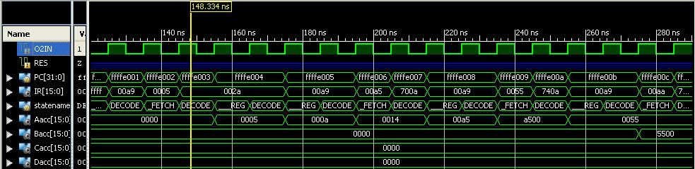

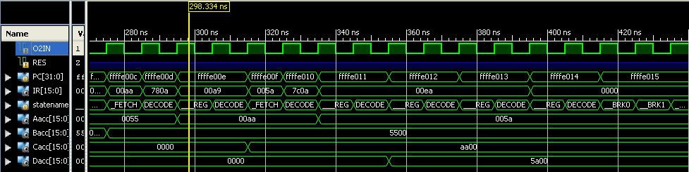

More 'transposing <shift,rotate> opcodes' successful testing:
START             LDA #$05
                  ROL A
                  ROL A
                  LDA #$A5      ;ASLx8 shiftAop, store in A Acc
                  .BYTE $700A
                  LDA #$55      ;ASLx8 shiftAop, store in B Acc
                  .BYTE $740A
                  LDA #$AA      ;ASLx8 shiftAop, store in C Acc
                  .BYTE $780A
                  LDA #$5A      ;ASLx8 shiftAop, store in D Acc
                  .BYTE $7C0A
                  NOP
                  NOP
                  NOP
Need to observe the carry next...

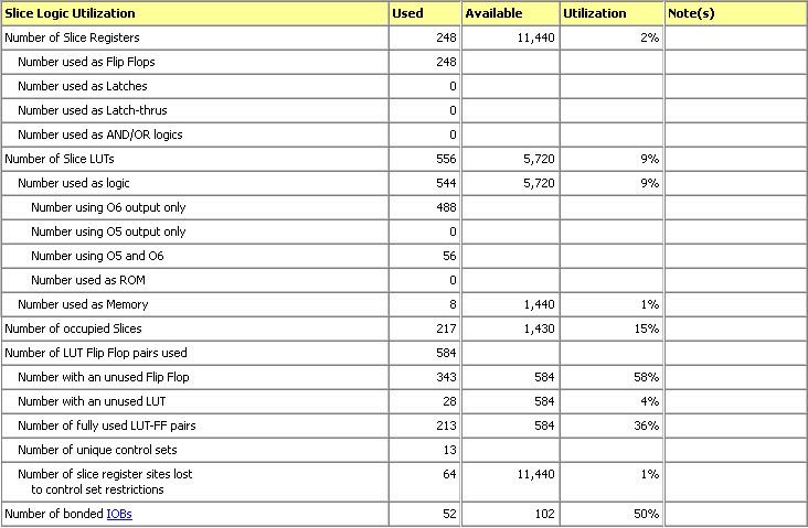

PostPosted: Sat Mar 10, 2012 2:00 pm
Excellent explanation!
I think I am done adding to the .b core. I am very pleased with the speed of it at around 95MHz, and adding multipliers would surely slow it down. Perhaps when I'll have real need for multipliers, maybe in the Digital Sound Synthesis board, I'll try tackling a .c core. I would like to use the .b core as it is now and start using it on the DevBoard! For anyone interested in the Verilog code, I'll post an update to Github today. I think I'll spend a majority of my day off next Tuesday writing up a synopsis of all the new opcodes and their values, which I will also make available.

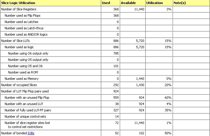

For comparison's sake, here is the utilization of the 144-pin Spartan6 XC6LX9 with the .b core at its first stage with BCD and D flag removed versus the latest .b core on the bottom. For as much that was added, not much more has been used.
