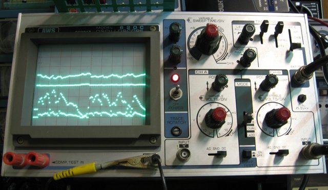

I used my workbench computer last week to imitate a 4-input, 4-trace DSO with one of my cheap 20MHz dual-trace triggered analog oscilloscopes. Note that only one input is used (which comes from the workbench computer's D/A output) and the external trigger input is used (which the workbench computer gives a pulse to to start each trace). I probably should have sampled faster to get that third trace looking smoother, but it did the job. The workbench computer sampled four inputs and stored the samples in memory, then plays them back repeatedly for the analog 'scope to display.

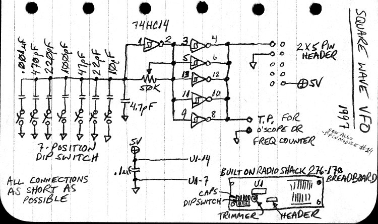

A VFO (variable-frequency oscillator) I breadboarded (on a solder-type breadboard, not a solderless one) to slowly turn the 5V logic clock frequency up on my workbench computer to see how fast it would go is as follows (this is from my tiny ring binder that holds all the hardware documentation on my workbench computer and related projects):
Another topic dealing with 5V oscillators is at viewtopic.php?t=1576 . It has more good links in it too, and my VFO shown there is a later, faster one.

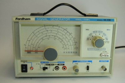

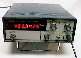

I have a Fordham SG-490 (a re-badged B&K Precision 2005B) RF signal generator, but opting for the 74HC digital VFO was easy because the SG-490 only puts out a sine wave (with some distortion); and I also have a Heathkit IM2420 frequency counter good to over 1/2 a GHz, with 8 digits and several really nice features. I have a sweep function generator but it only goes up to 2MHz.

I have a Fordham SG-490 (a re-badged B&K Precision 2005B)...also have a Heathkit IM2420 frequency counter...
