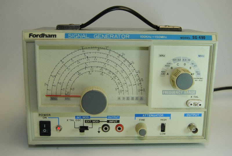

I have a Fordham SG-490 (a re-badged B&K Precision 2005B) RF signal generator, but opting for the 74HC digital VFO was easy because the SG-490 only puts out a sine wave (with some distortion); and I also have a Heathkit IM2420 frequency counter good to over 1/2 a GHz, with 8 digits and several really nice features. I have a sweep function generator but it only goes up to 2MHz.

I have a Fordham SG-490 (a re-badged B&K Precision 2005B)...also have a Heathkit IM2420 frequency counter...
It's good to see vintage test equipment still on the job. The old stuff may not be as fancy as the new stuff, but most of the old stuff was high quality in every respect, which is why it continues to function after all these years.
