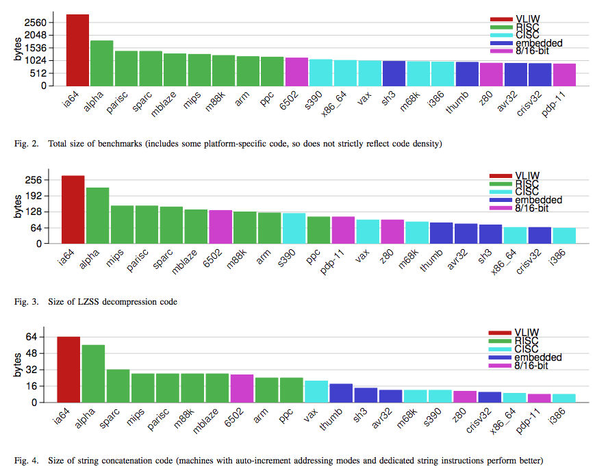

I had a look to the Samuel tables. It is strange to see (first table) that z80 performs as the 6502 does (in letterature 6502 is claimed to be more efficient). Anyway, let's consider 0.02DMIPS/Mhz.
Giving that I tried to figure-out a different parameter considering also the gate count. In fact, gate count is fundamental for fpga user. I defined the DMIPS/Kates i.s.o. DMIPS/Mhz. From internet I found: arm7tdmi = 48kgates; 0.74DMIPS/Mhz in thumb mode (I'm interested in code density). For the 6502 I toke 3.5kgates (still from internet) and 0.02DMIPS/Mhz.
With this number we get: 0.015DMIPS/Kgates for the arm7; 0.006DMIPS/kgates for the 6502. I think that this figures represent better the architecture efficiency when the gate count is important. Giving these numbers the ratio between 6502 and arm7 is about 1:35 considering the DMIPS/Mhz and it decreases to 1:3 consideirng the DMIPS/kgates. No bad considering that arm7 can manipulate data in 32bit mode!
So, I thinks this a more fair way to compare the cores in order to find out a compromise between efficiency and gate count. May be having a 32 bit 6502 this gap could be even reduced.
I hope it make sense.
I'm still looking for code density statistics for 6502 but I didn't find nothing on internet at the moment.
 Post subject:
PostPosted: Sun Aug 14, 2011 2:14 pm
This topic is now the top hit for 6502 code density, so: search for a pdf titled "Code Density Concerns for New Architectures" and you should find a diagram like this:
File comment: From http://web.eece.maine.edu/~vweaver/papers/iccd09/iccd09_density.pdf
(There are more breakdowns for different elements of the benchmark - all the sources are here and there are comments on the architectures here)
(Fair use exception to copyright, of course. Credit to the authors: Vincent M. Weaver and Sally A. McKee)
Edit: replaced lost image with new screenshot
