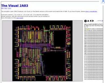

As you may have spotted, we do now have a visual6800, and we hope to have a visual4004 next. The visual2A03 may yet come, but I'm not sure how it stands in priority compared to say the z80 or the rca1802. But, capturing the polygons is the hardest part, so if you can rustle those up, we can do the rest!
 Post subject: Visual2A03 by Quietust
PostPosted: Fri Jun 24, 2011 4:05 pm
cpow wrote:
I'm hoping someday we'll have a Visual2A03. =]
As of very recently, "Quietust" has published just such a thing! He's still ironing out some digitisation bugs.
