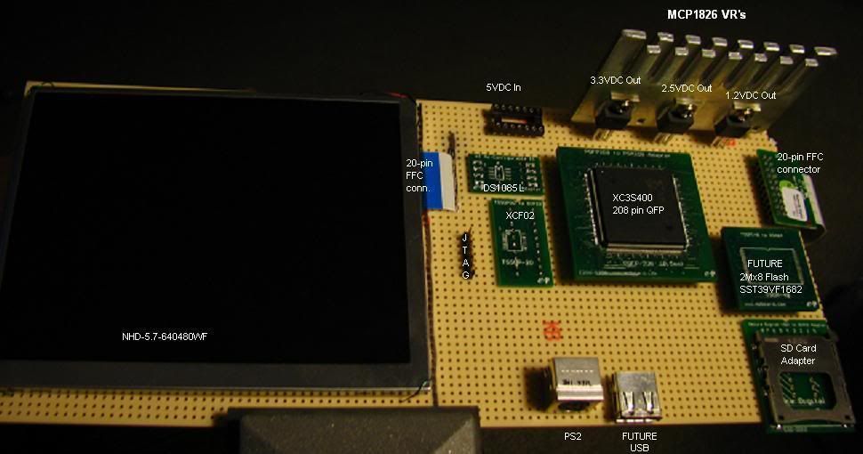

I think it's time to arrange the board...
I can see already my simple block diagram, may become even simpler. Fitting an entire 64K of RAM for the 6502 core, inside the Spartan 3, must be possible...No need for the external 10ns SRAM, no need for the external 512Kx8 EEPROM. But I think, in addition to the SD Card, I should have a 2Mx8 Flash I've had my eye on for awhile now. The fast 6502core can slow down to copy routines/data from the 70ns Flash into the core, then speed back up again. Can't wait to see the top speed!
Next step, after layout/final ideas, is wire wrapping. Then I'll fit the 6502 core, ROM and RAM for $0000-$01FF (the test), and hook it up the display I have currently in the PWA project (the proof).

The PS2/FUTURE(USB) and VR's are in place and can't be moved. Most of the IC's are optimally placed at this point but can be rearranged. I put the XC3S400 closest to the Voltage Regulators, even though it only takes 200mA max quiescent...
Notice the NHD Display can easily be removed and put back into the PWA Project...
Next I wire in bypass cap's after I reread this Xilinx AppNote. I've used .1uF in the past with no problem with the Spartan 2 100-pin QFP running @80MHz, but I must be sure...
