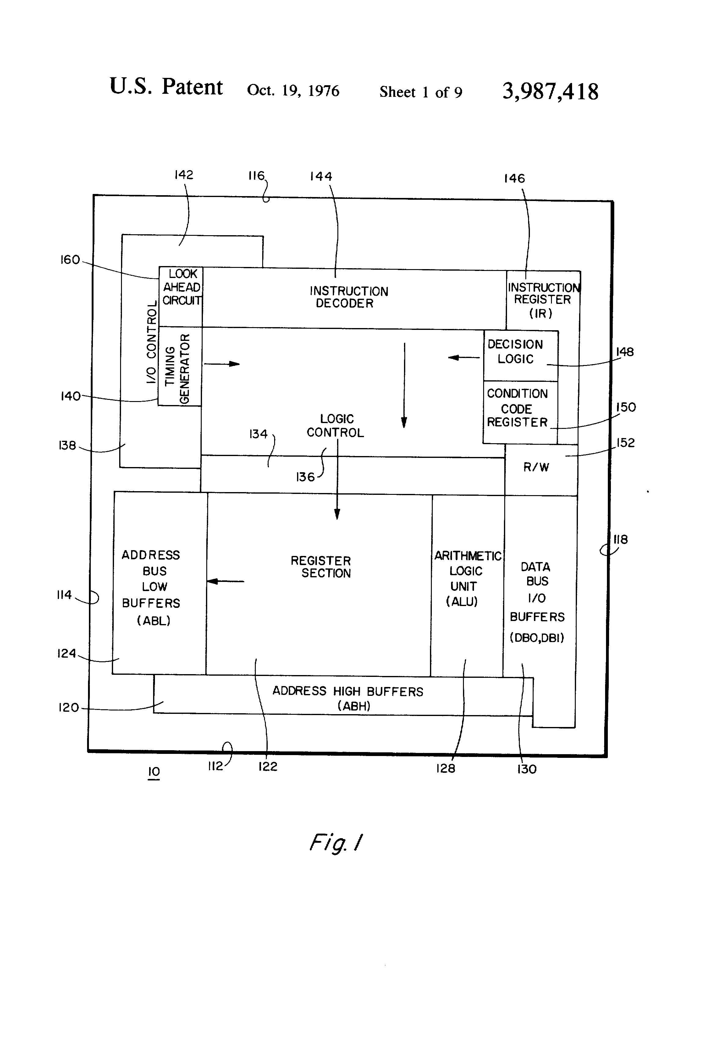

... interested in the 6800, because I'd like to see what similarities and differences exist ...
And the answer is...
From this patent: (US3987418A, now found here)
File comment: 6800 annotated chip floorplan

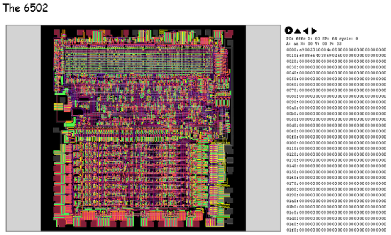

which compares to the 6502 (as seen at visual6502):
File comment: screenshot of visual6502 (early version)
...much less than I expected! I'm shocked!

Hey, there's a very big difference! As we all can see from your pics, the 6800 was only black&white whereas the 6502 had plenty of colors :-)

HAH, looks like Motorola was right after all. But, I'm still glad the 6502 won over the 6800. ;)

What are the I5x pullouts from the die?

These are reference numbers (in the 150's) used in the text of the patent in the "Description of the invention" section.
I notice the patent text refers to many other patent applications submitted in the same timeframe, including on interrupts and on instruction look-ahead. One of the circuits I intend to investigate in the 6502 simulator is the lookahead - it looks like the databus is inspected and some pre-decode signals derived during the fetch cycle. If that's right, then it's stealing some nanoseconds from the external access time. It's possible this trick is inherited from the 6800.
