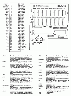

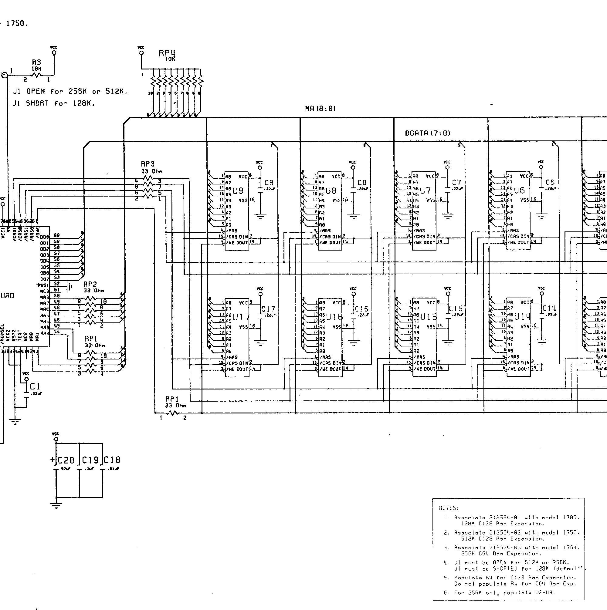

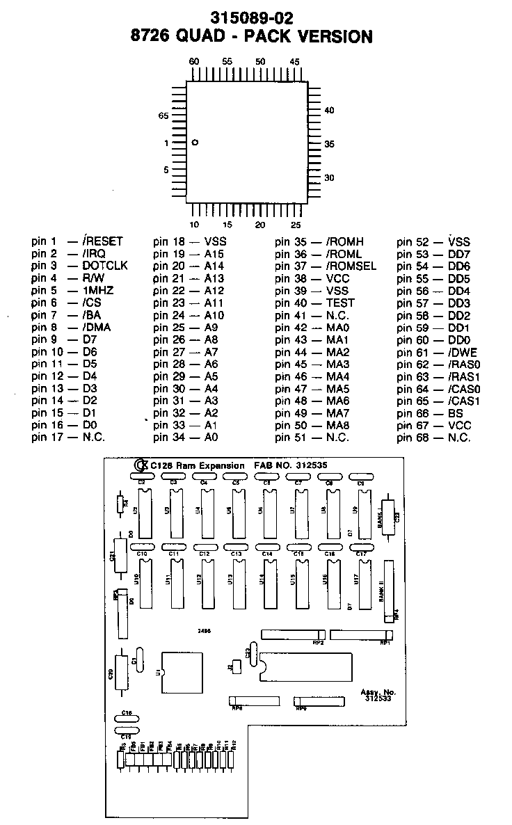

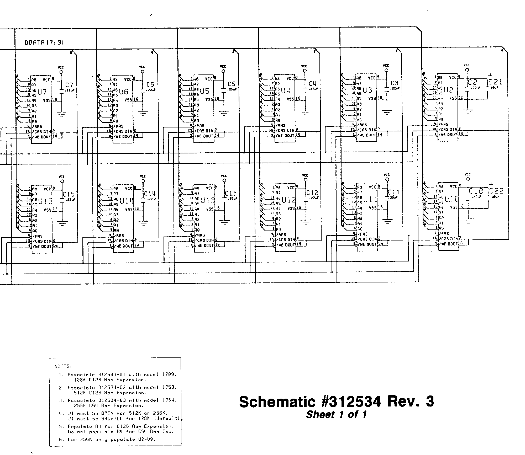

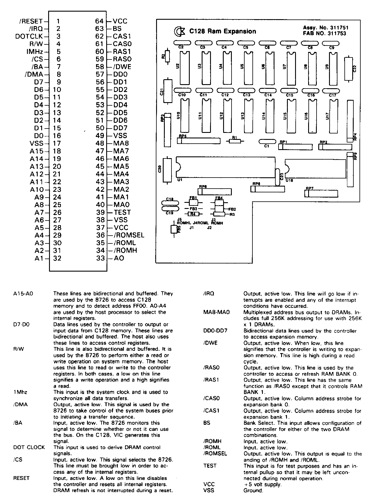

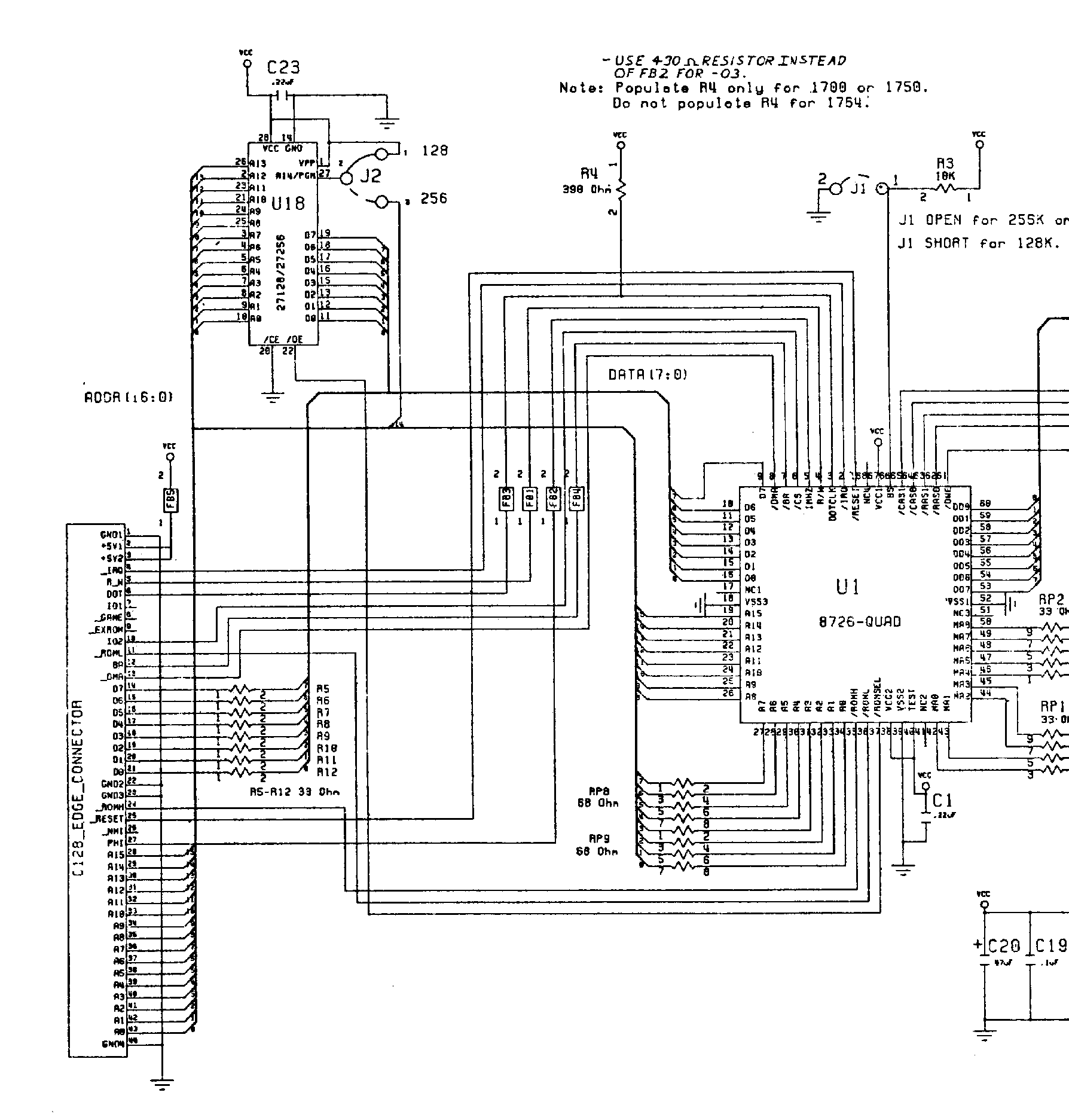

In searching DMA I found this thread. The link is mostly dead. I was able to retrieve these pages though...
Andy
