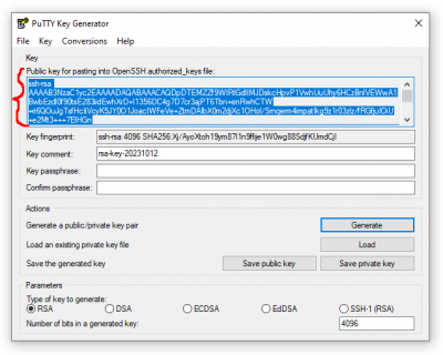

Not really a 6502 specific topic but I wanted to document this somewhere as doing development on Windows using GitHub can be a bit of a fraught process initially.
Download and install Putty (if you don't have it already). This will install puttygen.exe

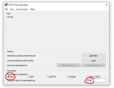

Run puttygen, it should be available from the Windows Start Menu after installation.

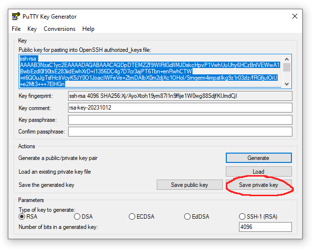

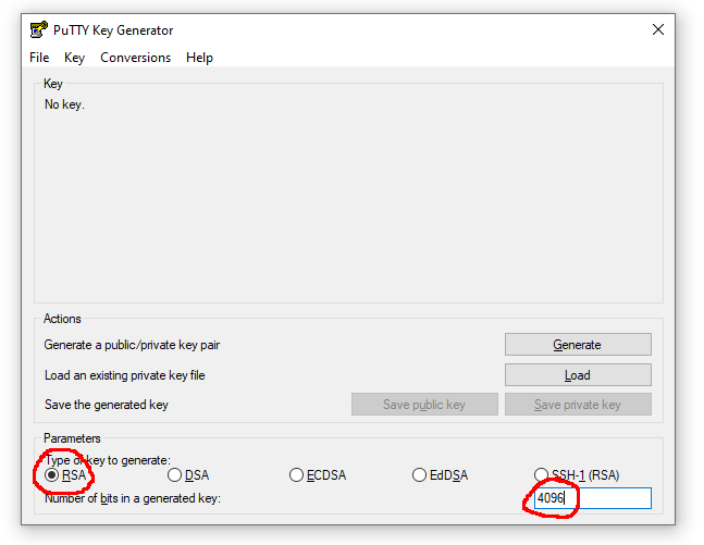

GitHub recommend using an ed25519 type key but Putty doesn't seem to support that. Secondarily they recommend an RSA 4096 type key and that can be generated by Putty.

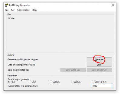

Click Generate
and wave your mouse around until the green bar is satisfied.

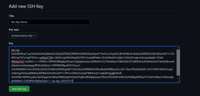

Once the key is generated copy the Public-key text...

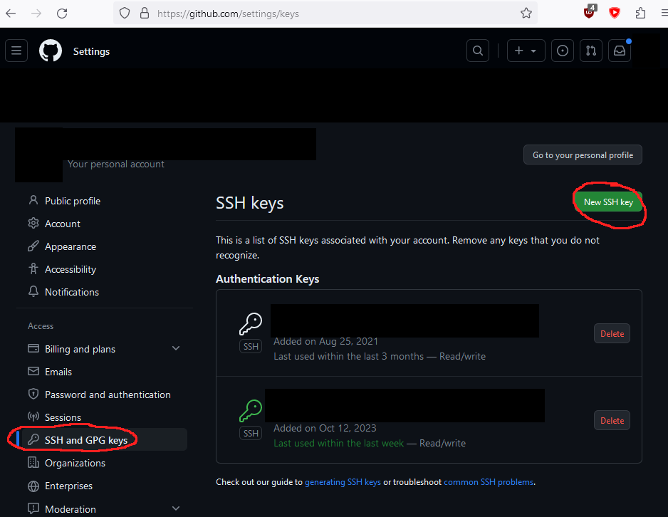

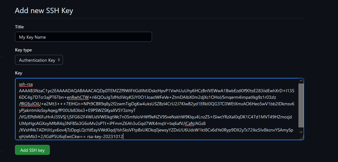

...into a new GitHub SSH Key. This can be found under your Account Settings, SSH and GPG keys:
And paste the Public-Key text into your new GitHub SSH Key
Add SSH Key and we're done on the GitHub side of things.
Back in puttygen copy the Public-Key text again, paste it into a text editor and save it somewhere useful with the .pub extension. E.g. C:\MyKeys\MyKeyName.pub Do not use the Save Public Key button from puttygen unless you know what you're doing. We're saving the OpenSSH Public-Key text just-in-case.

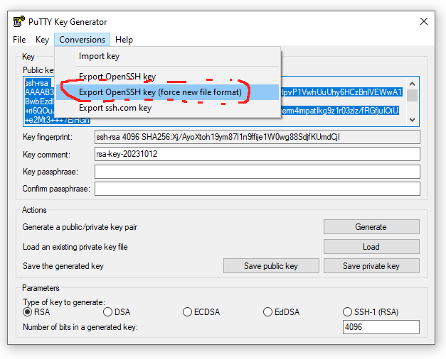

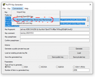

Next export the Private-Key for OpenSSH, again this is just-in-case...
...and save it somewhere secure. E.g. C:\MyKeys\MyKeyName Note the lack of extension.

Finally we need to Save the Private-Key in a form that can be used by Putty's authentication agent Pageant.
Save it somewhere secure E.g. C:\MyKeys\MyKeyName.ppk and note the ppk extension.

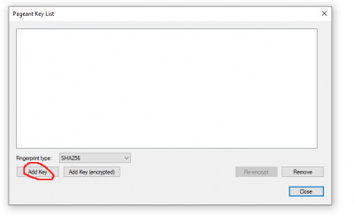

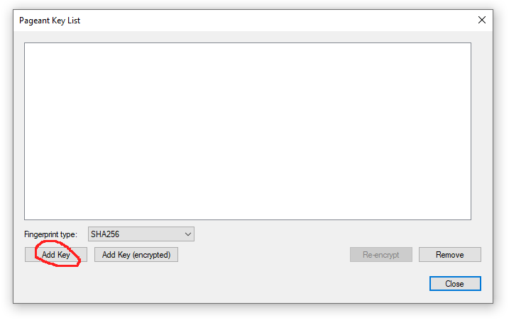

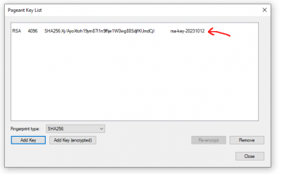

Finally open Pageant from the task bar by double clicking its icon (it should have started running when Putty was installed).
And add your newly saved PPK.
If everything has gone correctly you should see your new PPK in Pageant:
And you can now talk to GitHub using Putty via SSH!

According to https://www.chiark.greenend.org.uk/~sgt ... anges.html, the ed25519 key type is supported in puttygen since PuTTY 0.68, released 2017-02-21
Thanks for pointing that out.
Following the Windows 11 debacle I've since moved to Linux and so am no longer using Putty but still useful to know.

I should note that puTTY is not the most intuitive thing to use when it comes to key management. They have their own key store/format for managing keys, which requires extra hoops to get them into the correct format for Github (or just about anything else; a thing I fight with often when I have to update the keys across the 30+ Linux boxes I have to deal with at work.)
The Windows Git Command Prompt package includes OpenSSL though, so you can still run the ssh-keygen and openssl commands from there and get the needed formats.
