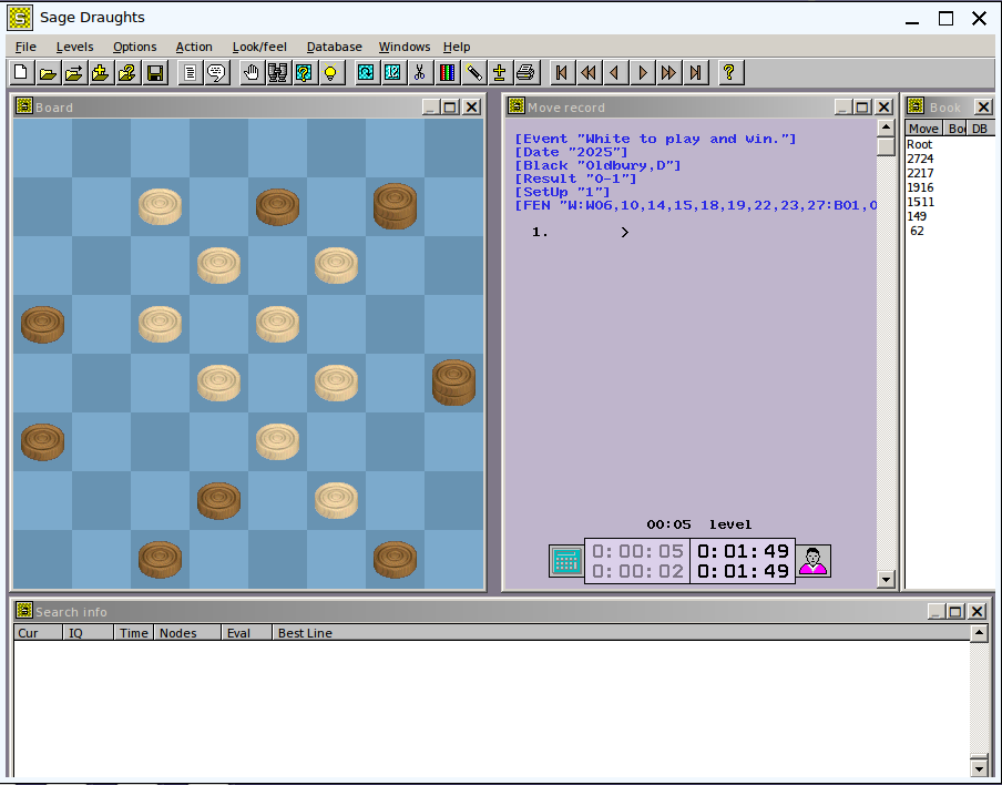

Ok, another "Draughts" release, not exactly 6502 related, but you can see the progression in this thread from an 8k 1981 PET program (Orac) to a win32 program with 6 piece "perfect play" endgame database with 30 billion positions!
Sage Draughts is a very comprehensive Draughts or Checkers playing program from the late 1990s. I am releasing this with the source code.
https://github.com/orac81/Orac-Draughts ... latest.zip
SAGE is a 32 bit Windows program, which should run on any version from XP up to Windows 11. It can can run under LINUX or MAC-OS using a windows emulator like WINE. It can be installed by simply downloading and extracting the zip file. To run, open the SAGE folder and click/run SAGE.EXE.
It has a very wide range of features, levels, analysis, game replay/save/load, handling PDN game databases, endgame "perfect play" databases, large opening databases, and so on.
Sage can play Checkers on any size Board from 4x4 to 12x12. It can also play Italian rules checkers.
Or you can just enjoy a game of Checkers!
For more details/source for Orac(6502), Dynamo and Sage see here:
https://github.com/orac81/Orac-Draughts/
To compile the source MSVC4.2 is needed, see src folder and sagemake.bat.
I did start writing a new engine based on Dynamo to play all the variants, inc 10x10 international draughts, able to run with SAGE, but small/fast enough to build with Oscar64-C/VBCC for the 6502, but its not finished yet.
Its interesting to note there are no 10x10 international draughts programs for the 6502!
