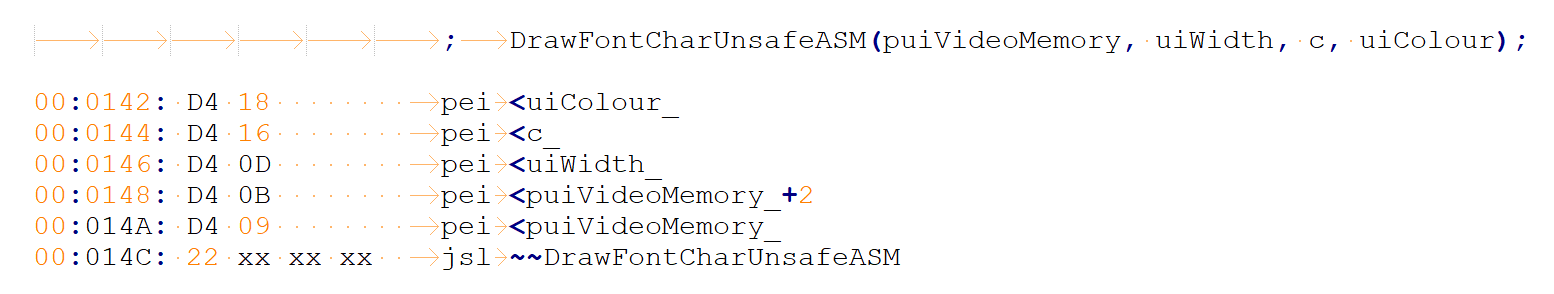

However the examples I'm going to use will make extensive use of the PEI instruction to push arguments before the function is called so a good grasp of both PEA and PEI is going to be helpful. If you already understand them you can skip over the rest of this post as I'll only start writing about calling conventions in the next post below.

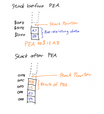

PEA - opcode F4
PEA pushes 16bits of immediate data onto the stack. It's described as pushing an address by WDC but the value can be used as anything you want.
PEA affects the stack as in the example below:

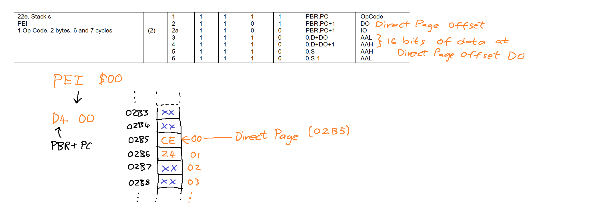

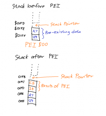

PEI - opcode D4
PEI pushes 16bits of data located at a Direct Page address onto the stack. It's very similar to PEA except that the data pushed does not immediately follow the op-code but is rather in Direct Page memory.
PEI affects the stack as in the example below:
PEA and PEI are always push 16bit data regardless of what the Memory Width (M) is set to.
And with that out the way we have a mechanism for pushing from the Direct Page (our functions stack frame) onto the stack (which will eventually become the called functions stack frame).

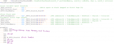

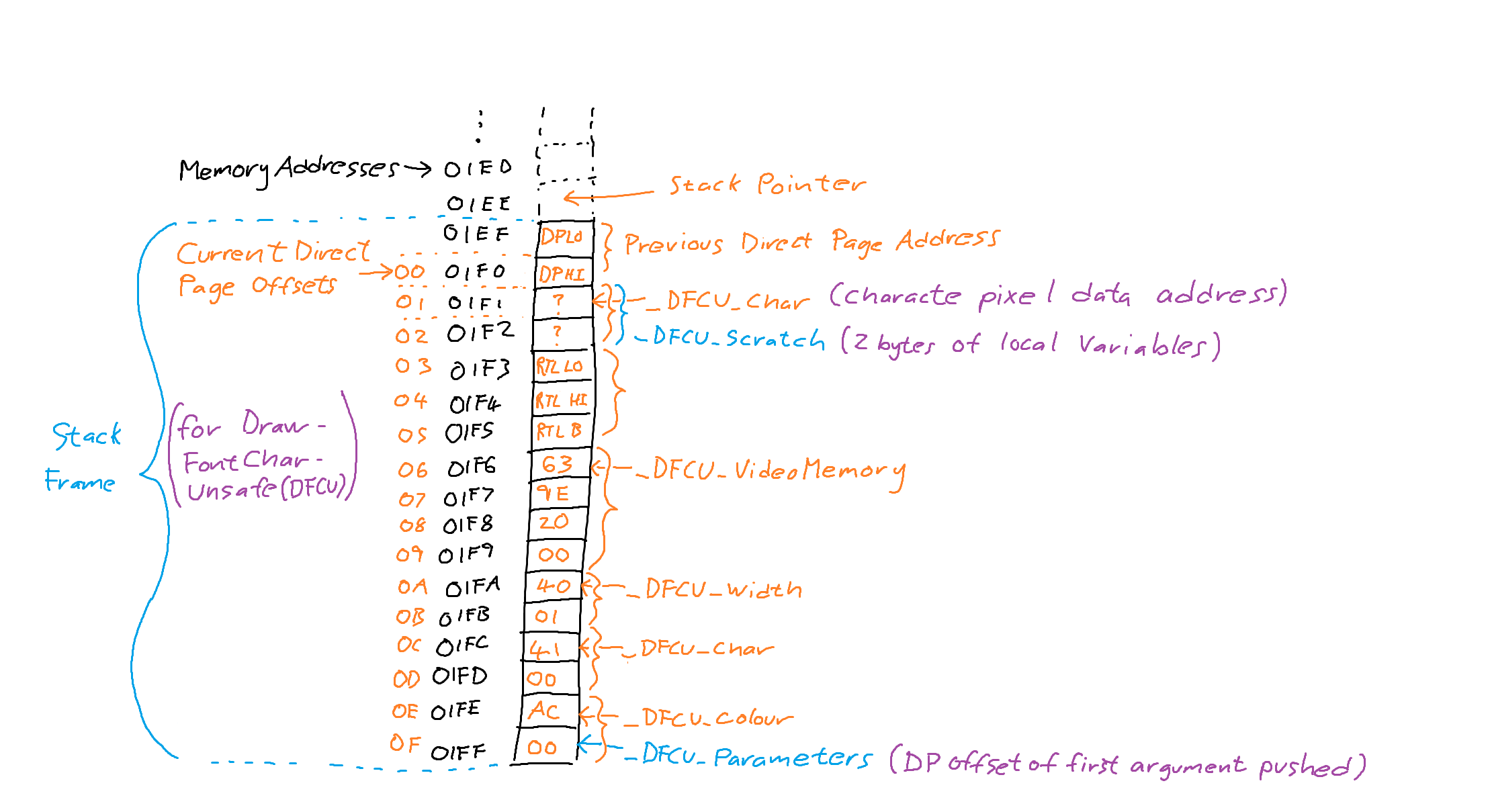

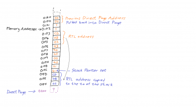

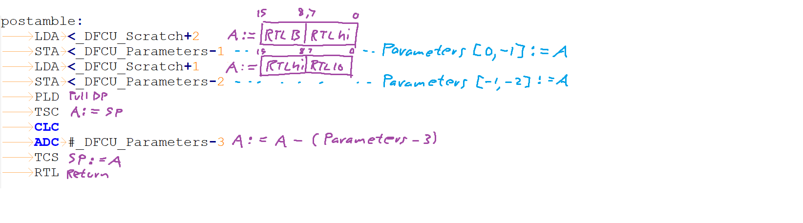

[Still a place holder]

I use pushparm in much of my code to feed parameters into functions. As a fairly general rule, required parameters are 32-bit pointers to data, so this macro “automates” the process, cutting down on typing...and potential bugs. Use of 32-bit pointers simplifies the performance of pointer arithmetic, as it avoids constant REP and SEP instructions to manipulate register sizes.

Your stack diagram for PEA seems to imply that the low byte of the operand is pushed before the high byte, which contradicts my 65xx instincts. I have a reputation for being correct more than 50% of the time. :D
Posts: 9425
Re: A (WDC) 65816 calling convention
I am having trouble reading Andrew’s stack diagrams due to the color, so I am entirely not sure what is in them.  If they are implying that the LSB is being pushed first, then that would be incorrect.  If, for example, SP (stack pointer) is currently loaded with $BFFF and the 65C816 executes PEA #$12AB, the sequence will be:
#$12 ——> $BFFF (SP)
#$AB ——> $BFFE (SP-1)
After PEA #$12AB had finished, SP would be $BFFD.  With the 816, all word pushes are big-endian.  When the stack is accessed using the stack pointer-relative addressing mode, e.g., LDA <offset>,S, and the accumulator is “wide” (set to 16 bits), the access will be in the customary little-endian style.
Good spot thanks! A good rule of thumb is that the high byte always goes higher in memory*. Chock up another one to greater than 50 :D

The method I developed was intended to fulfill several requirements: transparency, recursiveness, ease of accessing entry register values (or changing them before exit), and the desire to be able to index the stack-bound zero page from $00. Hence upon entry, a function will push the registers that will be used, in a defined order, and then tinker with the stack pointer to reserve needed workspace.
Unfortunately the last month or more at the office have been quite unpleasant with last week (at last) seeming to have calmed down.
Oh boy have things not.
This week has already gone properly off the rails with no chance of recovery any time soon.
So why have I quoted BDD above and why am I mentioning this? Well he's mentioned the gist of what I want to post and I'm going to be unlikely to find the time to finish my place holder post above anytime soon.
I had started writing up the post and if you're interested (and for comparison) the following two images kinda show how the WDC setup (preamble) and cleanup (postamble) are done.
         pea #$00
         plb
         plb                   ;configure data bank...
I always love seeing other people's code because there's always so much to learn. I would not have thought of that as a quick way to set the bank address to zero without having to switch out of 16bit mode.

So why have I quoted BDD above and why am I mentioning this? Well he's mentioned the gist of what I want to post and I'm going to be unlikely to find the time to finish my place holder post above anytime soon...
Unfortunately, I can’t read some of that...
...the following two images kinda show how the WDC setup (preamble) and cleanup (postamble) are done.
For comparison purposes, the following is the postamble to my earlier example for the BLKREAD function:
