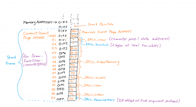

There have been a couple of discussions around stack frames and such and I really want to document them all in one place.
To this end the calling convention I've settled on using is the WDC C compiler's (previously the Zardoz C compiler).
In summary it assumes arguments that are going to be passed to a function are pushed onto the hardware stack before the function is called. On entry (JSR / JSL) to the function being called the Direct Page is set the address of the Stack Pointer (+1). This allows the those arguments to be accesses using Direct Page addressing rather than the limited Stack addressing modes.
This leaves out stuff like: what about local variables to the function? Is it safe keep using the stack? How does returning work? And what happens if a function is called again?
And I'll get to all of that but for now the general idea is just that the Direct Page IS the Stack Frame for the function that has just been called.
However the examples I'm going to use will make extensive use of the PEI instruction to push arguments before the function is called so a good grasp of both PEA and PEI is going to be helpful. If you already understand them you can skip over the rest of this post as I'll only start writing about calling conventions in the next post below.

PEA and PEI are always push 16bit data regardless of what the Memory Width (M) is set to.
And with that out the way we have a mechanism for pushing from the Direct Page (our functions stack frame) onto the stack (which will eventually become the called functions stack frame).

Your stack diagram for PEA seems to imply that the low byte of the operand is pushed before the high byte, which contradicts my 65xx instincts. I have a reputation for being correct more than 50% of the time. :D
PostPosted: Sat May 11, 2024 9:50 pm
Posts: 8509
I am having trouble reading Andrew’s stack diagrams due to the color, so I am entirely not sure what is in them.  If they are implying that the LSB is being pushed first, then that would be incorrect.  If, for example, SP (stack pointer) is currently loaded with $BFFF and the 65C816 executes PEA #$12AB, the sequence will be:
#$12 ——> $BFFF (SP)
#$AB ——> $BFFE (SP-1)
After PEA #$12AB had finished, SP would be $BFFD.  With the 816, all word pushes are big-endian.  When the stack is accessed using the stack pointer-relative addressing mode, e.g., LDA <offset>,S, and the accumulator is “wide” (set to 16 bits), the access will be in the customary little-endian style.
I draw all memory maps top-down, logically placing higher addresses higher in the map.  Hence in diagramming a stack “picture,” it is helpful to draw it top-down as well.
Unlike SP in the 65C02 (and other 8-bit 6502 members), the native-mode 65C816 SP is a true pointer—it holds an address, unlike the 65C02’s SP, which is merely an index into a fixed memory range (page $01).  That the native-mode 816 SP is a pointer makes it easy to do all sorts of useful tricks with it, which are facilitated by various stack-oriented machine instructions.  For example, the 816 makes it convenient to reserve ephemeral workspace on the stack, giving each function in your program a “scratchpad” for doing local stuff:
Good spot thanks! A good rule of thumb is that the high byte always goes higher in memory*. Chock up another one to greater than 50 :D
Interesting, what you've posted for the function setup and cleanup is subtly different to this post here based on the WDC C compiler's convention. The only real difference being that the PHD happens last and without the INC. Possibly marginally more optimal but it makes thinking about variables in the Direct Page a pain because everything is offset by one as the first byte in the Direct Page contains the high byte of the old DP. The low byte being inaccessible at DP - 1.
Up until very recently, I was not familiar with how the WDC C compiler does it.
The method I developed was intended to fulfill several requirements: transparency, recursiveness, ease of accessing entry register values (or changing them before exit), and the desire to be able to index the stack-bound zero page from $00.  Hence upon entry, a function will push the registers that will be used, in a defined order, and then tinker with the stack pointer to reserve needed workspace.  Below is an example, culled from my SCSI function library.  I edited out some of the commentary for brevity:
