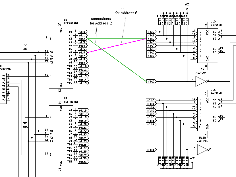

Expressed verbally, that line of reasoning seems pretty solid. But IME this stuff is awfully slippery to think about! :roll: And -- as was the case with my own circuit upthread -- expressing the thing as a diagram yields a different and gloomier conclusion. :|
In the image below, I've made some connections which plausibly might arise in real life. Drawn in purple is a line driven by Address 6, and when it goes low it pulls low the input nibl2, as desired. But that low signal will also propagate in an undesired way, backwards along the connections drawn in green (which are only supposed to go low for Address 2). Unless I'm somehow missing something, diodes or some other measure *are* required to prevent the back-feed.

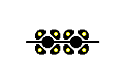

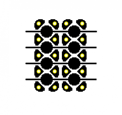

FWIW, here (below) is my first pass on (just for example) a SP8T switch. Either...
  • - a dab of solder would manually be placed in such a way as to connect one of the two center terminals to one of the eight surrounding pads, or...
    - that same connection would be ready-made as a slender copper trace, removable if so desired by use of a Dremel or X-acto knife.
Of course the opposite side of the board has eight traces running vertically (attaching to the vias, which I've drawn as yellow donuts).
SP8T switch (one).png (6.39 KiB) Viewed 972 times

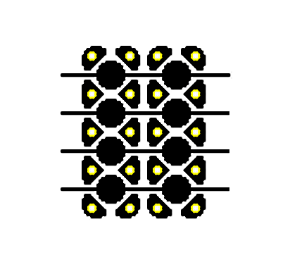

The second image shows a space-efficient way of packing multiple switches together. As you can see, they're compressed in the vertical dimension because each row of pads serves both the switch above and the switch below.
It goes without saying that there will be a LOT of vias. And IIRC, Express PCB charges extra for that sort of thing. Is this common? Will via cost be an issue?
ps- I think the density could be doubled by using a four-layer board with switches on both sides.

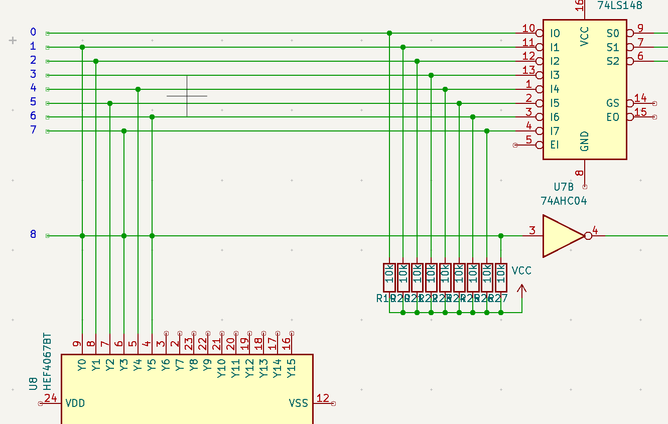

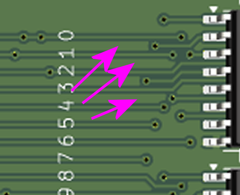

Curse this non-linear thinking! At least we find things like this before ordering any PCBs... you are of course correct. The culprit in this case is that handy '8' line that provides a multiple routing.
Redrawn to reflect the pcb layout, it's clear that the '8' line is providing a convenient short circuit where we don't want one... it could be fixed with two diodes per hi-Z output, I think; one to the 0-7 lines and another to the 8 (and of course two more for the high order nibble).
It might be simpler to extend the encoder to sixteen bits; we could live with twice the density of vertical lines. But that's three chips per nibble. And we'd still need the diodes for the other nibble. Damn.
Re vias: there is no charge for vias on JLCPCB though most houses used to charge for them. I suspect they use lasers to make the holes these days rather than breaking drill bits, but I don't know. My diode boards were the same cost as the Mesolithic due to size, even though they have about 1100 vias.
edited via count. It's one per diode, plus the other random connections.

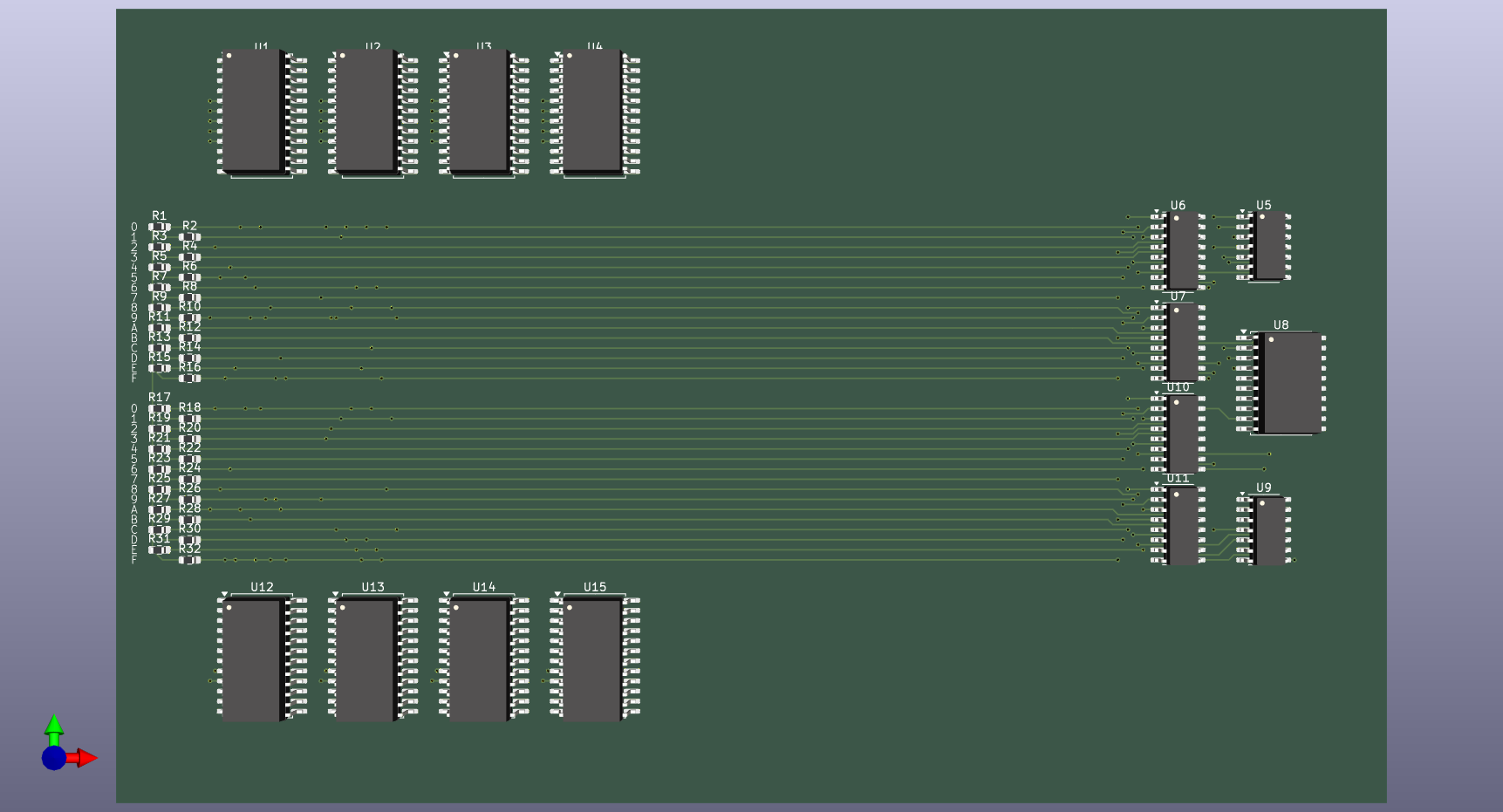

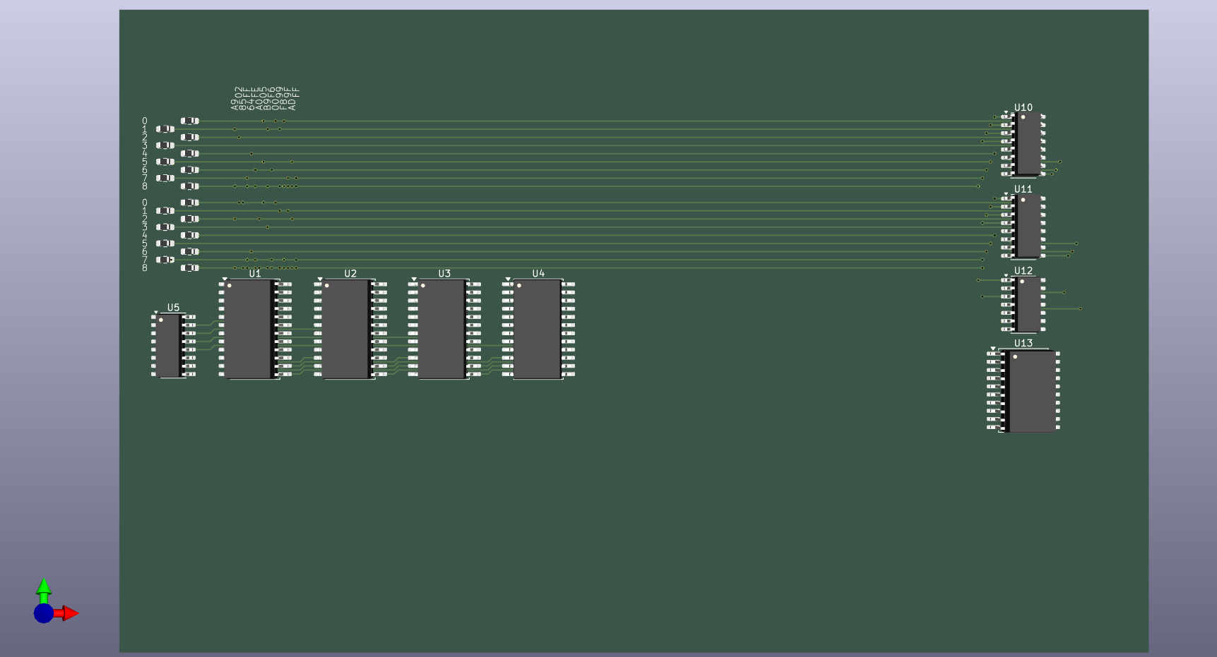

It turns out that diodes, even in double packs, take up more space than an equivalent SOIC-24, so this version eschews diodes completely (they come in 8-packs too, but I'd still need an awful lot of them, and they're a couple of bucks each, which is just silly) and use separate 4067 multiplexors for each nibble. Still definitely read only, but can take 128 bytes.
(Power, decoding, decoupling, and the actual connection to the main board aren't drawn yet, but I see no lack of space for them.)
muxprom2.pdf
(382.2 KiB) Downloaded 28 times
Columns are hi-Z outputs which pull low, rows are logic inputs pulled high. The high and low nibble are completely separate, so no nasty backwards routes. I hope.

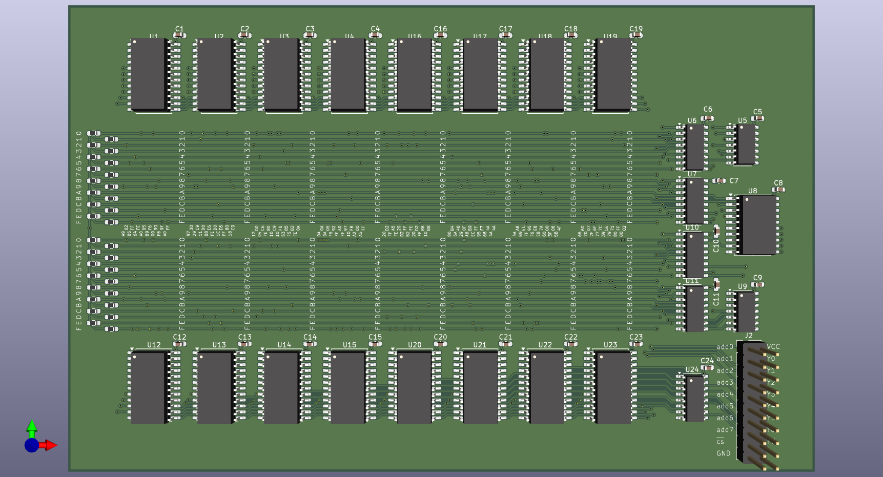

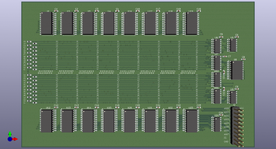

I think I may build this one up; soldering all those diodes is a pain and once the code is working, it will never change.
Separate columns for the high nibble and the low nibble are driven by the multiplexers which allows only one column to be low at any time; the other outputs are all high impedance (though there are multiple pins connected in many cases, there is no back-path because of the hi-Z outputs). Pull-ups hold the unselected bit rows high and two row encoders convert that to a four-bit nibble.
128 bytes, using eight address bits with add7 required to be high (easy to change). I _believe_ it might be possible to squeeze more on, with smaller packages, but this seems a reasonable compromise between legibility and space.
The multiplexers are under fifty cents at LCSC and the board would be about two dollars (though generally you'd need five) at JLC.
Neil (now back to soldering diodes...)

The new design looks pretty tidy, Neil. :) But, as always, you can rely on me for a steady stream of nit-picking and background noise! :mrgreen: :roll:
Can I suggest you omit these fills? I mean all fifteen of 'em between the bit lines, and the same in the other section. They make the actual bit lines harder to see, and -- more importantly -- harder to cut. I know it may be difficult to understand why anyone would wanna modify the ROM, but IMO novices should be allowed to tinker, as it can be an important part of how they engage.
I'm surprised. Is the price similarly low at Digikey and Mouser, for example? Although I'm the one who suggested those multiplexers, I can't help wondering if your original plan to use '154 decoders might be better. I suspect the 154's are more widely available than multiplexers (and in many cases more cheaply). Moreover, a person will only need half as many.
Yes I'm wandering back into diode territory, but the scheme I outlined in this post is fairly workable. Because it uses 3-pin diode arrays, the diode orientation can't be mistaken. And it's not that much more soldering. For each group of sixteen bytes, ...
  • - the multiplexer approach requires soldering two 24-pin multiplexers
    - the '154 approach requires soldering one 24-pin '154 and sixteen 3-pin diode arrays.

Pick away, pick away. The fills come free of charge when I push the 'b' button in Kicad; my usual habit is to have a ground on the top plane and a Vcc on the bottom, and that's the case here.
The two times sixteen row lines on the top should never be cut anyway; any change would be on the back; probably a partial drill to remove the back of the via and disconnect the line, and a bodge wire (on the top) to the appropriate row input. But the idea for this one is a get you out of jail card for the Mesolithic (or anyone else who wants a 128 byte rom).
Digikey has the multiplexers with 11k in stock at 56 eurocents (also from TI) for single units. TI hc154 are 62 eurocents, but you only need half as many. The snag was that the diodes took up more board real estate space than an extra 24-pin soic - though to be fair, space isn't a big problem here.
However, the big advantage with this board is feeding the two nibble rows from top and bottom gives a very clean and obvious layout. I'm not sure if something could be done with the diodes to split into two halves, as it were... though to be fair, the PCB doesn't _have_ to match the drawing layout!
(Warning: big A2 pdf):
muxprom2.pdf
(929.63 KiB) Downloaded 59 times
Meanwhile, I've finished soldering diodes to the original diode design. Still some components to fit; pullups and decoupling, then I toss up whether to test it on a breadboard or just stuff it onto Meso. But for tonight, my eyes are on strike.
