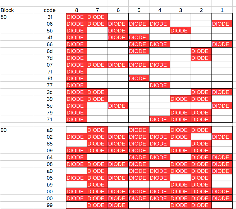

A segment of a spreadsheet that converts assembly code into diode patterns (diodes required where zeros are wanted). To my surprise, it needs 592 diodes, probably because of all the zero page addressing references.
(The code starts at $90).

This is a very different slant on code optimization. Minimizing the number of zeros rather than minimizing the number of bytes.

hoglet wrote:
n... For example, I think there are nine references to memptr / memptr+1. Just moving that from 08/09 to FE/FF would save soldering 54 diodes.
This is a very different slant on code optimization. Minimizing the number of zeros rather than minimizing the number of bytes. ...
Zero page addressing doesn't intrinsically use more 0's unless treating kernel code like application code and starting its allocation from $0000.
I had leds at $FA and memptr at $F8 ... and then realized that for patching to be able to use all eight leds, leds ought to occupy eight bytes even if only six are used ... but yes, since memptr is used more, memptr at $fe and leds at $f6 is %11111110 and %11110110, which helps reduces the zeros. The temp is at $f5, %11110101.
So putting memptr at $FE rather than at $02 saves 6 diodes per use (7 versus 1), and putting memptr+1 at $FF rather than at $03 also saves 6 diodes per use (6 versus 0). If "leds" appears three times, putting leds at $f6 rather than at $08 saves 5 diodes per use, or 15 total.
I put the segment table at the end of the DROM code, right before the RESET vector, for greater ease in later patching when copying into EEPROM, but $ffec is %11111111 %11101100, which increases the ones in reading the segments table, and then "to_leds", which is called three times, can be at FFD3, which is %11111111 %11010011. So those are two words used I think five times total with only three zeroes per word.
Leaving the segment table at the original $FF80 makes it %11111111 %10000000, for 7 0's for a word that I believe appears twice, costing 8 more diodes than my location for the segment table.
So even setting aside the patching issue, it optimizes the hardware to put the segment table right below the RESET vector.

Well, I could save even more simply by using inverting buffers on the DROM: that would require diodes where a one is required, so I'd need 1024 - 592 = 432, an immediate saving of 160, but I've already got the parts order running and I'm not starting another
As pointed out above, the issue isn't zero page per se, it's references to constant locations with lots of zeros in them...
Re: First thought on an interface (to use Paleolithic DROM)
So, the following changes
I think I can live with that
- move LED_PATTERNS to $ffec
- move temp, leds, and mem_ptr to start at $f5
- move keys to $97ff (incomplete memory decoding!)
- move led_addr to $9ff8 (again)
