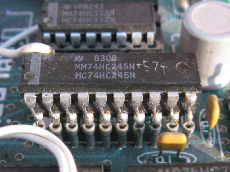

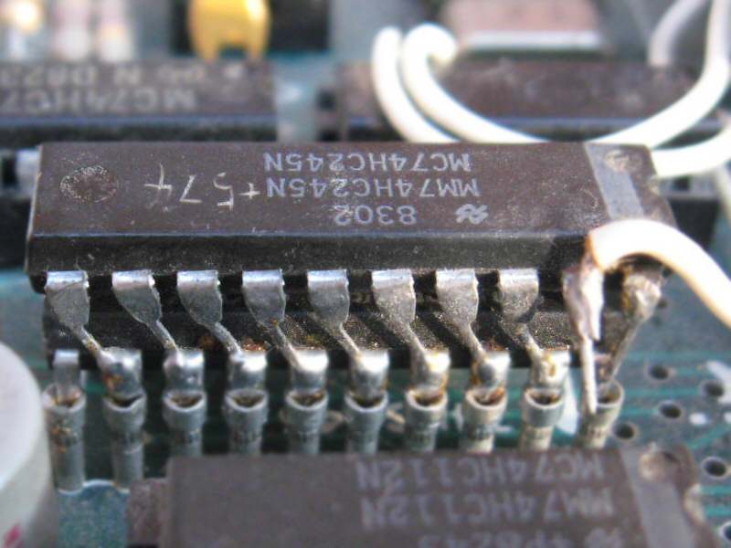

Posts: 3524
Re: First thought on an interface (to use Paleolithic DROM)
Thoughts?
I think the 'AHC541 will function more satisfactorily if the inputs & outputs are swapped rather than being connected as shown. :wink:
But perhaps that '541 (which acts as an unlatched input port) could be eliminated. Instead, your '574 latched output port could be replaced by a single, bidirectional device which acts both as an (optionally latched) input port and a latched output port. Possible candidates include the 74HC(T)646 and '652; also the 74FCT543 or 74LVC543.
More casually, the same highly compact effect can be achieved by soldering a '245 on top of a '574. :mrgreen: The photos below show how on one side the 8 data pins bridge straight (more or less) from chip to chip, and on the other side they bridge with a 1-pin offset. For your application, the 245's DIR (pin 1) needs to be tied low (and not tied to the 574's pin 1).

Thoughts?
Oops! :oops: Details, details...
It would be nice if the hardware more directly encoded the key press, though. At the moment, the bottom two bits of the read address have the low bits of the key; it would be handy to find a way to do something similar to the row values. At the moment it's necessary to shift and count... and while the 65c02 is a very nice instruction set it's not always very dense.
