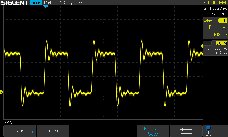

Neither clock signal looks good. The clock without the damping resistors looks horrid, to be frank, which means the resistors were actually helping. Something is definitely not kosher; I think you have an abnormal loading problem somewhere, judging by the way the rise and fall noticeably slow as the signal approaches the respective terminal level.
On the scope I am seeing some that /RD and /WR lag ~10ns compared to PHI2. That is not out of line with the fact that it's passing through a 7ns CPLD. Still, signs are pointing to the ATF1504 that does the /RD and /WR. Which sucks, because apparently my expensive Atmel USB programmer seems to not be working any more; it can't find either CPLD through the on-board JTAG, nor can it find a brand new chip plugged into a breakout board that has JTAG. Fun times!

I think the relative phases of things is going to be the clue - presumably you have at least two channels? Clock plus one other, and the other one working down a list: chip select, write enable, read not write, address line. Perhaps trigger on chip select? (Chip select of the RAM which is getting unintended writes, by hypothesis.)

Having sampled a number of 65C816s in POC V1.3 while the logic analyzer was hooked up—one of which was an older 0.8µ Sanyo-cored part, I can tell you tADS was consistently right around 12ns on five volts and at room temperature. Using 12ns for tADS, /RD or /WD in your unit should become valid no later than 20ns after the fall of Ø2. 20ns in your application is all the time in the world, so to speak, so I don’t think CPLD prop time is the issue. If the 1504 is being a bottleneck, I’d be suspecting your Verilog.
I based that 20ns number on the fact that the ATF1504AS-7 has a worst-case 7.5ns pin-to-pin prop time on five volts. As the generation of /RD and /WD should be nothing more than combinatorial logic, the device’s pin-to-pin prop time would be the controlling factor in when those signals would become valid. In my POC unit, I use discrete 74AC logic to produce those signals; the time required for /RD and /WD to become valid is in the 18-20ns range after the fall of Ø2, and hence comparable to what you should be seeing.
Regarding the 816’s tADS spec, yes, I know the data sheet claims it could be as long as 30ns on five volts. My opinion is that is malarkey, and likely reflects the days when the 816 was being produced in 1.2µ geometry and FMAX was 10 MHz (we’re talking 35 years ago). If the quoted maximum for tADS really is 30ns, the 816 would be barely functional at 14 MHz, and definitely incapable of meeting setup times at the 20 MHz David Gray says production devices are tested.

With your scope’s sweep being triggered by the rise of Ø2, one channel watching RWB and the other watching /RD or /WD, you should have no trouble determining if read/write timing is sane.
A fundamental to keep in mind when examining 65xx circuit timing is it is the fall of the clock that is the start of a machine cycle and hence the “ground zero” timing reference. In the 65C816, the tADS parameter is most important and may be thought of as the time that elapses after the fall of the clock before the states of VDA and VPA become valid. If one strictly follows WDC’s recommendations, all chip selects should ultimately be qualified with those two signals, since they alone are the true arbiters of when MPU state stabilizes.
Timing is always based on the assumption that the clock is symmetric. If it isn’t, your worst-case timing headaches will come during the shorter clock phase. As your clock is being run through a flop, asymmetry shouldn’t be a concern.

jmthompson, at some point it may be desirable to run some new experiments, striving to make them as simple as possible (while still demonstrating the misbehavior, of course). What we want is an example of the corruption that's minimally complex, because penetrating complexity is fundamental to troubleshooting. We also want maximal documention (ie; you'd share full details of the experiments with us).
AIUI, all your code resides in a "ROM" (actually a memsim emulator) in Bank $10. I'd like to see what happens if, immediately following reset, you were to fill RAM with $55, then pound on Direct Page or the stack for a while. Then later would you look at other banks to see what if any corruption has occurred. I hope I'm explaining this in a way that makes sense...

Hey folks, sorry for vanishing for a while and leaving this issue with no activity. Got frustrated and took a couple months off. Also got I finally got employed so I can spend money on hobbies again. The software engineer job market right now is absolutely brutal.
The good news is I *think* I have this fixed as of today. I ended up swapped the 74AC573 latch for a 74HC573. The reason was because my logic probe was showing that when a data line (D0 in my case) was high on a previous cycle, then as Phi2 fell the latch briefly allowed that through as a spike on A16. It was very brief, and was already settled long before /CE or /WR got asserted, but it seems to have fixed the issue. My guess is the RAM was running an extra write cycle to another bank using the spurious upper address lines. This would also explain why any time I did see this issue the values written seemed to correspond to the bank (bank 1 corruption always had bit 0 set, for example).
Anyway, I'm back up to 8 MHz again and so far no corruption. I'm keeping my fingers crossed.
I have my doubts that switching to the somewhat-slower HC573 fixed the root cause.
I have observed what you describe in my POC V1.3 unit, which uses a 74AC573 latch (and no bus driver), yet is rock-solid at 16 MHz—uptime as I write this is 95 days. Address bus glitching during the TADS part of the bus cycle is expected, as it is during that time that the 65C816 is “shuffling the deck,” so to speak, in preparation for the next move. Different internal signals take different internal paths, some of which are longer in terms of elapsed time. That being the case, it is to be expected that not all outputs will simultaneously stabilize. I have routinely observed that the buses become a bit disorganized after the TAH period that follows the fall of the clock has elapsed, but before TADS has elapsed.
The fundamental difference between POC V1.3 and your machine is V1.3 qualifies all chip selects with VDA and VPA, not just I/O hardware. By the time those signals go true, the address and data buses have settled, and the emitted signals are stable. This I have observed with both the scope and the logic analyzer.
An address bus glitch during TADS will not affect chip selects if they are fully qualified by VDA and VPA. There seems to be some sort of illogical resistance around here to that, despite WDC themselves advising to do so in the data sheet.
I personally doubt this, and am more inclined to think you are being pranked by not fully qualifying your RAM chip select.
