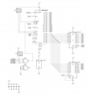

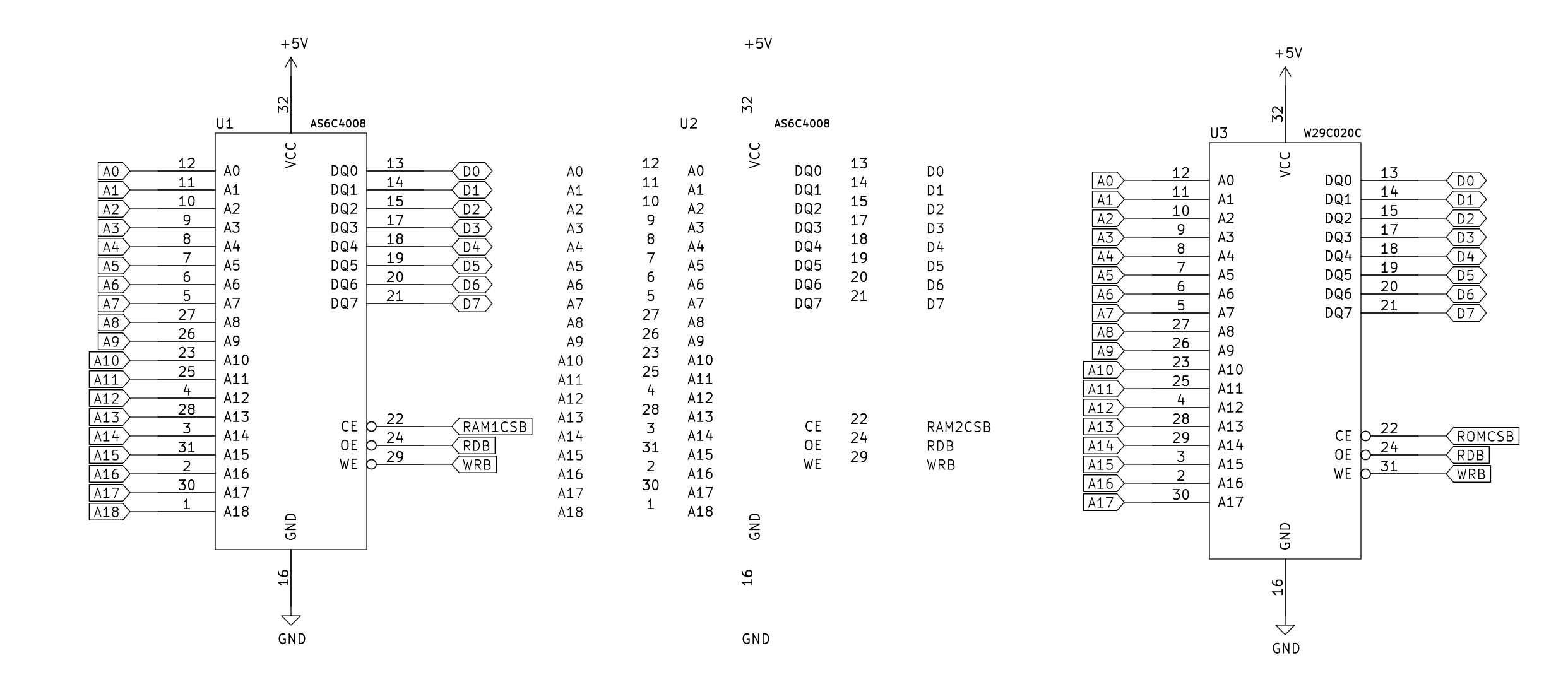

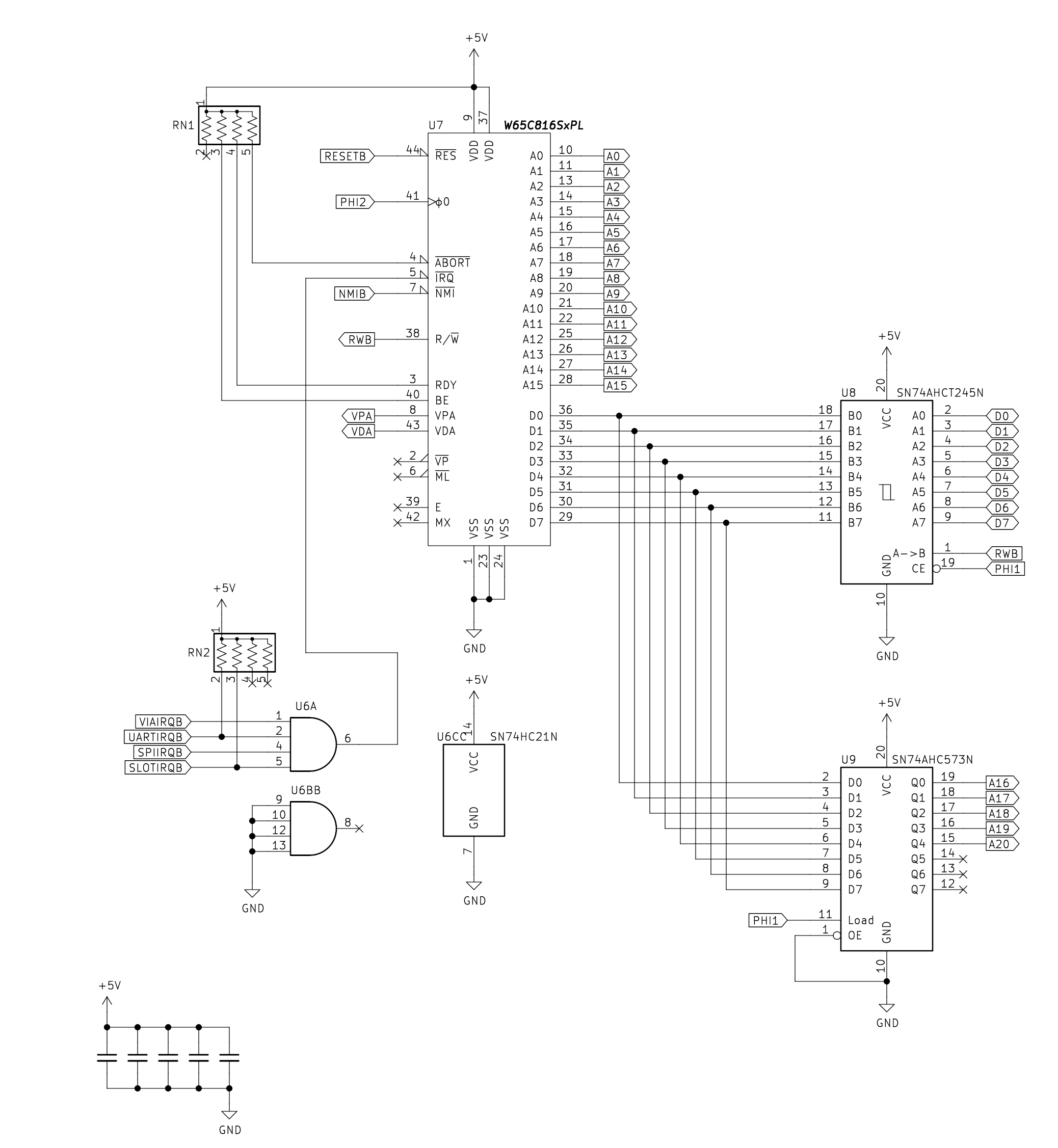

The bank address logic is the usual setup with a '573 and a '245:
The memory section is mostly just parallel connections but I'm including it anyway:
The I/O decoding is done mostly in an ATF1504. Here's the Verilog code for it:

I just added a PDF of the entire schematic here: https://area73.org/files/jrc-1/jrc-1.pdf.
The clock is the standard dual flip-flop that's posted all over the forums. It's on page 5 of the schematic. RAM speed is 55ns. The CPLDs are 7ns.
VDA and VPA are only used to qualify the I/O selects. Yes I could've just used VDA for that; I had originally wired both up in case I wanted the signal at a future time.

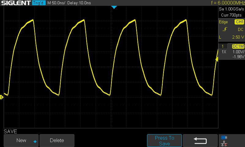

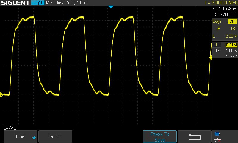

I've been doing more investigation today and narrowed this down a bit. What actually seems to be happening is that frequent writes to RAM seems to corrupt bytes in that same range in bank|1. In other words, heavy writes to even banks corrupt the same page in the next bank, but writes to odd banks don't seem to be causing issues. The reason it's manifesting primarily on the stack page is just because that's the one page that gets the most write activity.
I also poked around with my scope a bit. One thing I noticed so far is that the 100 ohm resistors on the clock lines (intended to suppress ringing) were distorting the clocks a bit too much. So, I bodged across the resistors, and the clocks look better now. A16 coming off of the '573 latch also seems to look fine.
Tomorrow I will try clipping the scope to PHI2 and /WR and see if they are ever active at the same time. If they are I'm going to have to do a bit of work to set myself back up to write ATF1504s...I haven't really done hardware for the past 3 years, so the JTAG hardware is put away and the software isn't even installed on my current workstation.
Can you photograph the Ø2 scope display with the resistors in-circuit?  It sounds as though something is abnormally loading the clock circuit if bodging out the resistors results in a cleaner signal.  What type of resistor are you using?

It feels like this is a timing marginality rather than a clock error. Most likely at the end of a write cycle, although just possibly at the beginning.
(That said, qualifying with phi2 is a logical operation which is intended to sort out what would otherwise be timing marginalities. But the exact phase of the phi2 relative to other signals will be meaningful.)
The resistors are some generic 1% tolerance carbon film resistors I bought ages ago.
With resistor in place:
With resistor bypassed:
Both PHI1 and PHI2 look like this. Both have very little connected to them: the 74AHCT573 and 74AHCT245 use PHI1, and PHI2 goes to the 65SPI and the VIA. Everything else is using the directed /RD and /WR.
Kinda surprised it was working with that signal; I know how picky the 65816 is about clocks, especially the rise time.

jmthompson wrote:
The resistors are some generic 1% tolerance carbon film resistors I bought ages ago...
I’ve got carbon films in POC V1.3’s clock generator; everything works fine at 16 MHz.
Neither clock signal looks good.  The clock without the damping resistors looks horrid, to be frank, which means the resistors were actually helping.  Something is definitely not kosher; I think you have an abnormal loading problem somewhere, judging by the way the rise and fall noticeably slow as the signal approaches the respective terminal level.
That said, I agree with Ed that this may not be directly related to clocking; it’s more likely a subtle timing issue, although clock quality could ultimately be responsible.  Do you have access to a logic analyzer?  If so, looking closely at the behavior of the bus transceiver during the critical “turnaround” period when the clock goes high during a write cycle might be helpful.  During write-cycle turnaround, the bank bits persist for a short time before the 65C816 begins to emit data.  I’m grasping a bit at straws here, but everything is on the table until eliminated.
Something that might help with figuring out if Jeff’s idea is a possibility would be to bias the data bus to VCC on the A side of the data bus transceiver (U8).  3.3K is a good choice for this, and can be done with either discrete resistors or an array.  During Ø2 low, the data bus will be floating, since U8’s /CE input would be high, causing the transceiver to high-Z its data pins.  Absent a signal, the outward side would be subject to the whims of stray capacitance.
Getting back to Ø1 and Ø2, you need to figure out why you are seeing those slow edges on the signal.  First thing is to verify that your test setup is correct.  Your probe needs to be on the ×10 setting and correctly compensated for your scope.  The scope’s signal ground needs to be as close as you can get to the point where you are picking off your signal.  If these conditions are being met, then it is probably safe to say what you are seeing is reality.
Assuming the scope isn’t lying about clock quality, it is possible that although the 65C816 seems to be working okay, its timing is actually being messed with by the too-slow rise and fall of the clock.  WDC says in the data sheet that the clock’s rise and fall times should not exceed 5ns—a 74AC74 on five volts will easily achieve that.  I can’t offer any experience with what happens if the clock edges are slow; Ø1 and Ø2 on my POC V1.3 unit are sharply-defined when viewed on a 275 MHz scope with a compensated probe.
Since multiple parts of your circuit are dependent on the clock, it could be one of them is not liking what it is seeing, resulting in flaky operation.  Before doing anything else, I’d be figuring out what’s up with that clock signal.

That looks like the CR product of your inline resistor and circuit load capacitance is (scratches head: 6MHz = 160ns, so the CR is about a fifth of that) enough to shift the timing of the clock - assuming it happens to trigger at half rail - by maybe 20ns rising and perhaps a touch more falling.
Effectively, you're probably shifting your clock signals by 20ns or so; it can't be healthy if its qualifying other stuff around the (nominal) edges.
