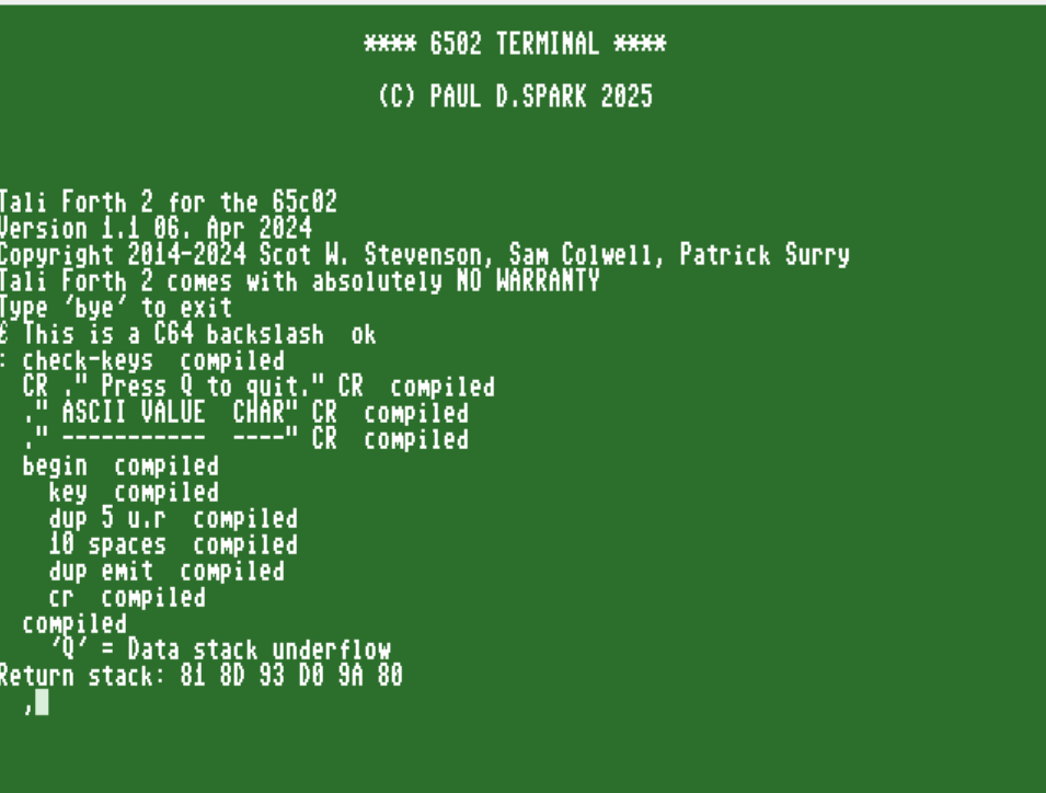

It looks as though my basic keyboard handling is almost there. As you can see I'm using the C64 font so the backslashes are appearing as pound signs.. but I can sort that out any time. I'll just hack the 8 bytes in the character ROM into a backslash :-)
One of the things I would like to do is use my "C64 style" screen editor like I did with BBC BASIC if possible. I just means that you can move the cursor up and around the screen and enter lines once again - just like the C64 used to. I hacked the BBC BASIC somewhat to make this work too - removing the ">" prompt and the likes. So it would be good to identify where the line buffer is within Tali and only process the "execute" (CR) action once something has been directly copied into the line buffer.
I'm also wondering if it will be possible to implement both legacy style page save/load/editing as well as a modern take on that.. but I'll learn to crawl first before asking about running.
Of course it would be the very last line that fails haha (note to self - implement the save/load state for this). Any idea what I can look for there? Perhaps there's something I haven't implemented? I can easily give you a hex dump of anything or any memory you're interested in seeing.

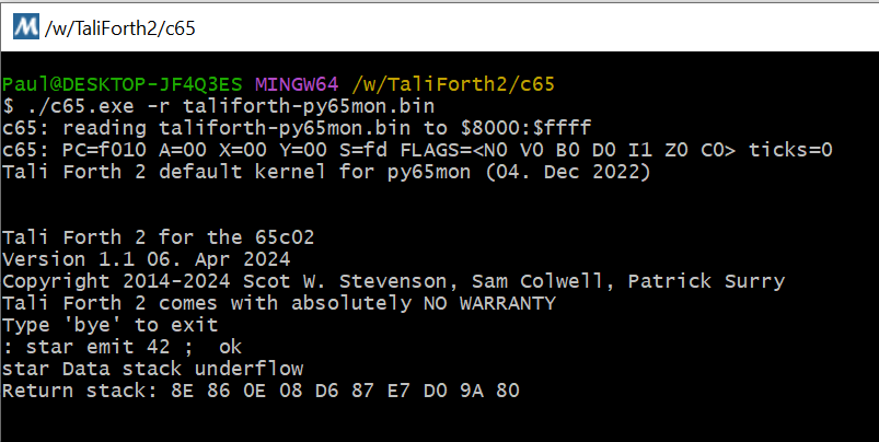

It looks as though it isn't happy with simple compilations either:
: star emit 42 ; Data stack underflow
Return stack: 81 8D 93 D0 9A 80
Hmm. This is interesting too - it must be me, surely?

The last one is you, but it's a simple fix - you just need to put the 42 on the stack before calling EMIT.
: star emit 42 ;  ok
star Data stack underflow
Return stack: 4F 86 0B 08 94 87 0C CE 91 80 \ My addresses will be slightly different than yours
: star 42 emit ; redefined star  ok
star * ok
The first couple, however, are problematic. You shouldn't be getting a Data Stack Underflow error when in compiled mode - that usually only shows up in interpreted mode because many of Tali's internal words skip the underflow check. Because everything up to that line compiled properly, I'm going to guess it's the line with the 'Q' = that causes the error (Tali lets you enter an entire line before trying to interpret or compile it). I do find it odd that your star word didn't compile (even with the 42 in the wrong place).
You can look in docs/platformname_listing.txt (where platformname is the name you used on your platform file) to use the return stack trace info. The addresses will be two bytes larger than the address of the jsr that calls the subroutine, so subtract 2 before searching by address. I see (reading backwards) the addresses 809A, D093, and 8D81.
809A appears to be in QUIT (this, oddly enough, is the word that actually starts the Forth interpreter/compiler) where it calls INTERPRET. REFILL has already been called, so the entire line has already been read into the input buffer.
D093 is in the main INTERPRET loop where it calls PARSE-NAME. This looks through the input buffer to try to find the separate words.
8D81 where underflow_1 is called at the beginning of PARSE - the underflow-1 routine makes sure there is at least 1 item on the stack.
That's actually a very odd place to run into an error, because PARSE is part of PARSE-NAME. The difference is that PARSE lets you pick the character that words are separated with, while PARSE-NAME always uses spaces. The reason why this is a very odd place to have an error is because PARSE-NAME just placed the "space" character (ASCII value 32) on the stack and then it falls into PARSE.
The underflow_1 routine will complain and give a stack trace when the value in the X register (which holds the Forth data stack pointer) indicates there is less than 1 item on the stack (in this case, when X > $77). Do any of your I/O routines touch the X register? If so, they will need the PHX at the beginning and PLX at the end. That's the only thing I can think of that would be messing with the data stack pointer. Can you share the platform file you are using for your hardware that has your I/O routines?

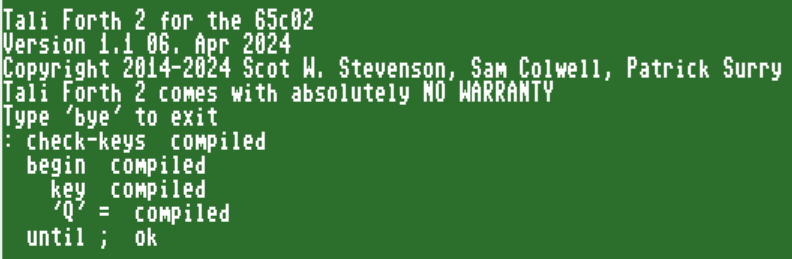

OK.. so I have done some more dabbling. I had to add some "automated typing" to my app (similar to copy/paste) and here's what I'm trying to execute at the moment.. thinking it should be a smaller piece of code to focus on:
: check-keys
  begin
    key
    'Q' =
  until ;
This time I get:
: check-keys  compiled
 begin  compiled
    key  compiled
    'Q' =  compiled
  until ; Data stack underflow
Return stack: D0 95 D6 87 E7 D0 9A 80
I've added some more labels to my disassembly to try and figure out what's going on (see attached pds2.txt log file).
    140063 PC: 95CE: jsr $d112:.underflow_1                                                          ; xt_until
    140064 PC: $d112  X: $78
    140065 PC: D112: cpx #$77                                                                        ; underflow_1
    140066 PC: D114: bpl $10 ; Branch to ($d126:.underflow_error)
    140067 PC: D126: lda #$09                                                                        ; underflow_error
Line 140064 is showing that the X register is $78, in which case the underflow error is taking place.
I'm thinking the best thing to do now is dump out the contents of the stack after each "compiled" output?
I'm assuming dsp0 is the stack pointer. My brain has come to an end today unfortunately, so I will have to come back to this either later or tomorrow.

The value being checked here should never be larger than $78, so I think the signed comparison is fine in this case. It's not the comparison that is causing any trouble here, but rather than the value in X (used as the data stack pointer in Tali Forth) is $78 (empty stack) when it should be $76 (one item on stack) at this point in the code.
While I don't think it's an issue here, I will put an issue into the tracker for that. Tali Forth allows relocating the stack to anywhere in zero page and it will be an issue if the stack crossed $80. Thanks for mentioning it.
SparkyNZ,
The dsp0 label is a constant value that the stack pointer (held in X) has for an empty stack. It has the address of $78 in the default zero page configuration (which you are using) where Tali only uses the lower half of zero page and leaves the upper half for the user to use. You can find the actual label in definitions.asm if you need it, but all you really need to know is that the data stack is in zero page and it grows downwards as items are placed on the stack. Each stack cell is 16-bits (two bytes) so X would have the value $76 when there is one item on the stack and $74 with two items, etc.
Your trace shows there is an error when it reaches the word UNTIL in the code. This word is expecting the address of the beginning of the loop to be on the data stack (some Forths have a separate flow control stack but Tali just uses the data stack, which is common practice). That address should have been put there when BEGIN was encountered up at the top of the loop. Somewhere along the way, it has been removed from the stack.
Can you verify that the Forth code you are trying to compile works in either c65 or py65mon? If so, that would point to an issue with your simulator. I will double-check today and verify the version you are using works on real hardware.
I believe you had mentioned that you are using the same fake65c02.h library that we are using for c65, but I will warn you that there are multiple versions out on the interwebs and not all simulate 65C02 properly. The version that comes with c65 has been modified slightly to pass all of Klaus Dormann's 65C02 tests (a series of tests used to test simulators for correct behavior). If you haven't heavily modified that file, you may want to try switching to the copy that c65 is using as it's known-good.
You'll also want to verify you are using a very recent version of the tass64 assembler (version 1.56.2625 or later should work). Some flavors of Ubuntu, in particular, ship a very old version. I usually just compile it from source, which is super easy because it has virtually no dependencies and it looks like you definitely know how to use a C compiler.
Tali also comes with a full test suite that tests about 90% of its functionality. It looks like you are able to compile the c65 simulator, so you can run make ctests to assemble Tali for c65 and run the entire test suite in that simulator. It should take a few seconds and will print a message that all tests passed successfully or will give you a list of the tests that failed.
(edited to fix typos)
Yes, it definitely works fine with C65 and that's using the same .bin file. I can confirm that the fake6502 library I have is completely different though. I couldn't find a fake6502.c (or .cpp) file in the C65 source - it looks like it's all in the fake65c02.h header file.

I had a bit of spare time.. I tried a few things but ultimately I replaced the Fake6502 with the Fake65C02 version from C65 and here's the result:
(It works!)
The first keypress checking program you gave me works.. but I'm still seeing "compiled" appearing twice for each line when I read in text from file, so I have a bit of tidying up to do there. When I get that sorted I'll see if I have some spare time to start looking at the line-entry changes.
