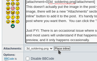

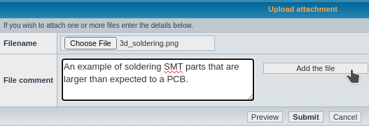

It's best to add images to the forum, when possible, as the external links tend to disappear over time. To add images, make sure you are on the "full editor". The Quick Reply area at the bottom of the thread has a button to launch the full editor. Then, below the editor is an "Upload attachment" area. Choose your file, provide a text description (handy for people who may not be able to see the image), and click "Add the file".
How to add images to a post.
This doesn't actually put the image in the post yet, it just uploads it to the server. After you've uploaded at least one image, there will be a new "Attachments" section with a dropdown that lets you pick the image you want and a "Place inline" button to add it to the post. It's handy to upload all of your images one at a time and then add them to your post where you want them.
How to place images in the thread post.
You can click the "Preview" button to see how it's going to look.
Just FYI: There is an occasional issue where sometimes image previews get rotated that I don't have a solution for and most users will understand if that happens. I don't believe it rotates the original image, only the thumbnail preview, and it only happens occasionally.
