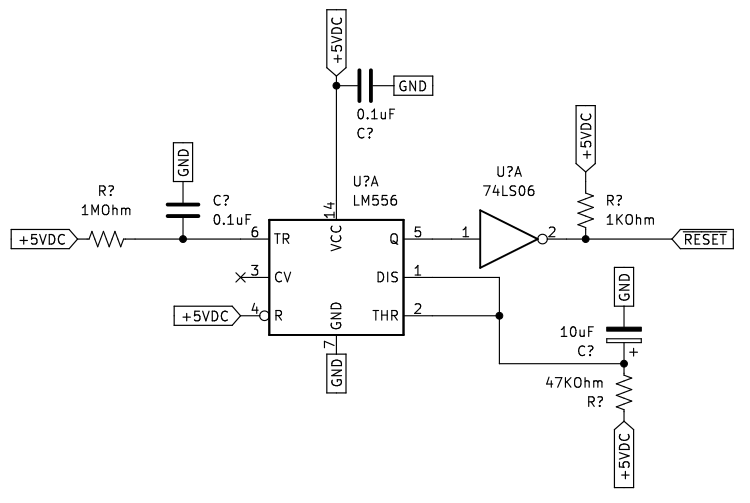

Hi!
I’ve just started designing a new board, or more accurately, reverse-engineering it based on sparse information and a touch of sleep-deprived inspiration. To keep things manageable, I’m breaking the project into multiple subboards in KiCad. I’m starting with the power circuit (since that’s the easy one), then moving on to reset, CPU, ROM, RAM, address decoding, and eventually video (though let’s not get ahead of ourselves). Each subsystem will be on a separate board for easier debugging.
Right now, I’m working on the RESET circuit. Here’s what I have so far: (image attatched)
I’d love to get some feedback—does this circuit look solid? Any potential improvements or optimizations you’d suggest?
Thanks in advance for any input!

Welcome to 6502 land.
I have not used the 555 (or 556, which is two 555's in one IC) except in school 45 years ago, and I never really got familiar with it, preferring instead to do those functions with Schmitt-trigger gates or with comparators like the LM339 or LM393 (same thing, just 4 versus 2 comparators in one IC).  I do have the SYM-1's reset circuit on the reset-circuit requirements page of the 6502 primer at http://wilsonminesco.com/6502primer/RSTreqs.html, which appears to be nearly identical to what you have (plus the reset pushbutton), except that it's for the 8-pin 555 rather than the 14-pin 556.  I seem to remember WDC used to recommend a rise time on the reset line that the 555 couldn't meet, and even the 74LS06 with a 1K pull-up resistor on the output couldn't meet either, being too slow; but if they did make that recommendation, they seem to have dropped it since then.  Some manufacturers had Schmitt-trigger RST\ inputs; but I never got a definitive list of which ones.  The reset page linked above will show other ways to do it.  I do recommend going through the entire 6502 primer though, in order, as it was written to answer a lot of questions and problems that kept coming up on the forum, and the pages kind of build upon previous pages' information to some extent.  The last page is a "circuit potpourri," and starts out with a basic whole-computer schematic, and shows using a single IC for address-decoding logic and the reset circuit as well; IOW, you'll get away with fewer parts if you don't try to make lots of separate boards.

I use the Maxim DS1813, which is one part in a TO-92 package.  The DS1813 is one of a number of similar devices that does what your circuit does in much less space.
An alternative if you want to “roll your own” is either this circuit or this one, both from Garth’s website.  I’ve used the latter one to trigger the MPU’s NMIB input with a “panic button” that regains control if a programming error puts the MPU into an inescapable loop.
reset_controller_ds1813.pdf
Maxim DS1813 Reset Controller
(206.15 KiB) Downloaded 98 times

It may be valid but it's somewhat complex. Those little DS1813 and variants are a one-chip solution.
Or, at the other end of the scale, what I'm using on my retro 6507 system is nothing more that a 0.1µF capacitor and 10K resistor - is it valid? Who knows, but it's the same as was used on 30 million Atari 2600s. It works for me when the power supply has a fast startup.

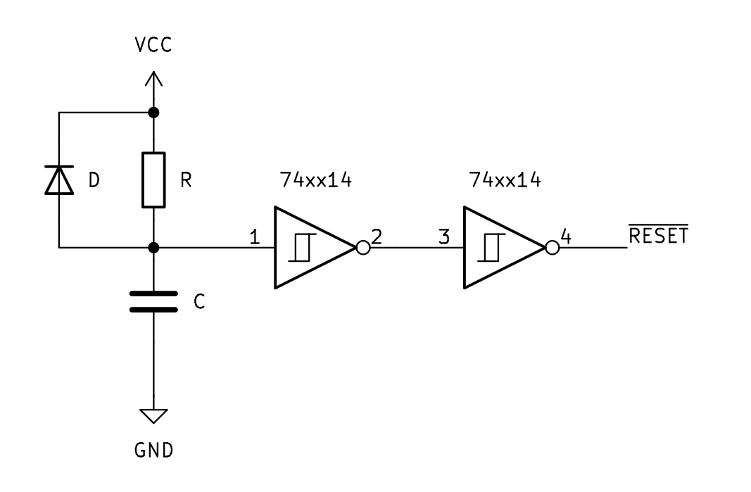

Pretty sure you can do this with a basic RC circuit, the 555 gives you a voltage comparator that can help, but you could use a Schmitt trigger to get the same effect:
This requires quite a number less support components than doing it with a 555 (556).
The basic idea is to hold the voltage low while the cap is charging. Changing the values of the resistor and cap will give different timings needed for a reset. The diode allows the cap to quickly discharge when the circuit is switched off.
Digi-Key has a calculator for getting the timing right:
https://www.digikey.com/en/resources/co ... e-constant
That being said I think the DS1813 is a good choice, as it's simple to setup and tailored to this exact need. The DS1511 (real time clock) basically has a similar function built into it, as I imagine several of the various RTCs have them as well.
There are of course alternatives to the DS1813 made by other companies that might have better price points if you need.

It's awesome to have an answer from Garth himself, your primer is awesome and every time I read it I learn something new I didn't learn the time before, this is one of these cases, the RESET can be way simpler than the mess I was making, and having the button was something I was missing up.
This actually seems a very valid, very simple solution, but, I live in a tropical, hot, humid place where you can't fully trust RC networks, casually, I have a 2600 clone(good ole Rambo TV Game), that only resets correctly like half the time(don´t know if they copied the original schematic or if they did something on their own for the reset).
I am going to look for the 2600 schematic and go from there, or going by Garth's solutions. Going to keep it up to date on this post.
Yuri
Posts: 371
Joined: 28 Feb 2023
Re: Is this a valid reset circuit
Post by Yuri »
That being the case I would highly recommend using the DS1813 then. The 555 is just an RC circuit at the end of the day and will be affected by all the same issues.

BillO
Posts: 1038
Joined: 12 Dec 2008
Post by BillO »
The DS1813 is the simplest way to get a proper reset. But they tend to be pricey (~$5) if bought from the big name houses.
The MCP100 is a much cheaper option (~$0.50) and if you need a reset button, just use a NC push button switch wired between it and Vcc.

With different R&C values 555 + 74_06 are the reset circuit for VIC20, C64 and C128. The 74_06 open collector can be shorted to Gnd for a manual reset, but for my VIC and C64 I put a push button to Gnd at the tr pin to get consistent duration reset regardless of how long the button is pressed.
