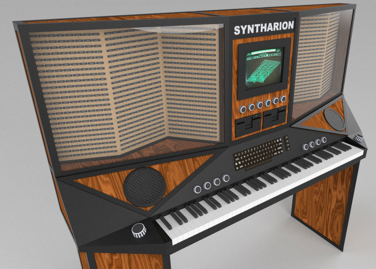

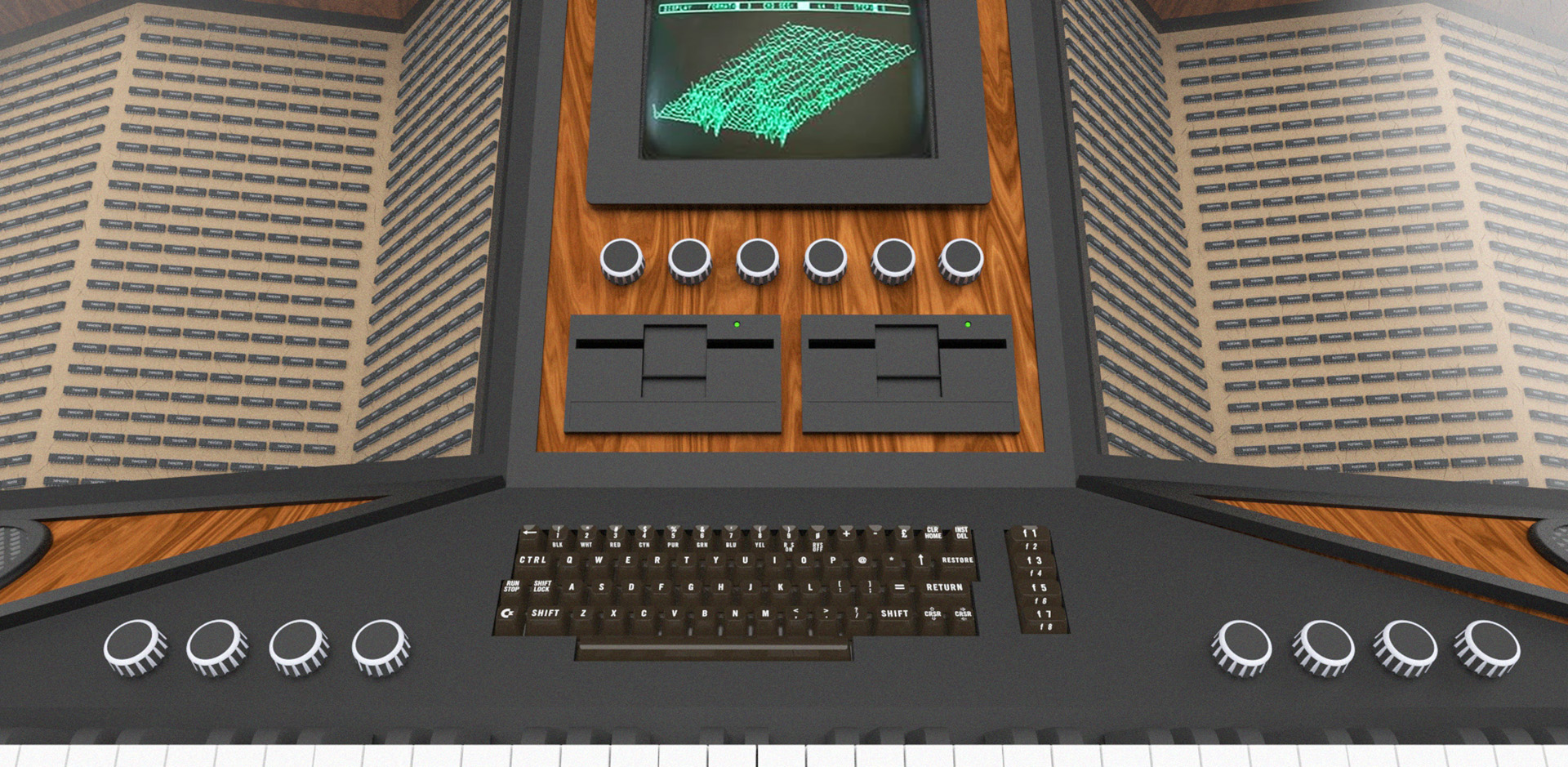

I played around with the color scheme a bit on the model and like where it went.
The look should scream out... stuck in the 70's but trying out the 80's.
Cleaned up the detail on the working keyboard as well.
Only the knobs and switches are undefined at this point.
The two large ones beside the piano keyboard are probably a go.
These are expression encoders that can be assigned to just about anything from pitch bend to low pass resonance.
I don't like the typical pitch wheels on keyboards, so I am going rotary with mine.
Going to try cutting the working keyboard cutout tomorrow if it isn't too cold outside.
So close to moving everything indoors for the year so I can dig into the circuitry.
The way electronic music is created is going to change forever in 1980 when this powerhouse is released!

Fashionable knobs of the era were proper collet knobs - the three-part type with a screw under the cap to tighten the collet on the shaft, none of these modern rubbish push-on types! (Also available marked up to 11 :mrgreen:)

Nice vintage unit! The first video really shows off the sound. It's multi track and processed through echo, but still a great demo.
I also like the matrix pad, much better idea than patch cables.
My first synth was a 1979 Moog without patch cables. It was limited but fun.
I also have to deal with some channel switching in this design later.
Standard sample channels (12) will be split into three, each running to several dedicated FX... low pass, resonance, distortion and possible digital delay.
I may just cram a load of pots on the front panel and do this all in analog mixing, but not sure yet. CD4066 analog switches are also an option.
The remaining 4 channels are specialized, one for the Votrax style speech box, one for a theremin type live play instrument and last two yet to be determined.
