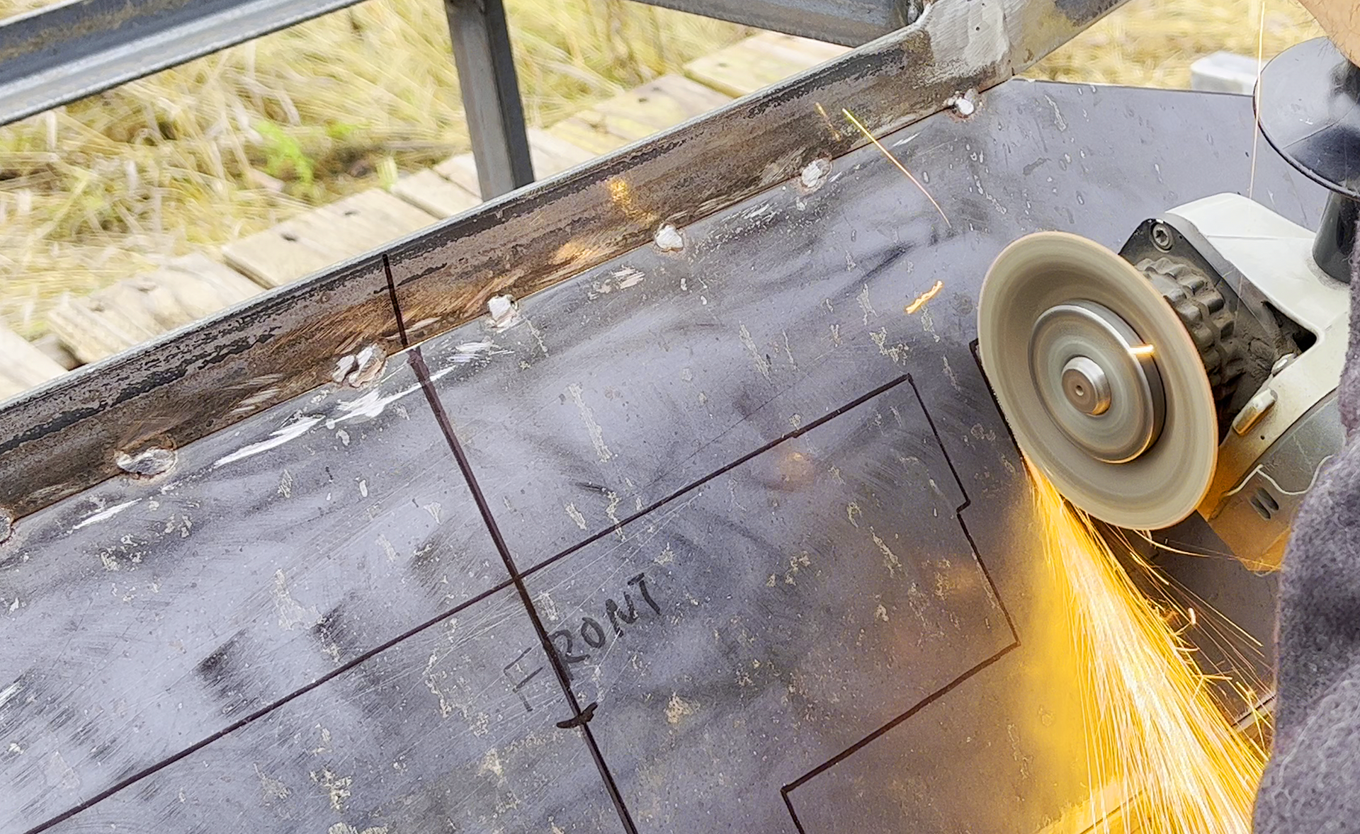

The rain held off this afternoon, so I attacked the front plate with my ultra high precision cutter.

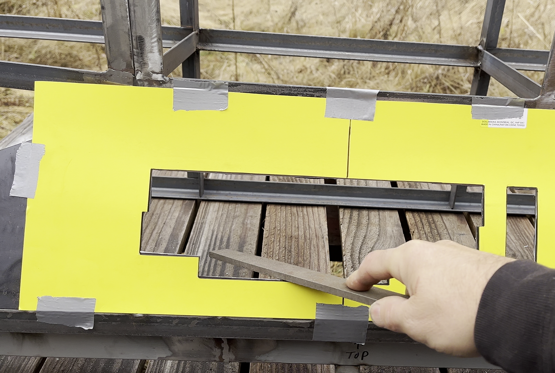

I used the paper template to trace the cut line, and kept a bit inside the line.
Always better to take too little than too much material away on the first cut.
Another space-age precision tool was used to clean up the grinder cuts.

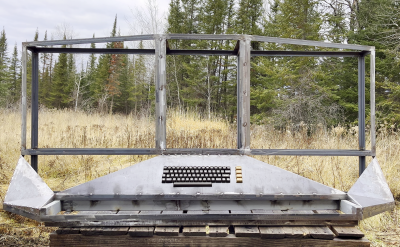

After 2 hours of good arm workout, I had something that fit nicely.
Will need a few small lengths of flat bar to make a keyboard mount, but that will be easy.
It looks like a lot of empty space back here, but the speaker boxes are going to take up much of that room.
There will be enough room for a power supply, the 200 watt audio amp and a few extras like the spring reverb unit.
Another small part completed thanks to a mild snow free El-Nino winter up here in the North.
Next I will make the keyboard attachment points and might even have time to do the speaker plate borders.
