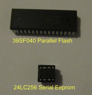

The 6502 family (and pretty much everything of that era) works with parallel memory.
I happened to have a 24 series serial eprom as used by a Parallax Propeller and large capacity 39 series flash, close to hand. As you can see, they are totally different.
The parallel device reads the address from the CPU in one go, and outputs all of the data byte at once over 8 pins.
The serial device will have the address sent one bit at a time, and will reply with the data one bit at a time.
So no, you can't use anything on that list to run code from, as they all seem to be 24 or 25 series types.
File comment: Totally different beasts
