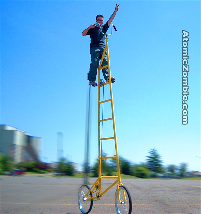

Piloting one of these ultra tall bikes feels like flying since you can't see anything but the world ahead of you.
Here is my original SkyCycle, not nearly my tallest, but the one that went viral.

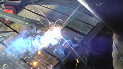

I have been busy up flying up North for work so I have mainly been working on the 6502 code for the sound channels and main OS. I built a tiny breadboard version with one channel that travels along with me so I can keep sane after the workday is done. Today I switched gears and took some time to start on the base frame so it would at least be done before the snow returns around here. Since I had not used my old welder for a few years, it needed work so by the time I had the sparks flying, the sun was already setting.
Did manage to get a lot of the base frame complete, which is the footprint for the entire unit.

Sparks are flying in my high tech shop (aka - old pallet out back)...

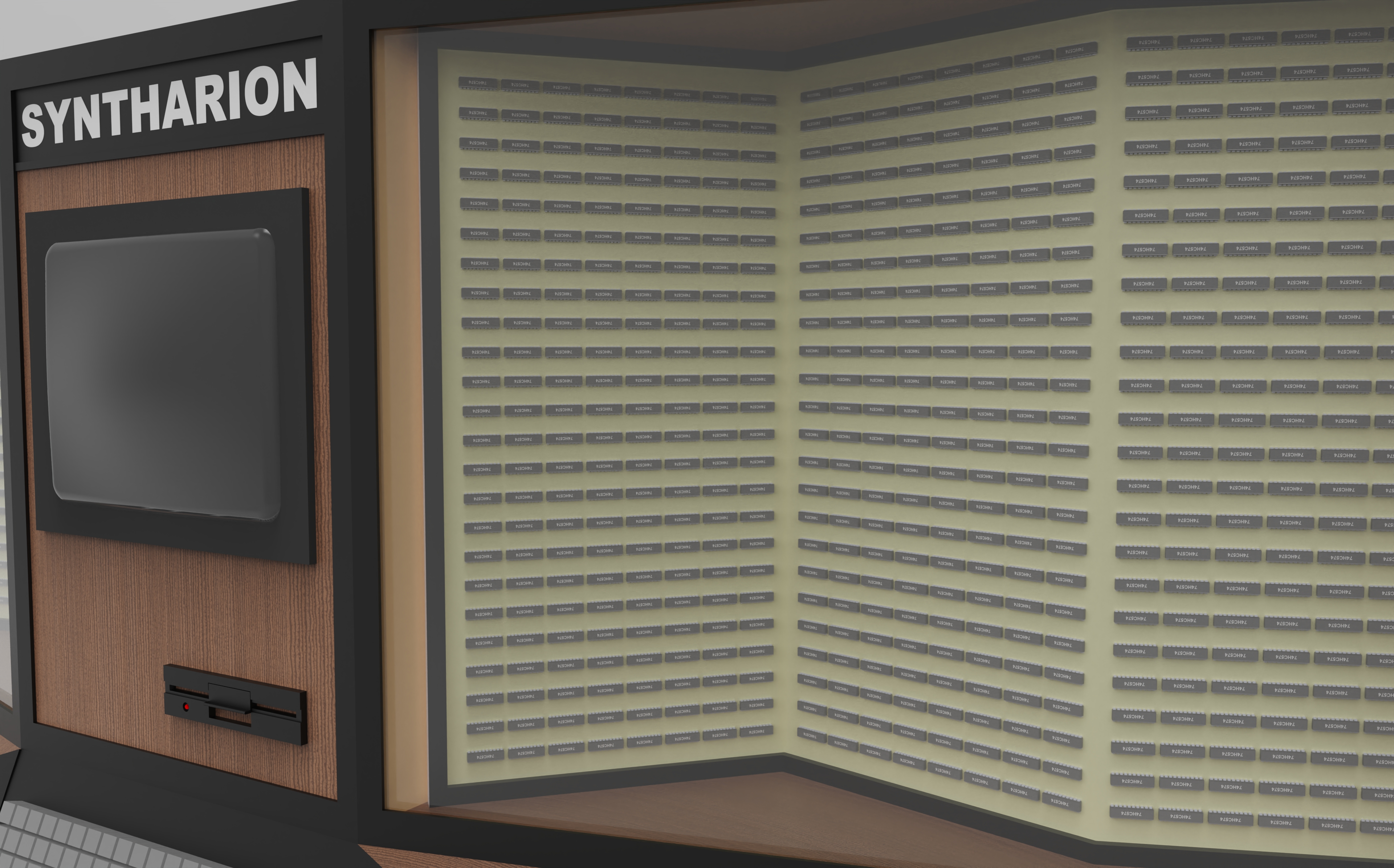

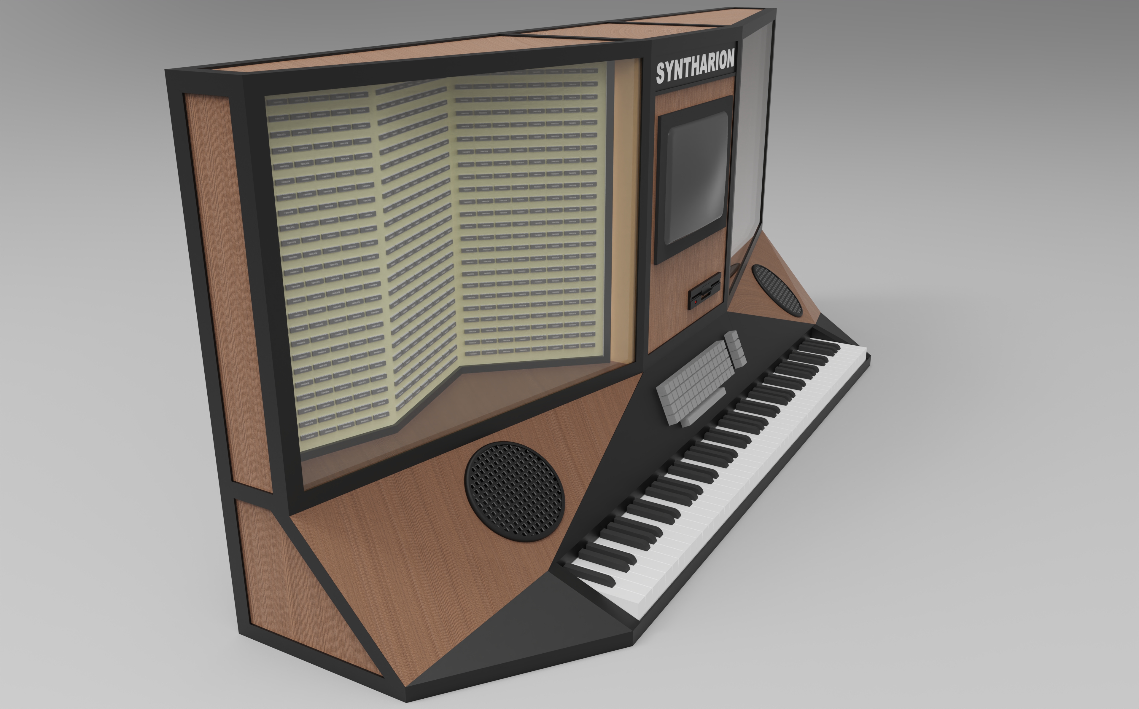

Here is a basic 3D model showing what I am working towards.
The CRT is a 12" mono like the PET, but brand new and white.
The computer keyboard is from a VIC, multiplexed by the main OS 6502.
The disk drive is a 1541, using the original components.
The piano keyboard is an 88 key unit also multiplexed by the OS 6502.
There will be a lot of other analog controls for mixing and FX on the black metal front panel as well.
The Huge PCBs are behind glass plates and will have cool backlighting and active LEDs on each of the 12 channels.

There are 6 massive circuit boards, each one 10 x 20 inches.
Most likely, the final hand wired boards will have 1000 or more ICs, all 74 logic and multiple 6502s.
I actually have all of the components already, so there is no going back now!
