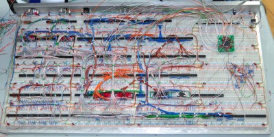

I received a few emails regarding this thread and the missing photos. I see that I accidentally used uppercase when I moved to my new server. Most of the images should work again now. Oh, and this project (and myself) are not dead, just altered somewhat!
I have been quietly working on the most ambitions project of my entire life for the last 3 years and everything preceding this post is just one small part of it - mainly some of the video circuitry. I didn't want to even mention anything as I had no idea that this insanity would even work until recently when I finally had some time to test out some of the core circuitry.
I can't stay long (so much work on the farm), but will say that this is still a 6502 powered project using only 1980 era logic components, but instead of a game system it is now a massive 16 channel synthesizer and track sequencer that will rival the Fairlight CMI of the same era.
There are currently 17 x 6502 CPUs on the board and almost 800 supporting logic ICs, all 74HC types. There are six main circuit boards, each measuring 10 by 20 inches, so a total of 1200 square inches of hand wired PCB space. I have tested most of the core system on my two massive breadboards, but they seem so small now and can only handle 2 of the 16 channels and the video circuit!
Here I go rambling on.... seriously, need to get back to work pal, keep it brief for now!

The video generator will be a derivative of the previous work shown here, using the very fast dual buffer system and blitting capabilities. The difference here is that the display is basic monochrome because this is required to display a razor sharp 80 columns of text and to draw the high resolution waveforms and envelopes.
Currently, I have enough of the OS also done so that I can jam out with 4 channels. No recording or tracking, but I can load samples (up to 256K per channel) from floppy disk. It is super exciting to think about what this synth will be able to do considering how great it already sounds!
Here is the video circuit on one of my huge breadboards. This is the smallest circuit in the project. The sound channels are 32 times this size for IC count.
