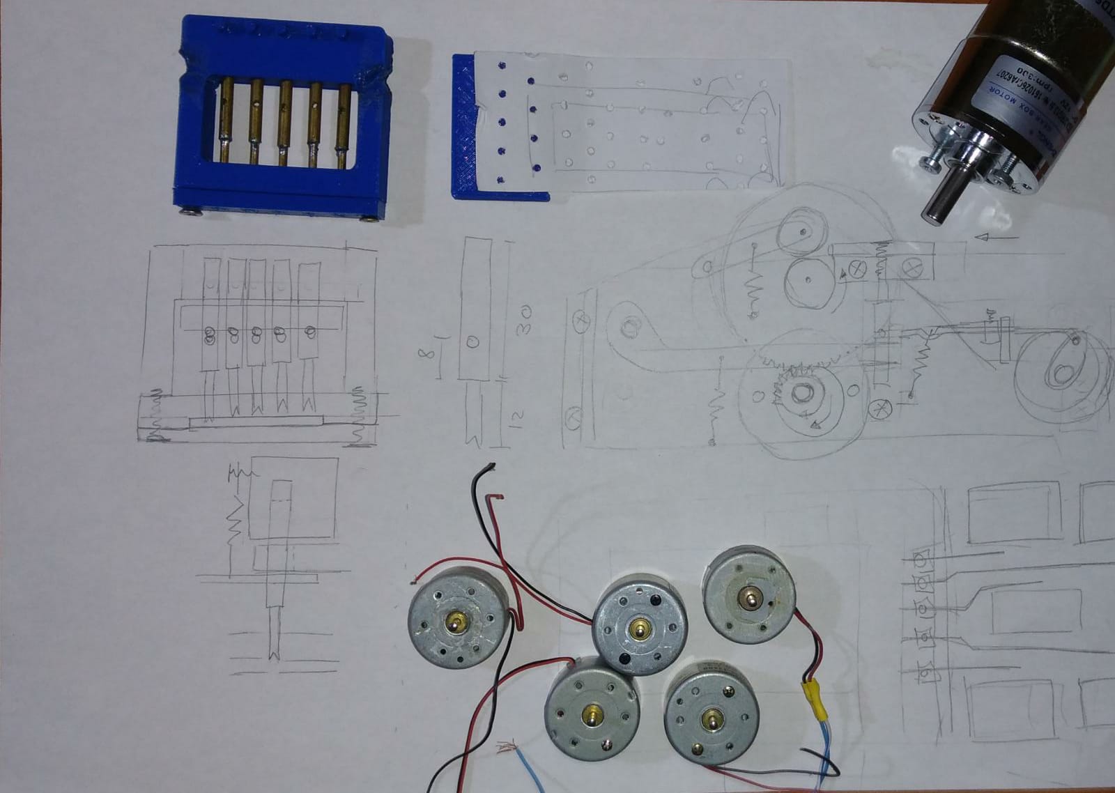

cjs wrote:
The punch, of course, is a bigger problem. I'm not really sure what to do about that. It's possible actually to print tapes (on clear arcrylic or perhaps thin paper), but part of the whole appeal for me is that with paper tape your physical media is quite sturdy, so long as it's stored reasonably. I don't trust toner to stay on paper nearly as much as I trust holes to stay in paper. And of course you can punch plastic or other more sturdy media if you really want to give your programs longevity.
Attached is a photo of some tests I did towards making a paper tape punch. The main idea was to have small pins all driven by a the same geared motor via a comb-shaped piece. Solenoids or small motors would engage each pin or not with said comb if a hole was to be punched or not.
Pins were made of brass, and their ends filed into a V shape sort of like office paper punches. I only built some test pieces. The blue ones are 3d printed. I think it could be made to work, of course, making the pins out of steel and the "cage" that holds them as well would be way better.
And yes, I did forget to add a way to put the pins inside the "cage". I just cut the cage in half and soldered it together again. That's what prototypes are for. :)
I abandoned the project as I didn't really see much use for it. An UART or an SD card interface seemed something I could get more use out of.
Just in case it inspires someone out there.
Juan

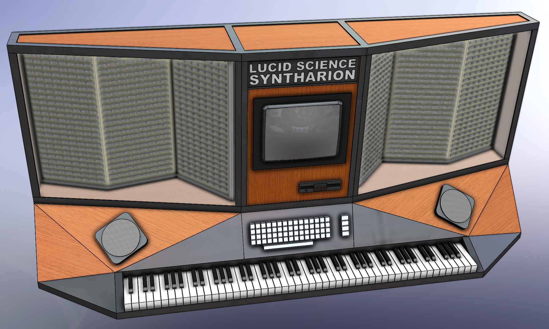

PostPosted: Fri Aug 23, 2024 4:43 am
Posts: 690
I received a few emails regarding this thread and the missing photos. I see that I accidentally used uppercase when I moved to my new server. Most of the images should work again now. Oh, and this project (and myself) are not dead, just altered somewhat!
I have been quietly working on the most ambitions project of my entire life for the last 3 years and everything preceding this post is just one small part of it - mainly some of the video circuitry. I didn't want to even mention anything as I had no idea that this insanity would even work until recently when I finally had some time to test out some of the core circuitry.
I can't stay long (so much work on the farm), but will say that this is still a 6502 powered project using only 1980 era logic components, but instead of a game system it is now a massive 16 channel synthesizer and track sequencer that will rival the Fairlight CMI of the same era.
There are currently 17 x 6502 CPUs on the board and almost 800 supporting logic ICs, all 74HC types. There are six main circuit boards, each measuring 10 by 20 inches, so a total of 1200 square inches of hand wired PCB space. I have tested most of the core system on my two massive breadboards, but they seem so small now and can only handle 2 of the 16 channels and the video circuit!
Here I go rambling on.... seriously, need to get back to work pal, keep it brief for now!
So the project is now called "The Lucid Science Syntharion Computer Music Station".
Built in 1980 using basic logic circuitry and multiple 6502 processors, this complete music workstation aims to go head to head with the Fairlight CMI, bringing more power and affordability to the aspiring musician. A partnership with Commodore has helped to keep costs down as the Syntharion now boasts a 640x224 display using CRT from the PET, a fast loading 5.25 disk drive using core components from the 1541, and a responsive keyboard from a VIC-20. An 88 key piano keyboard was custom made by Sequential Circuits. All other hardware is being developed in the secret Lucid Science lab.
Here are some very crude renders showing the hardware layout. Although dimensionally accurate, all of the user controls and final touches are not shown.
Notice the massive circuit boards displayed behind the glass windows. Backlighting and many channel status LEDs will bring everything to life.

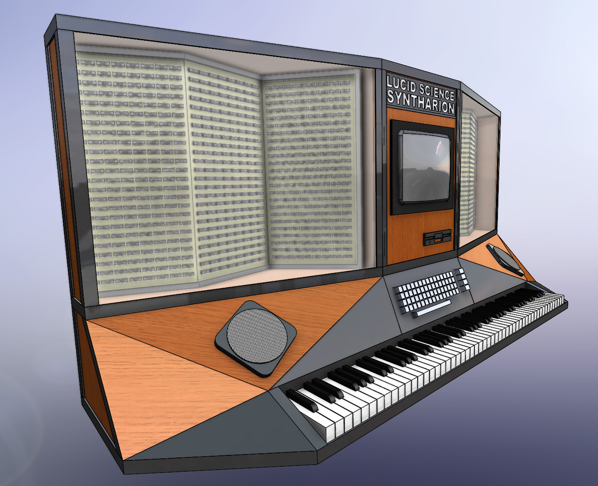

There will be mod wheels, full analog filters on all 16 channels, a spring reverb section, built in amplifier (possibly tube), and a very capable music tracker that focuses on live performance capture rather than boring keyboard editing of song data. A 6502 will power the OS and each channel will also have a 6502 to handle all of the 44Khz sample loading, playback and track data. Each channel is basically a fully functional synth on its own.
Those six 10x20 PCBs are perforated proto boards, and ICs will be hand wired point-to-point on the backside.
The video generator will be a derivative of the previous work shown here, using the very fast dual buffer system and blitting capabilities. The difference here is that the display is basic monochrome because this is required to display a razor sharp 80 columns of text and to draw the high resolution waveforms and envelopes.
