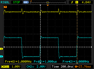

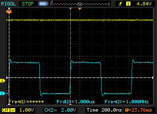

Let's see if I've managed to learn anything by trying to understand ground bounce / Vcc droop on a trivial clock circuit. The oscillator I have is a MXO45HS (datasheet attached). The test circuit shown in the datasheet is:

As ever, my understanding is weak but I am interpreting the mA and VM symbols to be "meters" - that is, not really in the circuit, but labels for the operating current and operating voltage. So the circuit I built started with just the oscillator, and not even the 0.01μF capacitor that is called for on the input side, and I didn't verify that my oscilloscope probes were under the capacitance required for the output but just assumed that was the case (if I am reading the datasheet correctly, for my 1Mhz oscillator the probe capacitance has to be below 50 picofarads). With the circuit in this state and channel 1 probing the voltage from the ground pin of the oscillator to its Vcc pin, the scope shows this trace:
Just the crystal
Just the crystal
With the 0.01μF capacitor across the power rails of the breadboard, the scope shows:
0.01μF
0.01μF
With an additional 1000μF capacitor from the ground rail of the breadboard to the power pin of the oscillator, the scope shows:
1000.01μF
1000.01μF
If I move the ground probe of the scope to be across the legs of the 1000μF capacitor, we get:
Measuring across the 1000μF capacitor
So, what does all this add up to in my updated understanding?
Initially, I was expecting the capacitors to make a difference to the voltage between the ground pin and the output pin of the oscillator. But they don't. The final image shows that the 1000μF capacitor is working, so the issue must be the reactance in the wiring and the breadboard between the ground rail of the breadboard and the ground pin of the oscillator - that is, even though the capacitors are trying to keep the ground at level, the reactance in the wiring is actually measurable on my scope, so that when the leading (edited) edge of the clock arrives the "inertia" of electrons arriving at the ground pin means they aren't coming in fast enough, and so the voltage between the ground pin and Vcc falls. Presumably the closer I can get the bypass capacitor to the ground pin of the oscillator, the more I can reduce the effect.
Does that explanation sound correct, or am I misunderstanding or misusing my oscilloscope?
Even if I am understanding correctly, the amount of bounce I am measuring across the device doesn't look significant. But, I could put the scope across other chips in my real computer circuit looking for traces where I am playing with the tolerances on the datasheets, and presumably capture a trace of ground bounce if it was in fact significant enough to flip a bit. Such a trace should be possible to capture when running the circuit at 4Mhz, which is the speed at which the computer currently fails ...

Your clock oscillator can undoubtedly has a power supply bypass capacitor in it.  ICs don't though, and their total load, if there are lots of outputs that can change at once (like a 74xx244 or '245 bus buffer for example) and each bit could feed a lot of other ICs (like at least one ROM, one RAM, and I/O ICs), the total load could be quite a bit heavier than what you have on the oscillator.  For example, if of the processor's 8 data bits, and 16 address bits, and a R/W line each had 20pF on them, that's 500pF.  Those will probably never all flip the same direction at once; but it's possible for most of them to.
Inertia is a practical analogy to think of the characteristic of an inductor, not the electrons.  The latter weigh hardly anything compared to the rest of the atom, and they move very slowly, even though a wave is propagated near speed of light.
I guess I don't understand then, because if there's a capacitor already across the power pins of the oscillator I wouldn't expect to be able to see the voltage oscillate on every clock edge - what are the internals actually like?
Posts: 8775
Re: Details on the W65C02S RDY / BE pins needed
Here's a very old one I have that's open.  (Pardon the cheap camera and poor lighting, as it's no longer daytime here.)  It's possible newer oscillator cans are different.  Maybe the manufacturers would have pictures on their sites.  The crystal had been attached to the two nubs you see there, but was removed to see the parts underneath.  The little black painted rectangles are printed resistors. The bypass capacitor appears to be the one at the lower-right, pretty well placed IMO, but there's still some distance between it and other parts.  At this point, I'm almost telling you more than I know.  I can make oscillators, but since proven-dependable ones are easily available, affordable, and compact, I have not made any effort to learn more about oscillators.  The power-supply "wiggles" in your pictures looks pretty minimal for a digital part though.
Thanks for the picture. Assuming they're all much the same, the internal bypass capacitor should make the effect I showed in the above screenshots almost invisible/impossible. So, perhaps unsurprisingly, it turns out my measurement was flawed.
Specifically, I had a short length of wire coming out of my breadboard to clip the ground leads of my probes to. Even that short piece of wire had enough reactance to show up on the scope. Doing it again with more care, probing closer to the breadboard, shows a near perfect situation around the oscillator:
Probing closer to the board.
And then, just to show how bad it can be when one isn't careful, I put a very long wire between the ground pin and the ground clips of my probes to get this "measurement":
Reactance of a long lead prior to the ground probe.
So indeed, as Garth said, the oscillator can is already designed with the bypass capacitor in place, and measuring these effects requires some precision as to how one probes the circuit.
