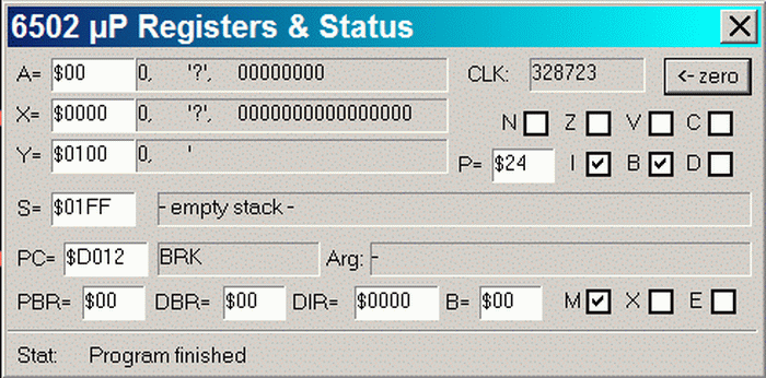

Regarding version 1.4.0.4, so far, so good with find-and-replace.  I haven’t done too much with it to date, but have something on which I will soon be working that will give the editor plenty of exercise and thus opportunities to crash following a find-and-replace.
In the assembler, I did discover that the PEA instruction is now broken; PEA #$1234 will fail to assemble and the error ERROR E006: Value doesn't fit in single byte. will be emitted.  PEA #$12 will assemble, however.
On a different note, I was fiddling around with 65C816 simulation while testing some code, which follows:
         sei                   ;(2)
         sec                   ;(2)
         xce                   ;(2) select emulation mode
;   short delay to illuminate the MCE indicator, if present...
         ldx #0                ;(2)
         txy                   ;(2)
init     inx                   ;(2)
         bne init              ;(3,2)
         iny                   ;(2)
         bne init              ;(3,2)
         clc                   ;(2) return to...
         xce                   ;(2) native mode
         rep #%11011011        ;(3)
         sep #%00100100        ;(3)
         brk                   ;(8) <—— stopped here
Numbers in parentheses are the cycles per instruction.
After running the above, the simulator’s MPU status window (below) was showing some confusing-to-me information:
    File comment: 65C816 Simulation Status
The P=$24 status register (SR) value is correct, but as can be seen, an erroneous ‘B’ flag is present and set, which SR doesn’t have when the 816 is running in native mode (B is replaced by x).  The e, m and x flags are as expected.
I'm trying to figure out what the ‘B=$00’ field is supposed to mean.  Also, the 816-specific register names are somewhat confusing; for example, ‘PBR’ if spoken aloud as words, would be “‘program bank register’ register,” kind of like saying “PIN number.”  :D  Also, it took me a moment to figure out that ‘DIR’ is referring to the direct page pointer; that should probably be ‘DP’.
The value shown for .Y is erroneous as well.  At the point where the program stopped, .Y would be $0000.  Also, it appears the clock cycle count is off.  Unless I'm missing something, the above code should have consumed about 1,638,400 cycles.  Live testing of this code in a ROM on POC V1.4 with Ø2 running at 1 MHz bears out my cycle count estimate.  The MCE LED (controlled by the MPU’s E output) stays illuminated for a little less than two seconds.
Other than the above, things seem to be working okay.

PEA will work for now as PEA !#1234. I have a fix for allowing PEA #1234 while causing the "value won't fit in a byte" error for LDA #300 and others.
The B bit is reflecting the Emulation mode status of Break. I left it to the user to know that when in native mode, that bit is not used, I could clear the check mark if you think it would be more clear?
B= $00 is the internal value of the B register ( upper 8 bits of the Acc ) XBA swaps this with A in 8 bit mode.
Yes, the DIR is the "D" Direct register. I didn't want to call it D as that would get confused with the D bit of the status register. I chose DIR. I will add something to the help system to describe the register definitions.
Something is amiss with the Y register. If you single step it past the loop, Y will be $0000. Only when changing the X bit in run mode does it return $0100. I should be able to find this and get it corrected.
It's possible the cycle counting is off... I made sure I had the right counts for each opcode, but may have missed some of the notes and exceptions regarding emulation mode timing. I'll dig into it when I get some time.
I'm glad to hear the rest of the program is working ok. Thanks again for the feedback!

I just ran a spreadsheet with the cycle counts.
Using the cycle counts you provided above in (), I came up with 328723 cycles, not counting the BRK. Can you post your calculations that brought you to 1,638,400 cycles?
Here's mine:
pre loop    10 cycles
X loop   (255 * 5) + 4 = 1279    -> loops 255 times with 5 cycles per loop plus last loop does not branch and uses 4 cycles.
Y loop   (255 * 5) + (255 * 1279) + 4 = 327424   -> loops 255 times with 5 cycles per loop plus the full X loop done 255 times plus 4 cycles on the last loop.
post loop   10 cycles
10 + 1279 + 327424 + 10 = 328723.
Assuming this is your RESET code, is it possible the E LED illuminates during RESET and that the RESET line is being held low for 1.3 seconds?
