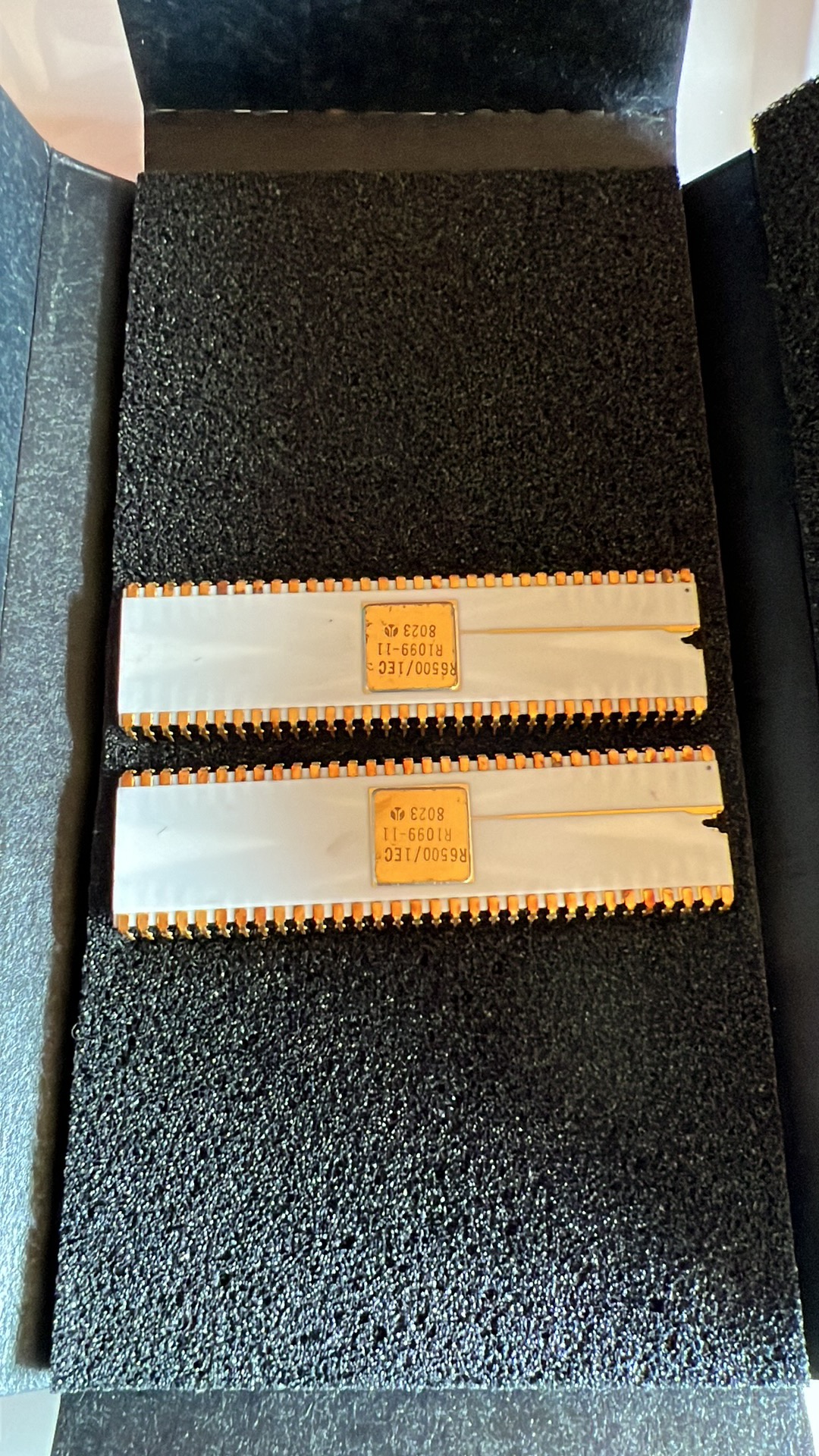

I found a couple of photos of the 6500/1's I have. The ceramic chip is a, rare for Rockwell, 64-pin ceramic chip that brings out extra pins for an EPROM for development. However this is not suitable for emulating in place. For that Rockwell had a piggyback package, shown in the other photo.

File comment: 64 pin ceramic chip
