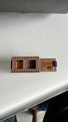

I think they were the first 6502 based microcontrollers, but really at that time a 6502 with a 6532 was a good option, and a TIM monitor for development. For hobbyists it didn't really get useful until EPROM based microcontrollers became available, but really Rockwell did have some good development options. I've no idea how much they cost, they were probably expensive.
I found a couple of photos of the 6500/1's I have. The ceramic chip is a, rare for Rockwell, 64-pin ceramic chip that brings out extra pins for an EPROM for development. However this is not suitable for emulating in place. For that Rockwell had a piggyback package, shown in the other photo.
File comment: Piggyback chip
