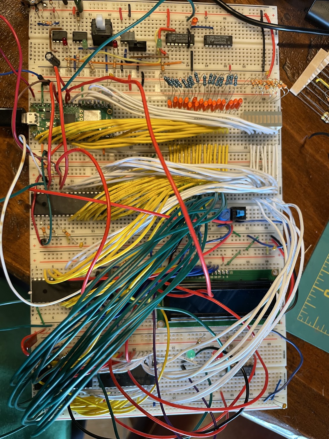

ASPEN32 wrote:
So...I got another beginner's project (maybe a cheater's...) idea I'd like to implement using at most (or as little) as 2 or 3 chips - a 6502 mated with a Raspberry Pi Pico. Here's what I'd like to design...

I see you have plenty of answers of the form "Google is your friend" but as I started on basically the exact same path as you I thought I could share my experience.
Inspired by Ben Eater's videos (and later disappointed to discover that Garth wasn't credited for the core design ideas) I thought I'd start with a Pico W on a breadboard wired to be a semi-permanent in circuit debugger for the 6502 bus. The Pico W has GP0 - GP15 in order and this makes for very easy setting or inspecting the address bus; like you, I'm most comfortable in C but the micro python environment makes getting in and poking at the device so easy that it was worth learning micropython on the fly to be able to program the computer.
So to get started, I made a file named `bus.py` to make it possible to inspect the bus, and the address code looks like this:

So this lets you read the 16 GPIOs that make up the address bus in one shot. The next 8 GPIOs are not sequential, so you have to shift the high bit into place for the data lines (that's why the data mask is defined as 0x7F0000 | (1 << 26)):

Armed with just these two functions you can snoop on the data bus. I don't know if the Rockwell chip you are using will work properly with the clock halted, check your datasheet. The chip I have will patiently await the clock edges and I start with the clock low and wired to GPIO 28.
For better or worse, that accounts for all pins available on the Pico W design. For me, this is an asset that will stop me building too much functionality into the pico itself; it can respond to the bus and deliver "RAM" to the computer, but I'm not even doing that with it anymore. However back at the start, I had just the 6502 on the bus plus the pico, and had the pico serve up small programs on $FF00 by simply embedding and array into the micropython code and returning those values to the bus when the CPU read out of that address range. This enabled wiring up the 6522 VIA and a two line display to see that everything was working, before adding any ROM or RAM to the system.

This produces a cycle counter, address, read write flag, and data bus monitor line for each tick of the clock. To change the clock to Pico control (I found early on I preferred to have a debounced button wired to pin 28 rather than software driven clock), you need something like this:

It ought to be possible to use the code as given with the pico wired to the address and data bus, the R/W signal wired to GPIO 27, and the clock wired to the CPU's clock. Hope that's helpful.
Edit: I forgot to say that the command line I use to get into the REPL is
mpremote connect /dev/tty.usbmodem1101 mount . run bus.py repl
and this drops you into a python REPL where you can then call the functions above at the >>> prompt.

...I don't know if the Rockwell chip you are using will work properly with the clock halted, check your datasheet.
All CMOS versions of the 6502 will tolerate the clock being stopped in the high phase, which is a viable method of wait-stating the MPU to accommodate slow devices—my POC V1.3 unit uses this method.  Only static-core versions of the WDC 65C02 (and 65C816) will tolerate the clock being stopped in the low phase.  Note that the S in the current-production W65C02S6TxxG-14 WDC part number means “static core” (the xx field identifies the packaging).

In this case the OP ought to modify the code to set the clock pin high when bus.py is loaded and change step to step down and back up rather than the way I have it, and it ought to work with the proposed chip.
For myself, the next step is to configure a. pico to drive VGA or monochrome monitors using the PIO capabilities, with the goal of doing DMA out of the RAM chip for the 6502 to create a simple text mode display for the computer. If I have problems I'll post about that in a new thread; I did look at Garth's site but it mainly had pointers to other content for video and I didn't immediately find a model to follow ... I think this is simple enough to do it from first principles (famous last words? we'll see).
P.S. Added an attachment similar to the linked photo; I noticed that img tags were turned off but didn't take the time to think about why that must be, sorry.

The third-to-last diagram on the clock-generation page at http://wilsonminesco.com/6502primer/ClkGen.html and the description in the paragraph above it might be what you're looking for.
