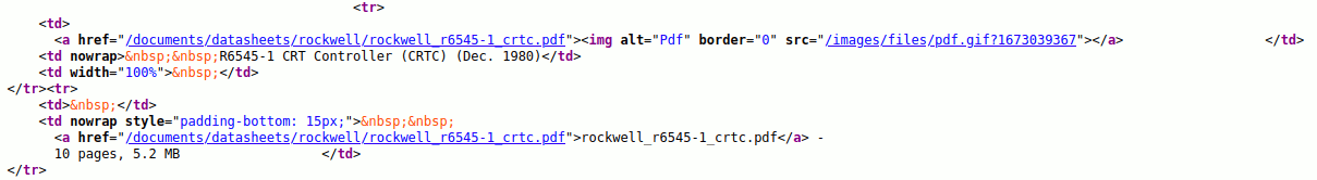

fachat wrote:
But if you click on them they end up in the internet archive.
Not sure if all of them but many.
The one I tried yesterday was the Rockwell 6545-1, but I've seen others before.
I clicked on it, and the .pdf came up, without going to the internet archive.  So then I did a <Ctrl>U to see the page source, and took this screenshot of the part about the Rockwell 6545-1:
As you can see, there's nothing there to refer to archive.org, or to anything outside 6502.org.

PostPosted: Tue Jun 25, 2024 6:06 pm
Site Admin
Posts: 281
Location: Northern California
fachat wrote:
I've recently noticed that the links in the datasheet archive section of 6502.org seem to point to the internet archiv web.archive.org.
I understand that this could be a measure to reduce bandwidth, but is this true, is this permanent?
No, this is not intended to be permanent.
In the Git repository for the website, I have a SQLite database file which maps all of the PDF files in the documents archive to known-good copies on archive.org. I originally did this so that the website can be run locally or can be recreated if something happens to me.
A few months ago, we were having problems where the entire documents archive was being downloaded frequently. The downloaders would sometimes put so much load on the server that the forum became unusably slow. Blocking IPs didn't help because whenever I blocked some, the bulk downloading would start again from new ones.
