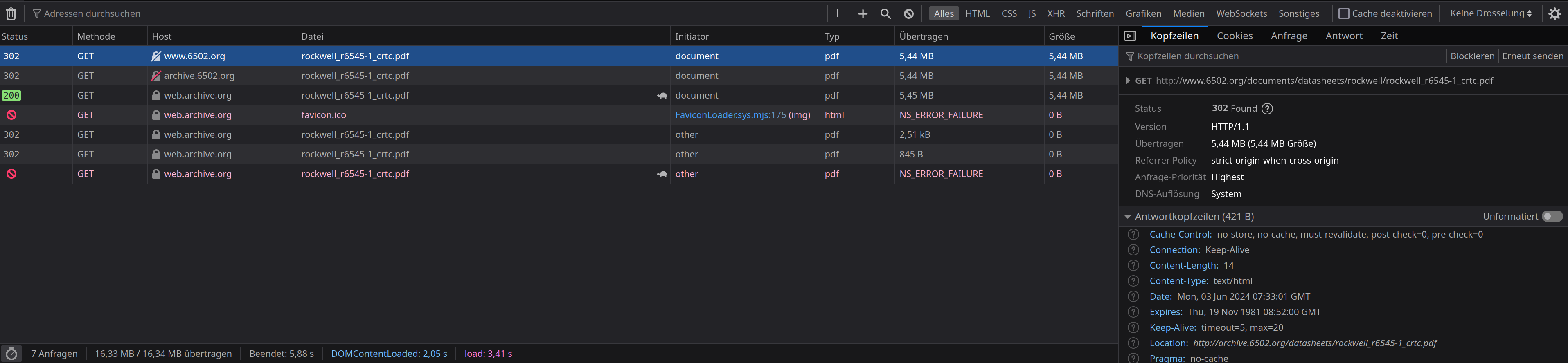

Re: Doc archive links pointing to web archive?
Ok, I tried it on the PC again, tracing the web access. See screenshot.
P.S.: interestingly the actual PDF seems to be included in the original response, and even two responses from the internet archive. So my browser loads the actual file three times...?
The transferred number of bytes indicate this, as well as clicking on the "response" tab in the browser console, where all three requests with >5MB get a long encoded (base64?) response string.
Oh, the wonders of the modern web...
Two of those accesses are 302 - I think they are redirects. The size of the PDF is in the header, but I don't think the PDF is downloaded each time. Might be worth looking a little deeper.
I tried this. I tried to get the link pointing to the Rockwell 6502, 2nd link on:
http://archive.6502.org/datasheets/rock ... essors.pdf
This sends me a redirect to
http://6502.org/documents/datasheets/ro ... essors.pdf
and that sends me a redirect to
https://web.archive.org/web/20221112220 ... essors.pdf
So someone/thing has intentionally created this archive of 6502.org over on archive.org and altered the server to redirect requests to archive.6502.org which forwards to archive.org....
fachat wrote:
I've recently noticed that the links in the datasheet archive section of 6502.org seem to point to the internet archiv web.archive.org.
I understand that this could be a measure to reduce bandwidth, but is this true, is this permanent?
In the Git repository for the website, I have a SQLite database file which maps all of the PDF files in the documents archive to known-good copies on archive.org. I originally did this so that the website can be run locally or can be recreated if something happens to me.
A few months ago, we were having problems where the entire documents archive was being downloaded frequently. The downloaders would sometimes put so much load on the server that the forum became unusably slow. Blocking IPs didn't help because whenever I blocked some, the bulk downloading would start again from new ones.
