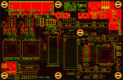

As for PCB cost, ditto on what Gordon noted.  I can recall when getting custom PCBs made ran into four figures (USD).  In the early 1990s, I had some PCBs made for a custom host adapter, in two layers and about the size of a credit card.  Five PCBs cost $450 to produce, plus a one-time setup charge of $150.  Even as recently as 2003, when I was building modules for a large-scale model railroad automatic block signal system, I was paying the equivalent of around 15 USD per PCB, and those were only two-layer boards!  Current prices are a real bargain, even for multiple layers.  It costs more to ship PCBs from JLCPCB to the USA than to have them made.
As an aside, should I need PCBs with Underwriters Laboratories recognition, I deal with a US-based board house.  Although their prices have plummeted in the last 10 years, they are about five times as expensive as JLCPCB, despite substantially lower shipping costs.
File comment: POC V1.2 PCB Layout
Above is what POC V1.2’s PCB layout looks like.  This was the last unit I built with PDIP glue logic parts.  It’s not as dense as it could be, mainly because I habitually leave room for adding bodge wires in case I want to fix or change something in the logic.  However, it’s dense enough to run at 20 MHz with some timing headroom remaining.  Signal traces are 0.006" width, using .026"-diameter via with 0.008" holes. Center-to-center signal trace spacing is 0.025" in the densest areas.

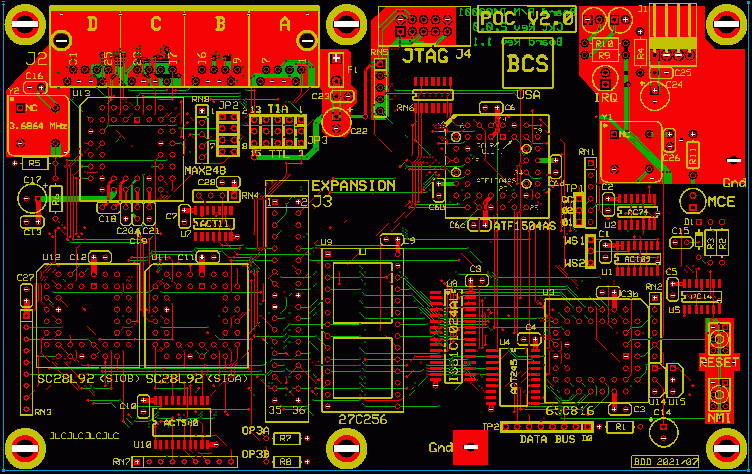

File comment: POC V2.0 PCB Layout
Above is the layout for POC V2.0.  Most of the glue logic is in an ATF1504AS CPLD.  Again, I left room for doing some bodge wiring...just in case.  :D

JLCPCB design rules are 6 mil trace and 6 mil space. Your vias can be 30 mil pad/16mil hole. With that kind of design rules, you can pack DIP shoulder to shoulder, even put 300mil under 600 mil DIP and your router still can do it in 2 layers. So if you are doing 4-layer with power/ground planes (why not, it is so cheap) just absolutely packed your components next to each other’s and watch the router does it’s magic. My CAD is 25 years old and never updated (can’t, company was out of business in 2003), even that old router can do everything I said above. The latest router must be able to do it better.
With sufficiently fast RAM, W65C02 can reliably run 25Mhz. Don’t need slow ROM, you can bootstrap out of fast ROM in CPLD or 22V10.
Edit, just read BDD’s comment. His via is 26 mil pad and 8 mil drill. Very cool. I picked 16 mil because a 30 ga wire wrap wire can insert in the hole making bodge easier.
