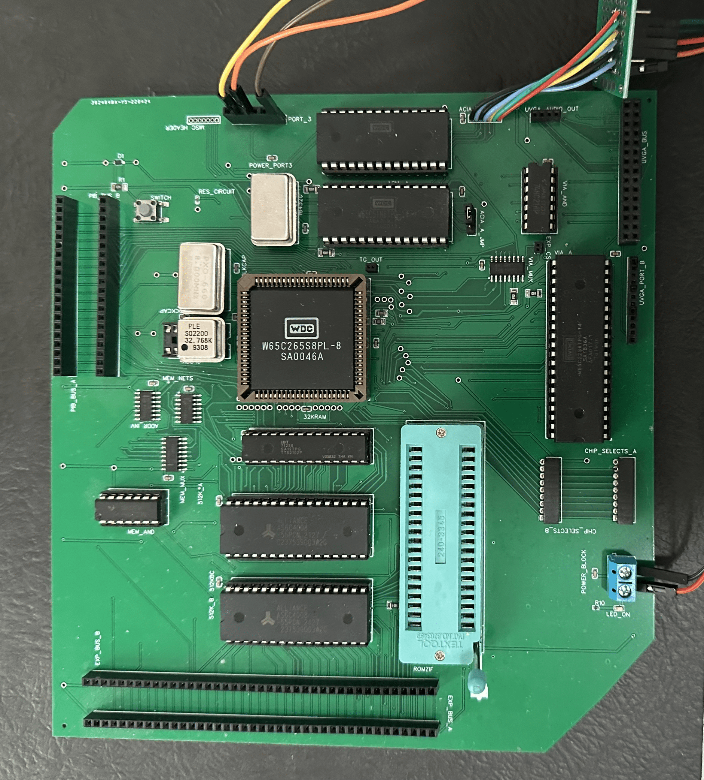

PostPosted: Tue Mar 19, 2024 4:29 pm
Joined: Sun May 30, 2021 2:16 am
Posts: 374
Proxy wrote:
so what size were you trying to do that it got to expensive for you?
This guy, here :lol:

PostPosted: Tue Mar 19, 2024 5:38 pm
Posts: 746
Jmstein7 wrote:
This guy, here
yea you can definitely squeeze that down by a lot!
one option: you could try to be lazy like me, in your CAD program put all the ICs on the board with around 200-300mils of space between them, make sure the ratsnest isn't too bad, and then let an autorouter like freerouting do the rest.
and if you're wondering about the quality of the routing job, let's just say that both my 65816 and 65C02 boards run at ~20MHz and 99% of the routing was done by the autorouter.

PostPosted: Tue Mar 19, 2024 5:50 pm
Posts: 1080
I just sent out 4 designs to JLCPCB, all 100mmx100mm, 20 4-layer boards, 5 2-layer. DHL shipping, $60 total. They all have CPLD which is critical in reducing board size, so are SMT package. Also pack your board as tight as the auto router will handle, and combine multiple designs in one order. This is 100x100mm 68040 with CPLD at back and TQFP-80 quad serial device.
