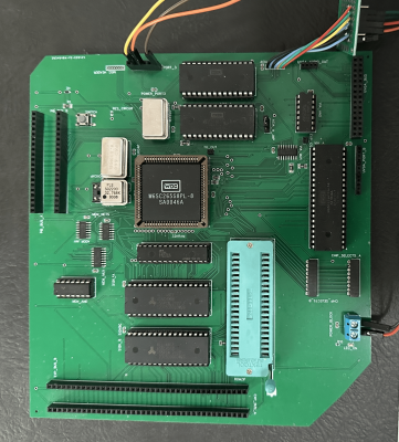

Proxy wrote:
so what size were you trying to do that it got to expensive for you?
This guy, here :lol:

Jmstein7 wrote:
This guy, here
yea you can definitely squeeze that down by a lot!
one option: you could try to be lazy like me, in your CAD program put all the ICs on the board with around 200-300mils of space between them, make sure the ratsnest isn't too bad, and then let an autorouter like freerouting do the rest.
and if you're wondering about the quality of the routing job, let's just say that both my 65816 and 65C02 boards run at ~20MHz and 99% of the routing was done by the autorouter.
Ha! I'm struggling to get past 8mhz! And I'm using 55ns Flash Rom, as the EEPROMs I was using didn't get below 100ns; but, everything is hand soldered. What RAM and ROM are you using to get to 20mhz? I didn't know it was possible to get past 14mhz, or so.
As to autorouter, what does that workflow look like? I HATE routing manually. Hate it. It takes me forever, and I'm always guessing with trace sizes and VIAs and all that. I've also only used double layer PCBs.

PostPosted: Tue Mar 19, 2024 6:47 pm
Joined: Fri Jan 26, 2024 5:47 am
Posts: 40
Location: Prague; Czech Republic; Europe; Earth
Yes, I too use KiCad and autorouting - first I try, if it is even possible to route it somehow, then I move the chips around, if I think it could help, then, if I have something in my mind I route it manually (like some bus) and then I let autorouter do the rest.
And then I improve anything I can spot.
Basically artefacts from first phases of routing - strange shaped wires near pads. And aligning corners, setting equivalent distancies between wires and sometimes also changing trace of too long wires.
It is more like cooperation :)
And I save each step to reload instead of undo.
