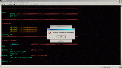

Discovered another “oops!” in the assembler.
The attached image show the assembler “stuck” in an error condition due to a line of code having a typo in it.  The line in question has a red arrow pointing to it in the left margin and the error is two invocations of the res (“reserve”) macro.  By “stuck,” I mean the only way to clear this error is to kill the assembler from the Window$ task manager.  Clicking the OK button endlessly reiterates the error.  Fortunately, I had saved the source file before assembling...
File comment: Kowalski Assembler Stuck Following A Fatal Error
Last edited by BigDumbDinosaur on Fri Mar 15, 2024 5:28 am, edited 2 times in total.

Ok, I'll try to look at it this weekend.
I'm glad you didn't loose your work.
Daryl
I've gotten in the habit of saving all “dirty” files before assembling or performing a search-and-replace, since the latter has gotten me numerous times.
