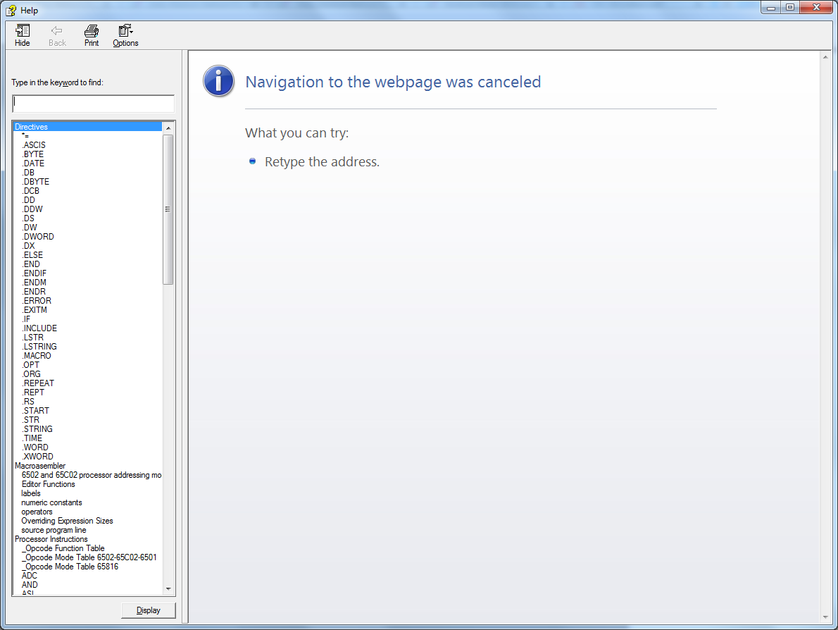

Is any documentation available?
HTMLHelp does not work after Microsoft killed Internet Explorer.
There is nothing on https://sbc.rictor.org/kowalski.html

Hi Bill,
The HTMP Help still works on my Windows 10. Are you saying it does not work with newer versions of Windows?
I have no other documents to share. I did find this folder using Google, which contains some basic documentation.

This is what I get when I try to view help:
According to this:
https://learn.microsoft.com/en-us/troub ... r-properly
The .CHM is blocked because it was downloaded from "an untrusted source."
After unblocking in Properties, it now works.
Who is the jackwagon who decided to enable magic powers a black hat can exploit IN A HELP FILE of all places?

I'm glad you found the solution. I'll write up some instructions for fixing that for others and add it to the web page.

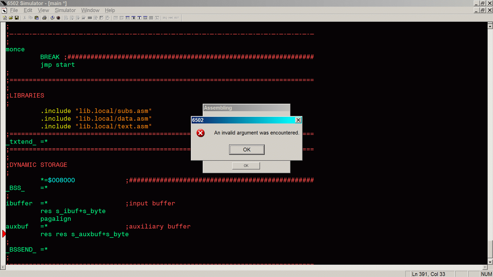

Discovered another “oops!” in the assembler.
The attached image show the assembler “stuck” in an error condition due to a line of code having a typo in it. The line in question has a red arrow pointing to it in the left margin and the error is two invocations of the res (“reserve”) macro. By “stuck,” I mean the only way to clear this error is to kill the assembler from the Window$ task manager. Clicking the OK button endlessly reiterates the error. Fortunately, I had saved the source file before assembling...

Ok, I'll try to look at it this weekend.
I'm glad you didn't loose your work.
Daryl
