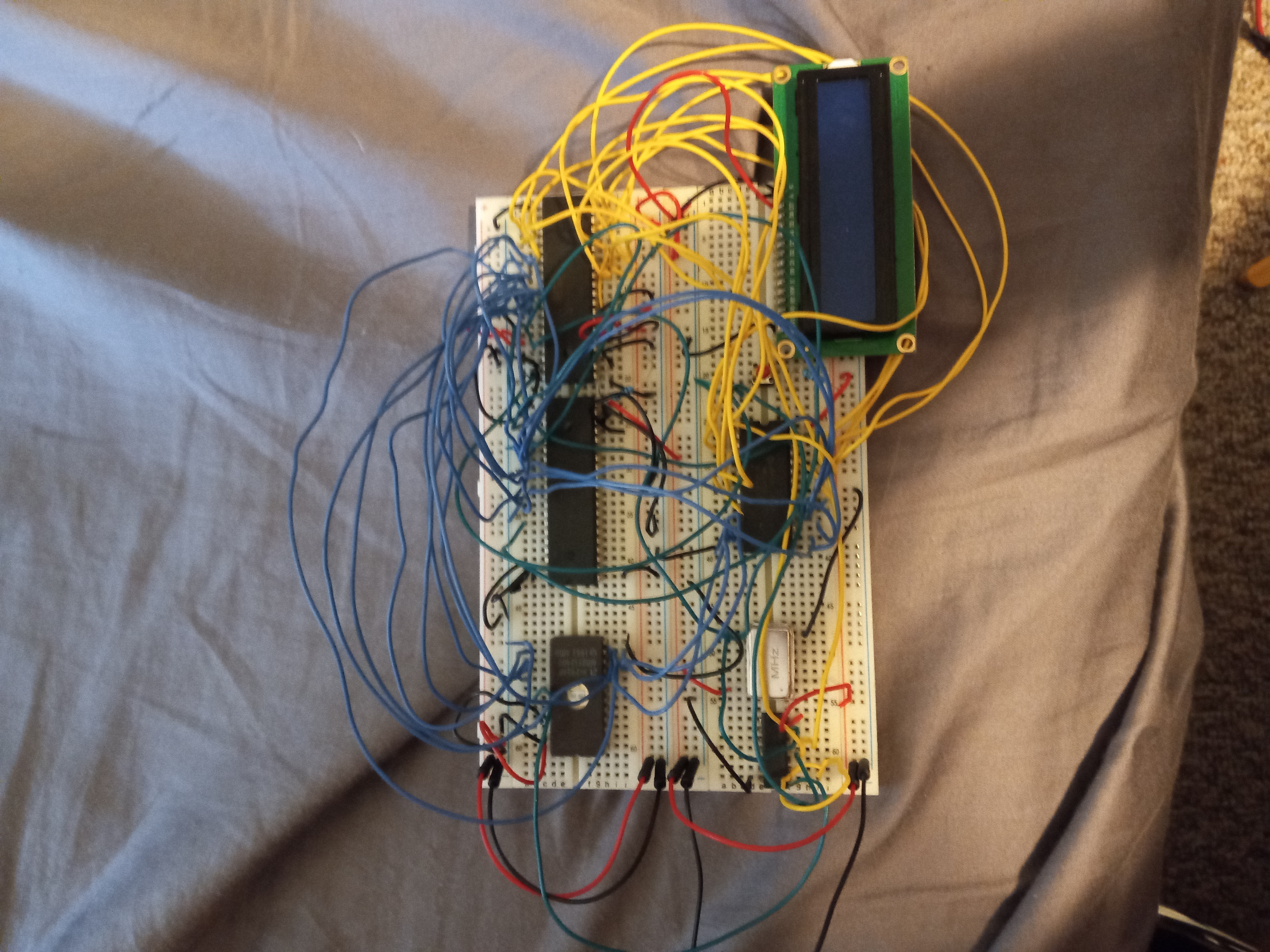

alright so here's the situation i have loads of yellow wire that is mildly too short and already cut and stripped and no uncut yellow wire. the issue is i still have around 20-30 yellow wires to hook up and i'm not sure if its a good idea to tie the wires together considering ben eater was so worried about the spare electricity with much cleaner and better wiring and a higher quality breadboards.

I'm generally of a mindset that you'll find it much easier to trace things if you keep the wiring neat and tidy. I spent a good deal of time cutting wire to exact lengths in my Eater like setup.
I recognize that might be too fiddly for some, but I would at least suggest keeping like with like and tying them together. I also recommend settling on a given color of wire for a specific purpose if you can. For me yellow are address, blue is data, and green are control signals for example; I found this was a big help in troubleshooting things quickly.

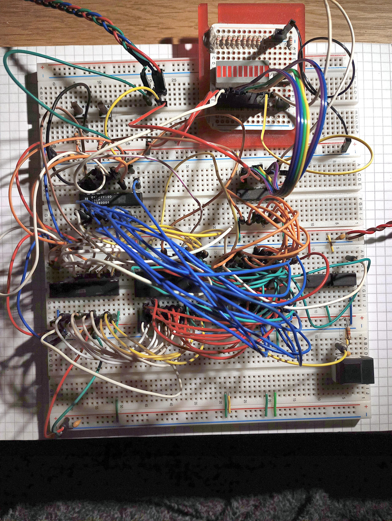

Keep it neat and tidy if possible - that's going to be the biggest issue on breadboards with flying wires like that.
But with that in-mind, this:
Was my project for last year and it ran just fine at 2Mhz.

One thing to add about my last project - I used different coloured wires for different purposes. That really helped me.

One thing to keep in mind, when you have a lot of long wires like that bundling them together can increase the risk of cross-talk. (That said, Radical Brad didn't seem to have any problems with his big bundles of very long wires. Then again, he used a lot of buffers.)
