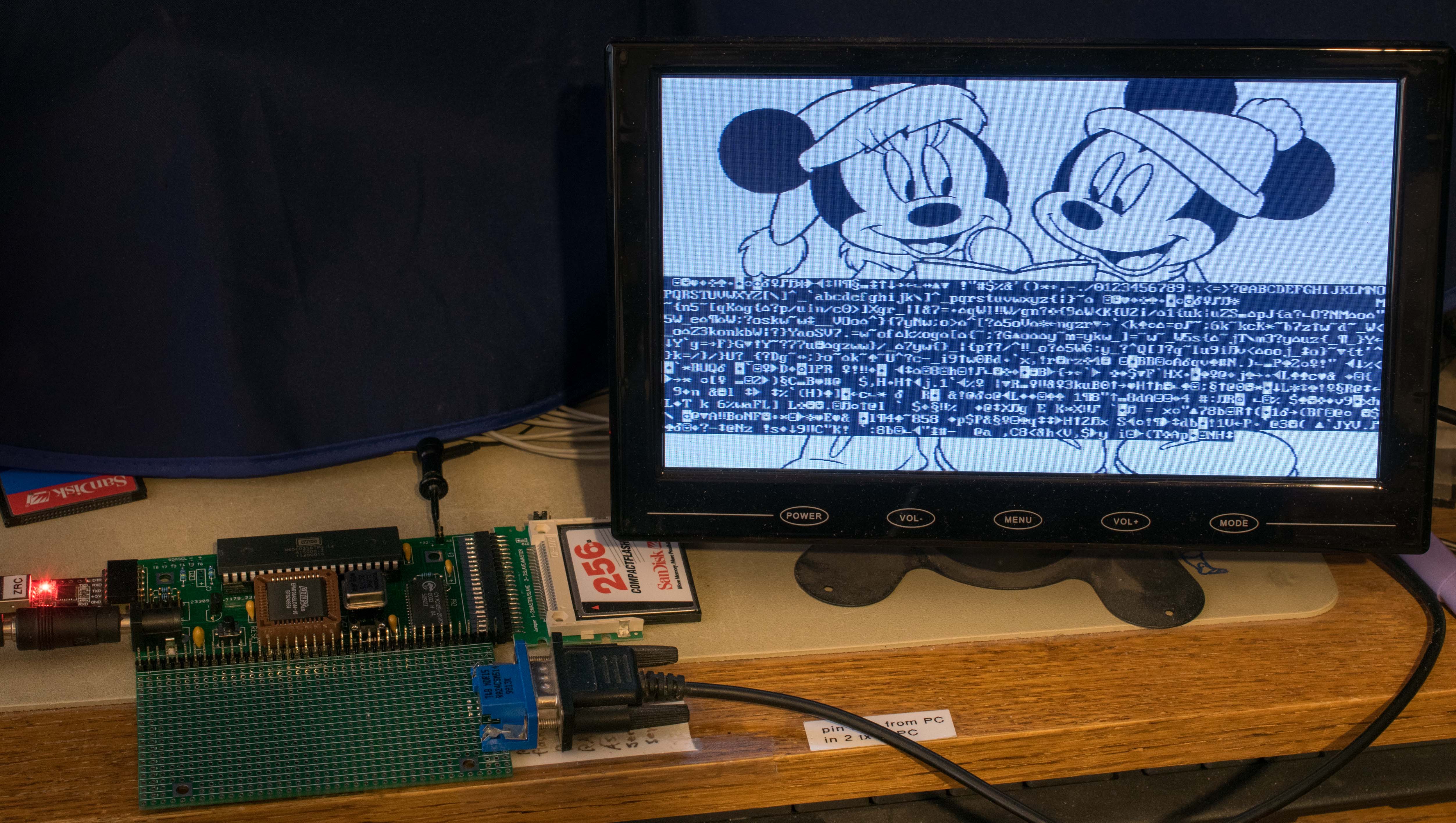

Returning to this topic because I've learned a few tricks in the last few years and it is slowly dawned on me that I can trade speed for hardware complexity. W65C02 can run reliably at 25MHz so it is time to take advantage of that capability to reduce the complexity of hardware.
In my first attempt with VGA beam racing, I wanted a capable serial port but had to sacrifice the CF function to fit the logic in the small CPLD. The idea now is to simplify the serial function to the simplest bit-bang implementation and keep the CF function. In fact, the plan is to expand the memory to 2 banks and find a way to have PS2 keyboard function as well. I can have it all if I keep it simple but paid with degraded performance and more memory.
Enough about ideas, here is what's possible: CF interface, 640x480 VGA, bit-bang 115200N82 serial and possible PS2 keyboard. The modifications to the existing CRC65 is minimum, most of the changes are in the CPLD which is 77% utilized and there is one spare pin to drive 2nd bank of memory.
It still takes 90% of CPU and 40K memory to paint the 640x480 screen. Swapping in 2nd bank of 40K should alleviate the memory shortage. I have to work with the remaining 10% of 25MHz 6502, or a 2.5MHz 6502.
CF can supply the graphic files instead of uploading them serially. I'm exploring different fonts right now. It seems to me 30 rows, 80 columns of 8x16 fonts is a good fit.

PostPosted: Thu Jan 11, 2024 12:04 am
Posts: 718
Looks really good! It's cool to see you running this at 25 MHz, wow! And having a 2.5 MHz equivalent CPU as 'left over' is still plenty fast to run additional software.
So what are your future plans with this now?

PostPosted: Thu Jan 11, 2024 12:48 am
Posts: 1117
I still have one spare pin and 20-25% spare logic in CPLD. I'm thinking of 2nd 56K memory bank with 8K of common area. I also want to add a PS2 keyboard but I'm out of I/O pins so I may share it with the serial port with a toggle switch which is pretty crude. CPLD has 4 JTAG I/O pins that can serve as user I/O, but I had not tried that ever, because the CPLD can't be reprogrammed anymore. However, GlennSmith recently posted an excellent write-up about restoring JTAG functions. I need to investigate that--still learning about CPLD after 30 years!
I have a very similar 25MHz Z80/RAM/CPLD board, so it also occurs to me I can beam race Z80 as well. In fact, I can design one pc board that accommodate both 25MHz Z80 and 6502 similar to BB6580, except it can do graphic.
Software-wise, I have a monitor already, but I am following your path of editor then high level language, probably Forth. Lots of projects to keep me off the street!
