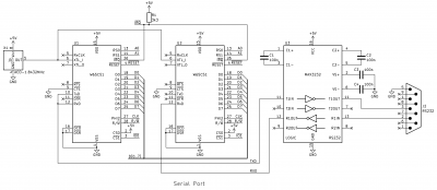

Thank you for taking the time to look and offer such helpful feedback. I'll tie DCDB and DSRB permanently low. CTSB too, for the time being. It would be nice to be able to use CTS/RTS eventually but that's some way away. I've noted your points about IRQB, removing the diodes and reducing the value of R1.
gfoot wrote:
One thing to check perhaps is the exact timing. I have a feeling the receive interrupt fires halfway through the stop bit, which might be too soon to send the next byte.
Thanks, George. This ties in with BDD's final point about providing a delay in the link between pins 10 and 12 of U1. I only have the WDC datasheet to work from and it doesn't give that kind of information, so I'm going to measure it myself. I've been sketching out the software this morning but I realise Christmas is hurtling towards me so I'll have to take a break from it soon.

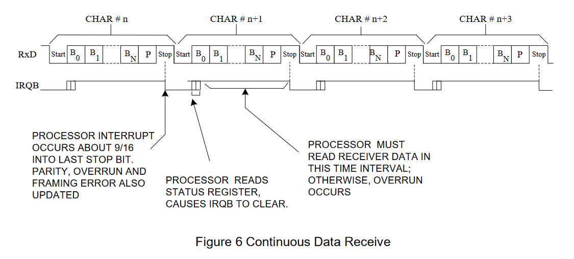

This datasheet shows on page 16, figure 6, what continuous receive looks like, and states that the receive interrupt occurs 9/16 of the way through the last stop bit.
One way to delay this more or less in software would be to configure the dummy reciever to expect two stop bits rather than just one - then this interrupt will occur after about one-and-a-half stop bits, when it's already safe to write the next character to the other ACIA straight away without clobbering anything.

Thanks George. That's a much more comprehensive data sheet than the one currently available from WDC's site (dated August 21, 2021). I'll implement your suggestion, which means I'll have to revert to using the Rx part of U2 as the dummy and, no doubt, confuse myself in the process!

I would still link RX and TX on one ACIA used for transmitting, with 8-N-2, and use the other one for receiving with 8-N-1 - also configuring the other end of the line to 8-N 1 as usual. I don't think it will work the other way around as the receiver would be expecting 8-N-2, so you'd need to configure the other end of the line as 8-N-2, and then you'd also need to transmit 8-N-2 but you're back to square one as you might be truncating those two stop bits a little. Overall you need the line to be principally configured as 8-N-1, though you'll send slightly longer stop phases in practice.

The attachments show where I am at the moment. None of this is tested yet and the code isn't complete so it isn't ready to assemble, but it should show where I'm aiming. I'm going to have to put it to one side for now because I'm under pressure to return to the real world for a while!
- John
