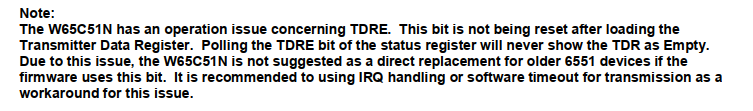

Re: Working around the W65C51 transmit buffer empty bug
BillO wrote:
The interrupt doesn't fire either as it relies on the flag. So, no there is no way around the wait loop.
The most recent WDC datasheet has removed that note.
[EDIT]After re-reading this I realised my comment is ambiguous. I'm not doubting you, I'm implying WDC are a bunch of palookas for their datasheet content.[/EDIT]

You cannot use any interrupt processing with the WDC 65C51 because the stuck “transmitter ready” bit will result in a continuous IRQ, which would deadlock your machine. You are forced to use PIO, which is a royal pain, to put it mildly. Or as Ed noted, “is a bit of a spanner in the works.”

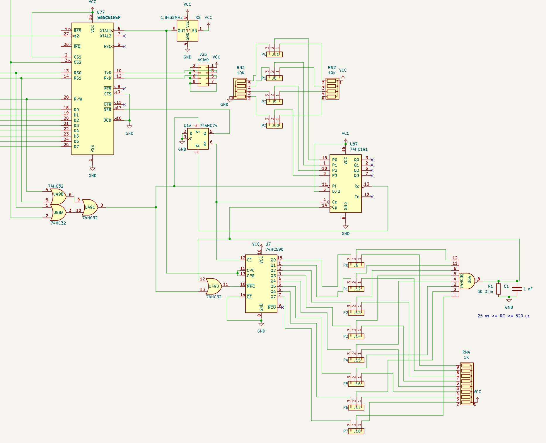

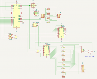

Here's what I would like to try. It's the same approach as using the PB6 counter on a VIA, but without the VIA: I use a 74HC590 binary counter cascading into a 74HC191 binary counter, with a 74HC74 flip-flop driving DSRB high ("not ready") whenever the CPU writes to the data transmit register (register 0). The same signal that sets the flip-flop also resets both counters. The 74HC191, the "high order" counter, is LOADed with whatever countdown value has been entered into jumper blocks, and the inverse output from the flip flop enables both counters. The high order countdown value should be the number of bits per transmitted byte, e.g. 0x1010 == 10 for N,8,1 line discipline.
A jumper block is provided to allow setting of the bit pattern on the low order counter which will result in a cascade to the high order counter, and a reset of the low order counter. This should be set to the ratio of the crystal frequency to the baud rate, i.e. 0x01100000 == 96 for a 1.8432 MHz crystal and a baud rate setting of 19200. Finally, when the high order counter hits zero, its ripple carry output goes low. This resets the flip-flop, which brings DSRB low again ("ready").
The 6551 datasheet doesn't indicate any role for DSRB other than to appear in the status register (unlike, say, CTSB) so I think manipulating DSRB shouldn't cause any interference with the actual serial transmission.
On the software side, the CPU need only poll the status register to check DSR. As soon as DSR goes low again, it's safe to send the next character.
Same approach as using the PB6 counter, but no VIA, and no interrupts.
An RC network on the clock pulse input on the high order counter, ensures the cascade pulse from the low order counter is long enough to provide a decent clock pulse to the high order counter (25 ns for the part I chose) when the 8-input NAND gate decodes the cascade pattern on the binary counter. I just need that to last no longer than the time required to send one bit.
A drawback of this circuit is that you have to set the counter values with jumpers, but it would be pretty easy to trap commands to the ACIA and adjust latches that would adjust the delay to be appropriate to whatever values the programmer pushed to the ACIA command/control registers.
What do you think?

Hey Alan, that's me who was chatting to you on YouTube. Good catch on needing to divide the 1.8432Mhz signal down.
Just to make sure I'm understanding. You're using the bottom set of jumpers to select the baud rate and the top set of jumpers to select the total number of bits?
Otherwise I haven't got much more to add. If I've understood that datasheet then DSRB being high should stop the transmit interrupt from being triggered even though the 65C51N thinks the transmit buffer is empty.
A couple of things I've noticed on your schematic. You might want to swap U49D with U88A to make wiring / trace routing easier. And I think there might be a GND label missing on J25.
Also if you're feeling industrious in the future you could swap out the top jumpers for a '573 latch and make the bit count programmable by the 6502. If you're even more industrious you could swap out the bottom jumpers for another latch and the NAND gate U6A for a '521 comparator; feeding both the latch and the '590 counter into the comparator. You could alternatively swap out the '590 counter for two presettable latches and load them from a latch to make a programmable frequency divider.
Of course at this point there are enough discrete ICs knocking around you could just about throw out the 65C51 and replace it with a couple of shift registers... Right, that's enough rambling from me.
